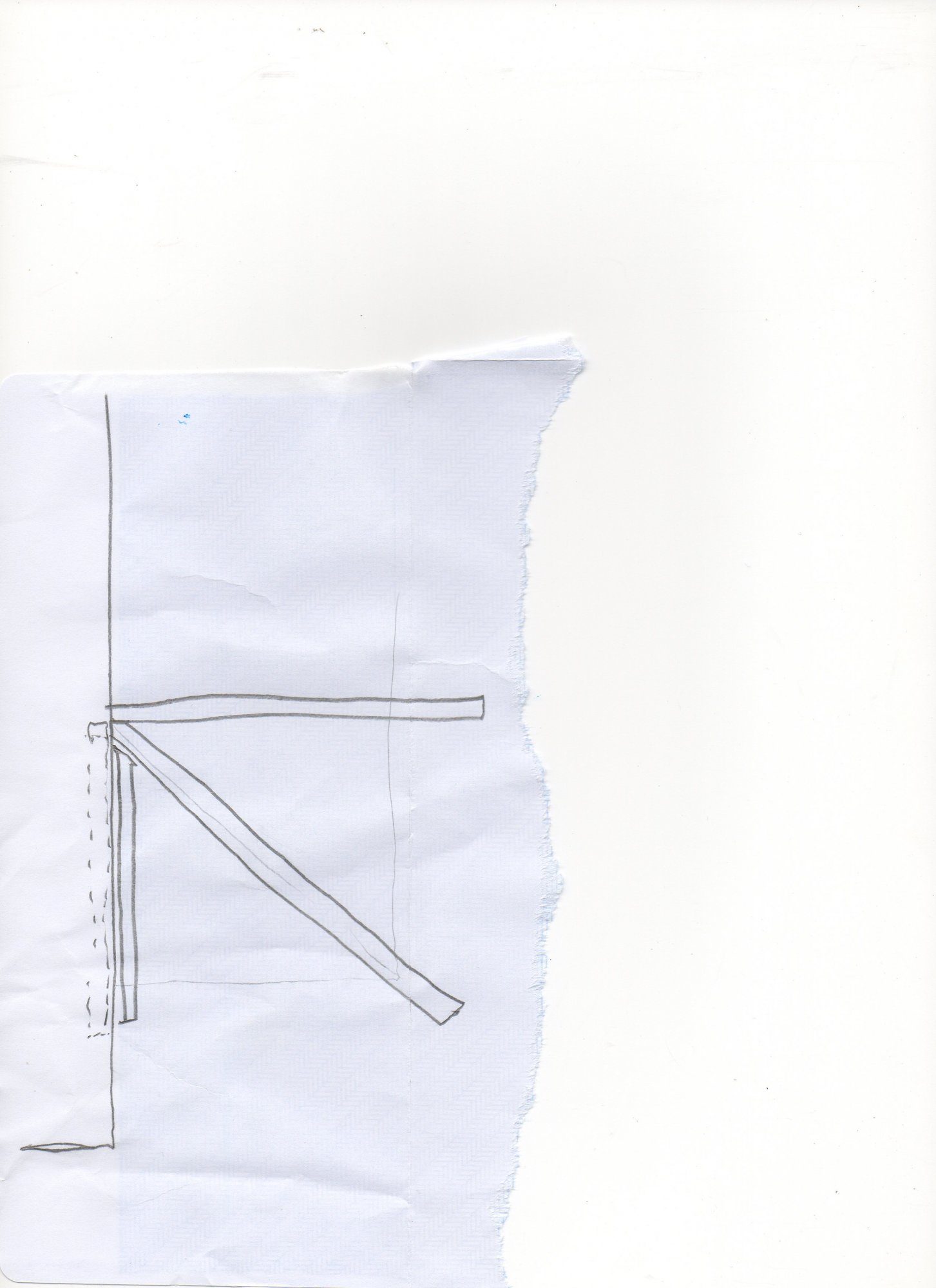

The hip rafter would sit in the crook created by the last two full (90 degree opposite elevation) commons.
However, on a lean-to you will have the last full common and the wall at 90 degrees to this common. The hip sits in the crook created by the last full common and the wall.
You can use your common pattern rafter on the opposite elevation (i.e. the elevation that is abutting the house wall) to determine the 'going' of the hip. Just drop the birdsmouth into the wall plate and lower into position until the plumb cut reads plumb on the level or when the peak of the plumb cut is level with his mates on the opposite elevation.
In the image below it shows where the position of the first full common (in green), on the return elevation, would be sitting should this be a regular hip roof and not a lean-to.

That's brilliant noseall, thank you for the drawing!

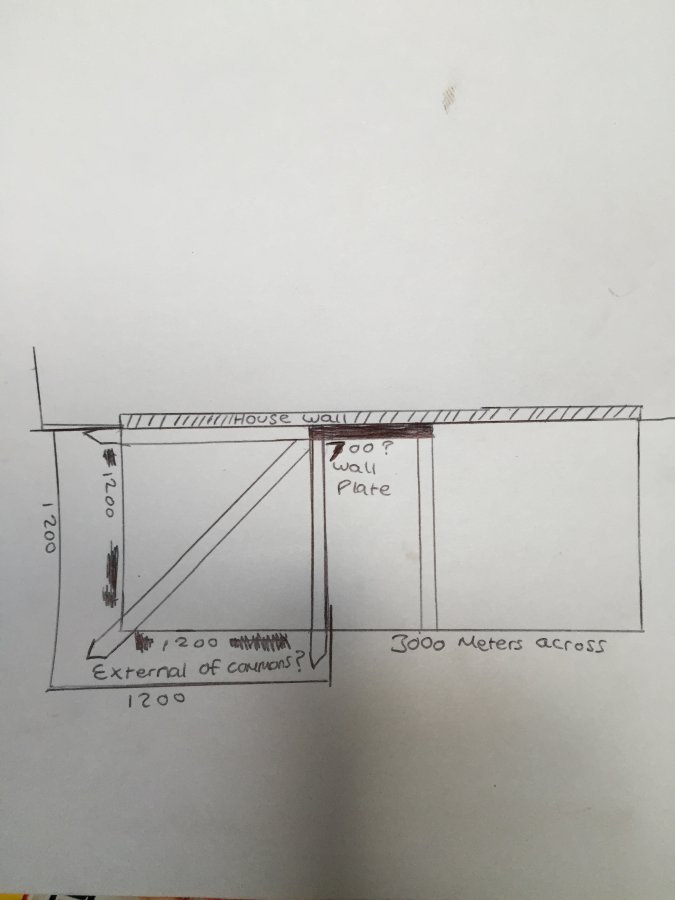

How does this look noseall, have I done this right..

No.
The hip must travel all the way to the wall.
The wall itself is serving as the edge of what would be the position of the opposing rafter, so the hip must be central to this. As in my drawing.
The rafter that you are showing abutting the house wall will effectively be a jack rafter with a compound cut on it. This will abut the hip.
Would I still need that green common rafter against the wall?
The green rafter is just superimposed. It shows you the position of what would be the opposing elevation common, if you were building a standard hip roof. The dotted line in the second drawing is also the superimposed position of what would be the opposing full common.
Instead of a rafter, you have the house wall. The hip must bisect this junction to be in true plane.
What you will fit against the wall and up to the hip is a jack rafter with a compound cut on the end.
Yes!! Gotcha now, it makes sense now you say that, have to keep it 90 degrees.

If it is a lean-to hip (and I'm reading the job right), then there will be no ridge. Given the dimensions of a 1.2m out, 3m across and 1.2m return, you will end up with a pair of 1.2m hip ends with a 600mm flat bit between.

That 600mm wall plate in-between will only take 1 common because the other 2 commons will be on the wall? That's right isint it.
Have I read your job right with my first ..er.."drawing"? If so, you will end up with a pair of commons each at the point where the hip meets the wall. Span tolerances may also mean a third, i.e. one in the middle.
The link to an earlier post I sent you above, should be helpful. The images show the pitching plate (pole plate) at the rafter ends (where a ridge board would nornally be) and not beneath the rafter. This moves the plane of the roof forwards by 50mm. This changes the design of his roof slightly in that the hip rafter now butts up to the crook created by the two opposing end commons.
I prefer to have the pitching plate beneath the rafters so that the rafter ends are touching the wall. It also helps where roof height and upstairs window sills etc are prohibitive.

What I meant is, if I decided to have a pole plate under the commons will it sit under the commons only and not the hip? Because the hip goes straight to the wall.
So basically I'll have my pole plate under 3 commons
