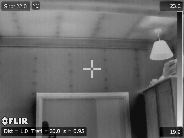

Thermal imaging !
This is my spare room. You can see where the plaster boards have been nailed to the wooden batterns

Fortunately, joists tend to be at 400, 450, or 600mm centres
An excellent tip, courtesy of the ultimate handyman site, is to use a neodymium magnet to find the nails. This seems to work better than a proper stud detector

You have your IR camera in your tool box ! They can be very expensive toys. Wouldnt catch mine rolling around in a toolbox :D
