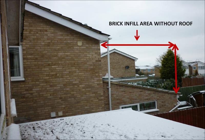

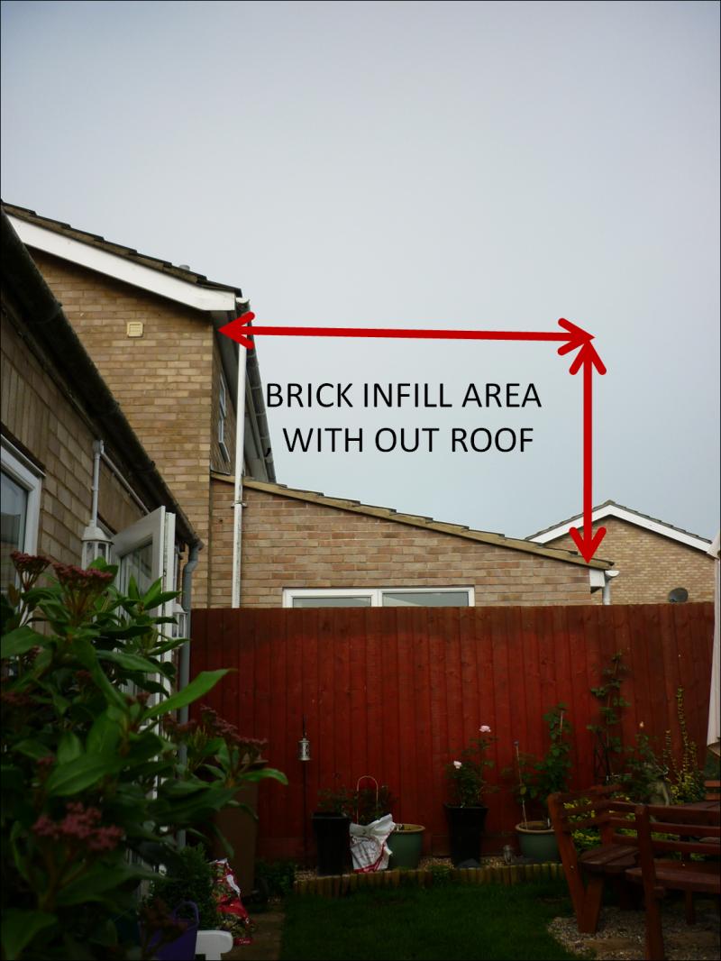

Thanks guys, question answered, I was just clutching at straws as this extension (berlin wall) will be a pain in the rear for us. Never mind I will have to get used to it and I can always by a nice climbing rose to hide most of it. Again thanks View media item 32358
I can now see that your real beef is over the extension. I assume you objected when the site notice went up? It’s very common for extensions or any sort of building works to be greeted with strong neighbour objections but the fact is that 90% of them are based on “I don’t like it” mentality & are not valid in terms of planning law & permissible development.
Is the 2 story bit new or were the original properties build staggered? That alone would be enough for me & the single story extension goes back a lot further. got to admit I wouldn’t like to look at it so you have my sympathy; it’s the main reason why only my first ever property was not detached. I now have ½ acre & space on all other sides with only one detached neighbour & a farm on the other side. But would you believe a couple of nearby neighbours in the same road (one cant even see me) objected to the PA I submitted to drag a 60’s property into the modern ages but it was all based on emotion & change aversion so didn't make one iota of difference & it sailed through. On the positive note you could always build out to match; your neighbours precedent will almost certainly mean it will sail through. Or sell up & move on. :wink:
The original buildings werer staggered, the ground floor extension with the scaffold round it was built in 2000, before we moved in. I did all the right things, I had the support of my local parish council and local district councillor. I hired an independant planning advisor. Not all neighbours at the rear of the property were notified.
Two side extensions in our street were used as examples and photos used to aid the planning application without those neighbours permission. Both neighbours disagreed with the case officers views.
The planning notice was moved to the neighbouring property.
The house next door was used as an example, saying that they had an extension so both plains that were crossed did'nt count - but it was not an extenstion but a conseratory.
The applicant stated it was for his wifes businness, but at the next meeting the old plan was replaced with one not showing layout of a large bedroom and bathroom.
Site visit was canceled first time and we were the only ones not notifyed. All these things were brought to the attention of the planning office and it still got passed.
One day I'll win the lottery and buy a lovely old farmhouse - with a moat!
so if you know of any going cheap let me know. many thanks for your replay
p.s richard
Two more images that were used at the meeting. The case officer also quoted the bre report many times but she did'nt actually do a sun ananlsis report even though we asked for one.
