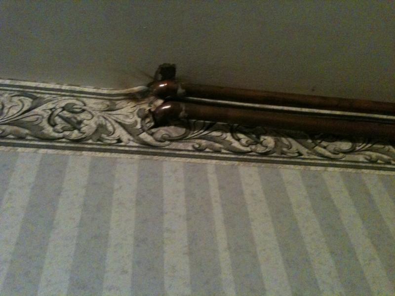

I am concerned that a little old lady who lives near me may be getting ripped off. I do not know much about plumbing or central heating systems, hence would appreciate any advice anyone could give me.
She recently had an electric central heating system installed by a “Handyman” type guy who seems to have taken to trying to befriend her, having cups of tea with her whilst trying to find new jobs to do in her home.

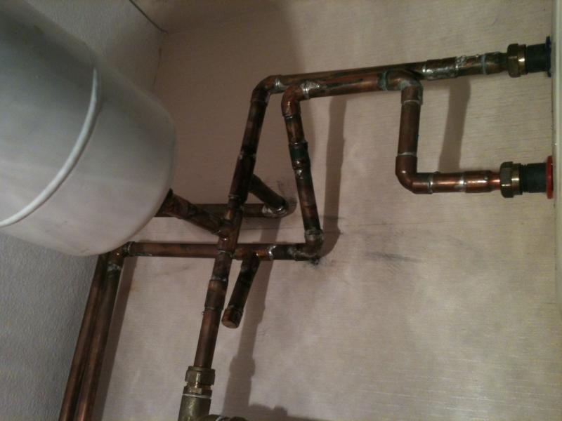

He installed this system. The pipes are not hidden instead are in the corner of he kitchen which looks terrible. There appears to burn marks on the wall behind the pipes. It all looks quite messy.
I have taken some pictures of the pipe work and heating bit. I do not believe the bloke is a qualified electrician / plumber. She has paid for the work, but appears embarrassed when I talk about it with her. Unfortunately she lives alone so is quite vulnerable to people trying to take advantage or her.
I am slightly worried that 1) she has been ripped off and 2) it may be dangerous 3) should I speak to trading standards 4) what qualifications do you need and what happens if he hasn’t got them?

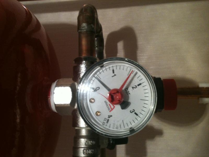

The pressure was reading at 1500 but is now at 500. Is this bad?

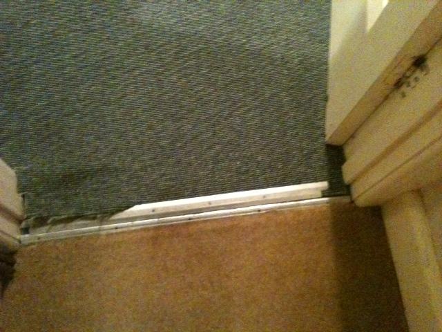

He has also “laid” some new carpet for her. This has just been placed on top the old carpet, isn’t stuck down and doesn’t fit. I have included the pictures as the quality of this work also leads me to believe he is not a good tradesperson. Even with my limited knowledge of diy this is not good.

Pipes - very untidy, also looks like some were put in and then changed/moved for some reason.
If the pressure is dropping, there is a leak somewhere.
Is there a pressure relief valve anywhere? If not, system is dangerous and must not be used.
Presumably there is no HW cylinder, as the square white box with the black oval on the front is a water heater designed for undersink use - one or two outlets maximum. Is there a bath in the property? What about a shower?

Carpet over the top of old carpet - wrong, and likely will result in someone tripping over it, and doors won't open/close properly either. Can't see any reason to do it either - removing old carpet wouldn't have taken long.

Yeah the carpet looks terrible and I thought it was just laziness to have to get rid of it.

Blimey what a mess... Whoever did that should have paid the customer, not the other way round !!! I wonder why there appears to be two expansion vessels. The guy obviously has not heard of a pipe bender either.
One expansion vessel (white) for the under-sink heater and the red one for the radiator(s) circuit (would quite like to see how he's installed these)

I also took a picture of the pressure gauge as this appears to have dropped again since yesterday when I took the last pictures.
