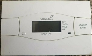

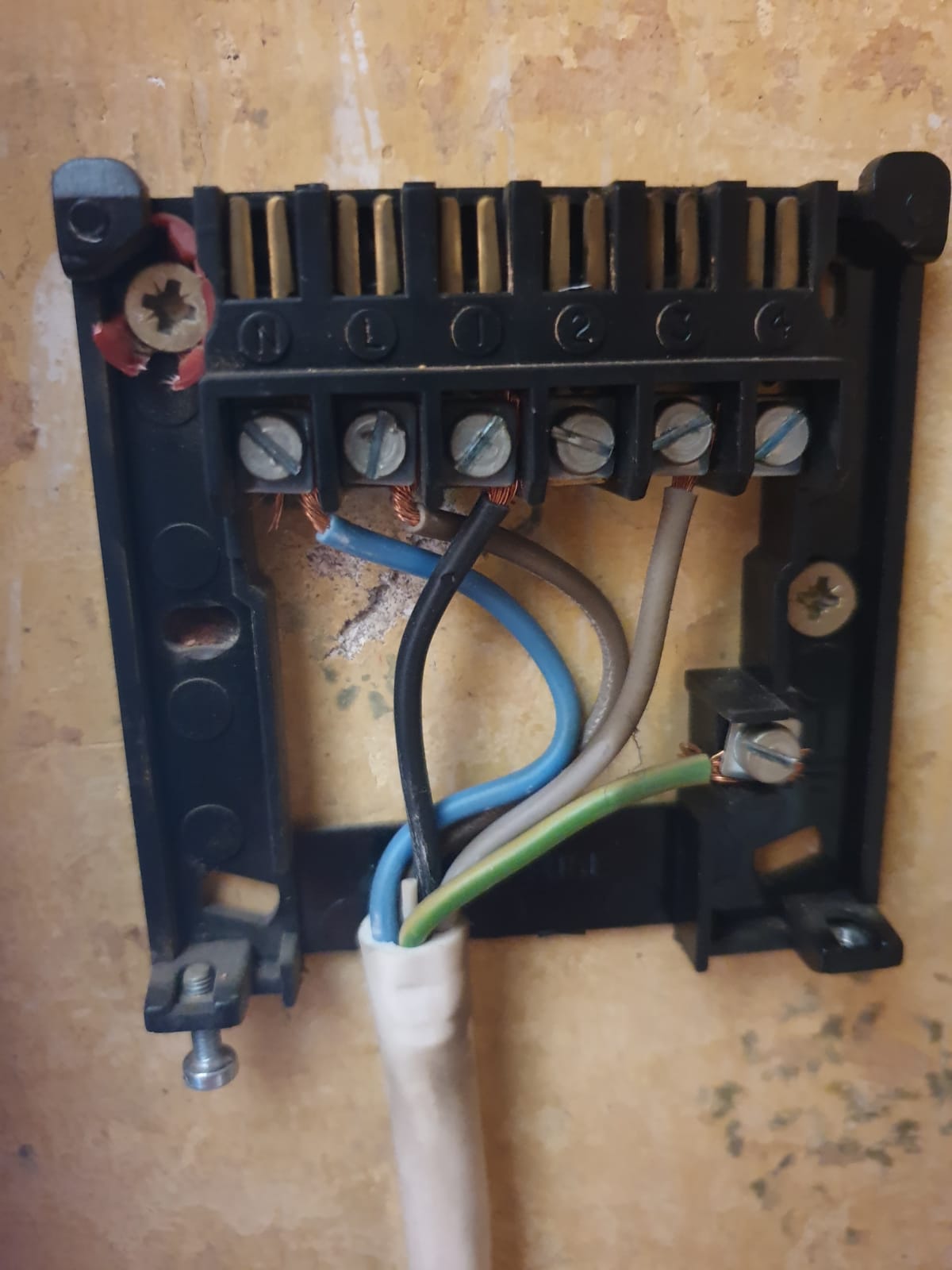

I have a nest thermostat E that I want to install in a house without a pre-existing thermostat. It has a British Gas UT2 programmer connected to the boiler.
Is it possible for me to replace the programmer with the heat link or will I need to install the heat link separately?
Could anyone give me/direct me to information on how to do this? If you need more information from me please let me know.
The heat link has has the following wire inputs: C / NO / FP / OT1 / OT2
In your post title you say 'UP2 Programmer' but in the text you say 'UT2'. Looking at your photo of the wires, I assume it is actually a UT2 single channel programmer as below [the UP2 is a dual channel product]
In which case the 230V supply L and N are not required by Nest-e (because it's battery operated) so the blue and brown wires should be isolated / insulated safely. I usually put them in separate screw connectors and tuck them out of the way. Do not connect them to the Nest-e.
The black wire now in terminal 1 goes to UK Nest-e 'C'
The grey wire now in terminal 3 goes to UK Nest-e 'NO'

Great. thanks for your help, much appreciated. What about the earth wire? not sure if there is an earth input on the Nest E
