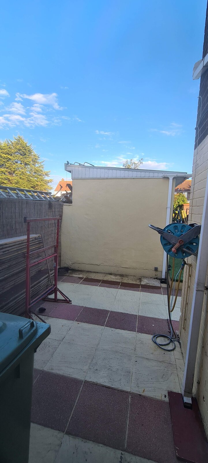

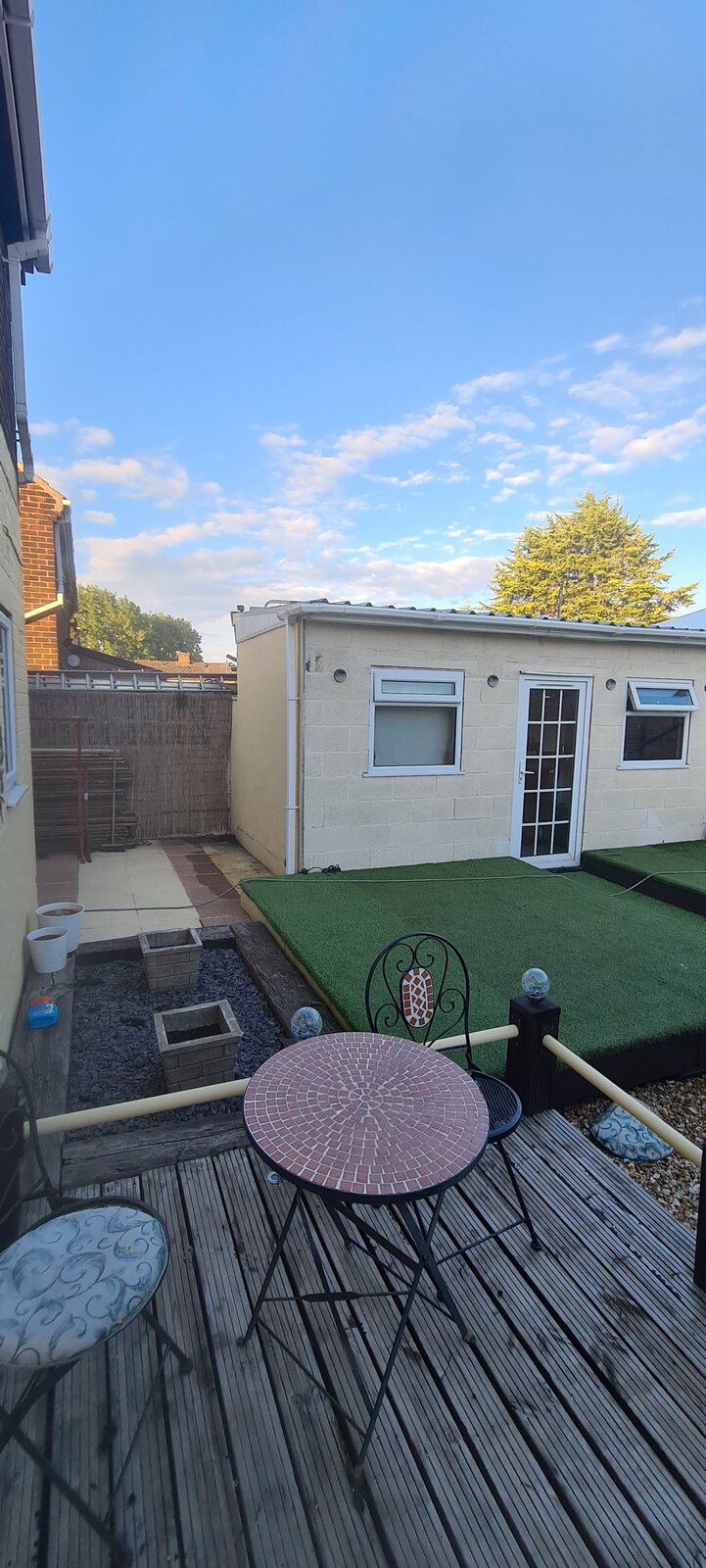

I have been advised an enforcement officer wants to "clarify" the situation with a visit regarding the building erected in my back garden.
Brief background. I had a garage in the back garden when I bought my house in 1997 (timber frame & asbestos sides and roof) this was taken down circa 2007 due to it deteriorating and in 2017 I rebuilt it using single skin concrete blocks.
I'm not sure as to why they want to visit(other than a sticky beak neighbour) but I was looking for any help if anyone had had a similar experience. It is on the existing concrete base and is more 2 metres from my house. Any ideas please?
Do you have any evidence as to when you built it? As after 4 years it would be immune from any local authority enforcement.
Might be a bit high to be PD and that setback at top of fence line looks very ugly. But as said above, if it's been in plain view for more than 4 years council cannot commence any enforcement action so don't worry about it.
If you wanted to (and have the dated evidence to satisfy the 'substantially completed' bit) you could apply for a Certificate of Lawful Development - costs a bit but will shut the (presumed) neighbour complaint down completely.

you say you used to have a garage.
you haven't got a garage now, you've got what appears to be a habitable building, perhaps an office or a guest annexe.
I'm not surprised if it needs planning permission.
