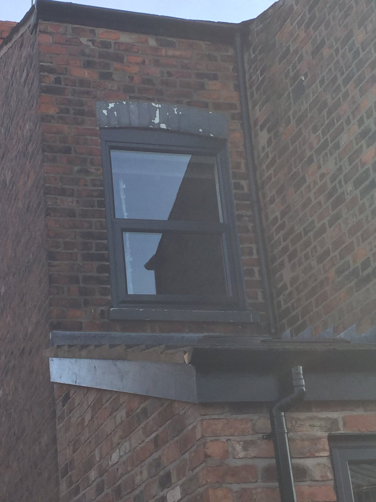

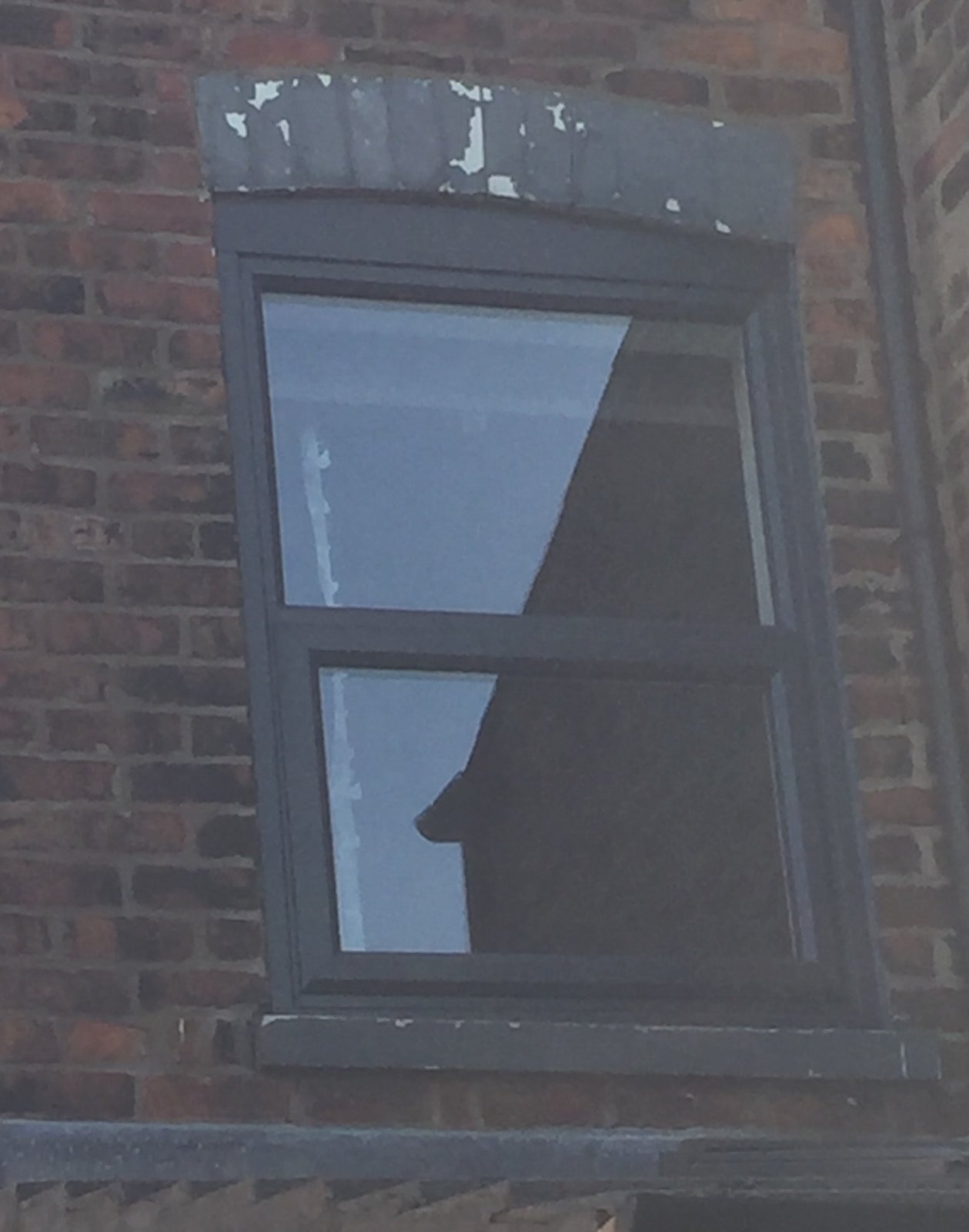

We had some work carried out July last year for a single storey extension and bathroom renovation. We had lots of problems with the builders including a bad bathroom install, which we have had to get re-done by another contractor (going through Citizens Advice and ADR on this for our money back).
We now have a fear that our extension to our untrained eyes, maybe not as good as we hoped. When they removed walls and put in beams, we had ALOT of crack appear upstairs including the window above no longer closing. They told us this was normal and adjusted the supports. In hindsight, alarm bells should have be ringing and we should have got external advice at that time. But I had just given birth to our first baby, so life was a little whirlwind!
In the last few months we have noticed further cracks appearing on the house.

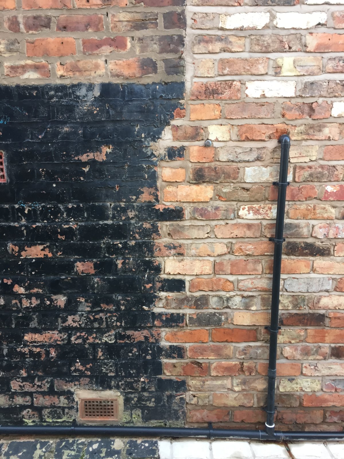

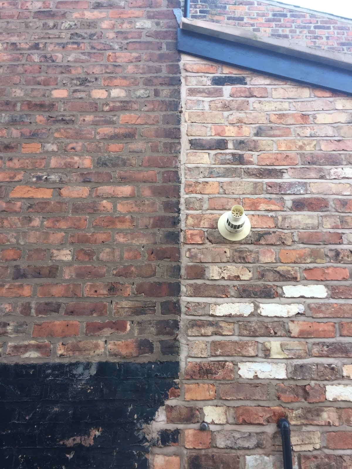

1. External where the new extension meets house

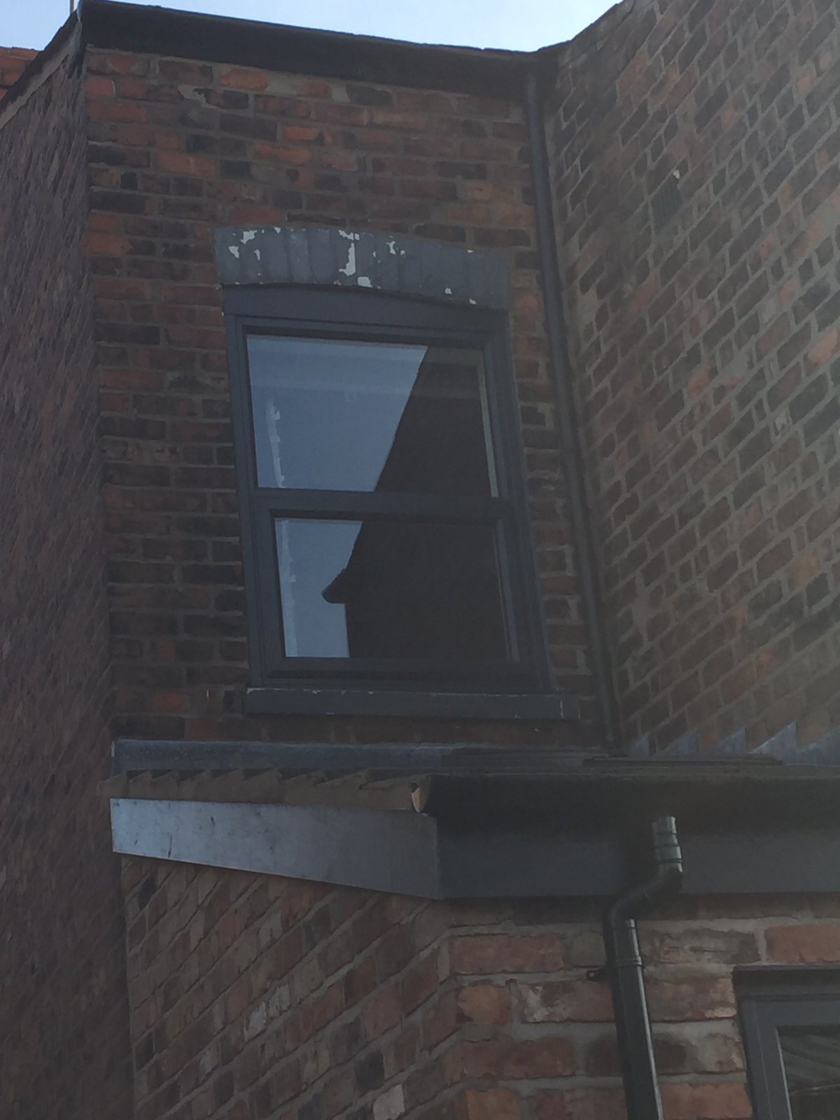

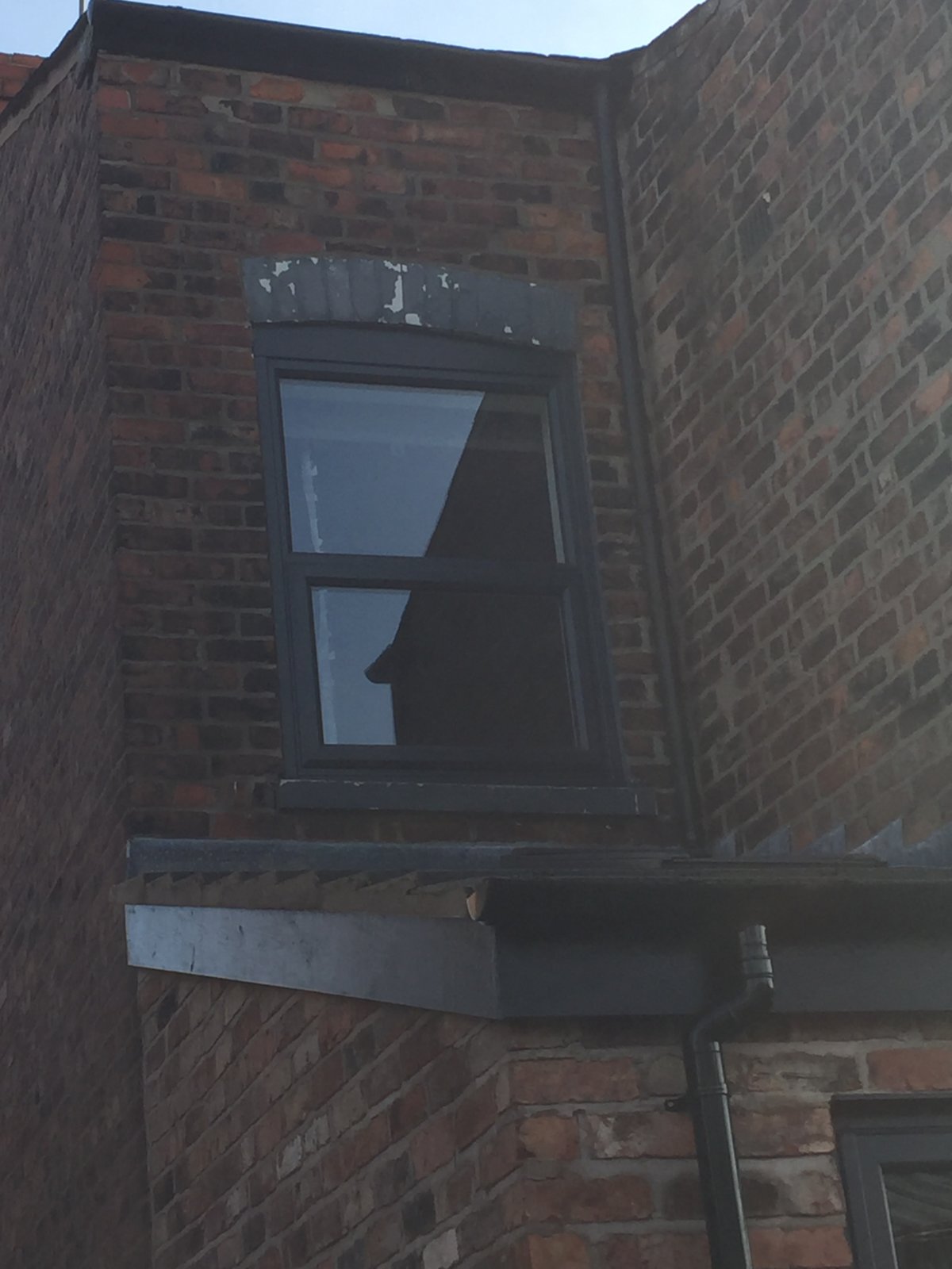

2. Above window which had major cracks during build and window didn't close. Left below window from ledge (if you can zoom to see!)

I'm impressed as to how well the bricklayer matched the new pointing to the old :)

The crack where new meets old is not serious - probably no more than initial shrinkage of the hard cement mortar.
If the window is only a few courses above the steel, the brickwork probably dropped a bit at the time of the work.
The new to old brickwork is nothing to be concerned about.
Out of level is not an indicator of subsidence, on its own. Old house are often out of level. Badly build new houses, the same!
None of the cracking is normal. Probably best to get an independent structural survey and add the costs and the cost of any remedial work to your ADR claim.
