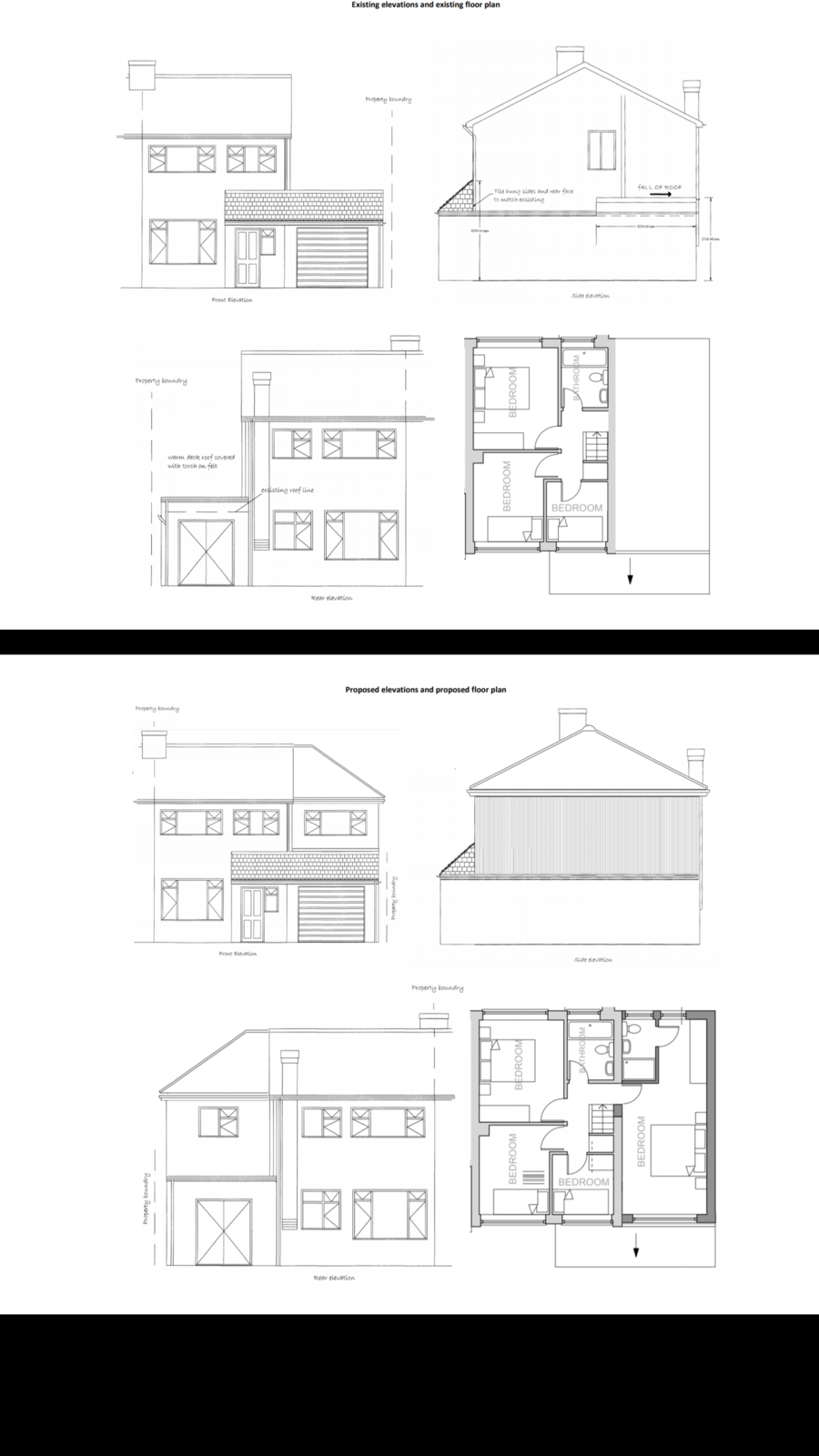

We had a meeting with the council today about extending our 3 bed semi detached. Basically adding a bedroom and ensuite onto the existing garage and kitchen that are positioned on the side of the property.
The reason for the pre application was because we need to be able to build to the boundary on the side to have enough space. The planning officer was confident if we stepped the front in or used a catslide roof with dormer we would avoid the terracing problem.
We are meeting with an architect next week but wanted to know what people thought of the catslide roof idea. With the catslide we could probably build nearer to the front of the house with possibly stepping in 1.5m.
My concern is where you lose headroom , is it just at the front by the dormer?
I have attached the original plans I did for the preapp.
Thanks everyone.

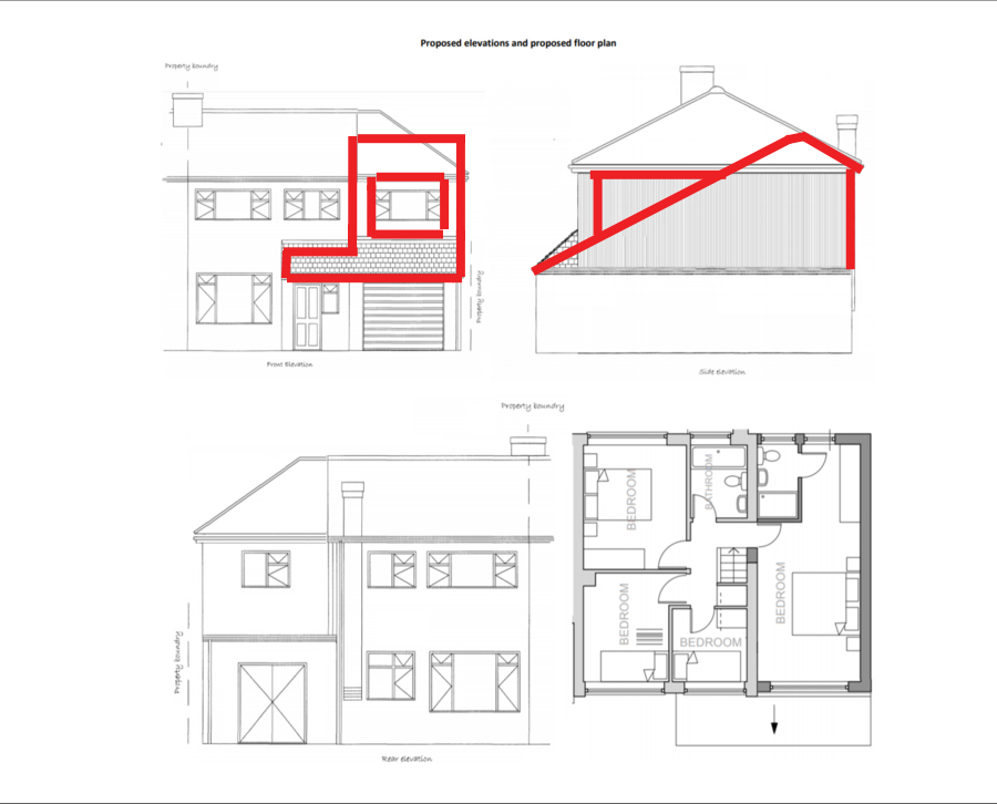

I still don't understand the reason for the pre-application. Anyway, isn't the council simply suggesting something like this...?

The reason for the pre application was because the council have historically made people come in from the side boundary by 1m to avoid terracing.
I didn't want to pay out for an architect to do full plans for them only to be rejected. I wanted to gauge the view of the planning officer as having to come in 1m from the side would mean the project was a non starter.

Surely they just want you the set the front elevation of the first floor back slightly, usually 1 metre. That will give you more useable floor space than the catslide roof.
I'd go for the setback. It allows for a larger loft conversion at a later date.

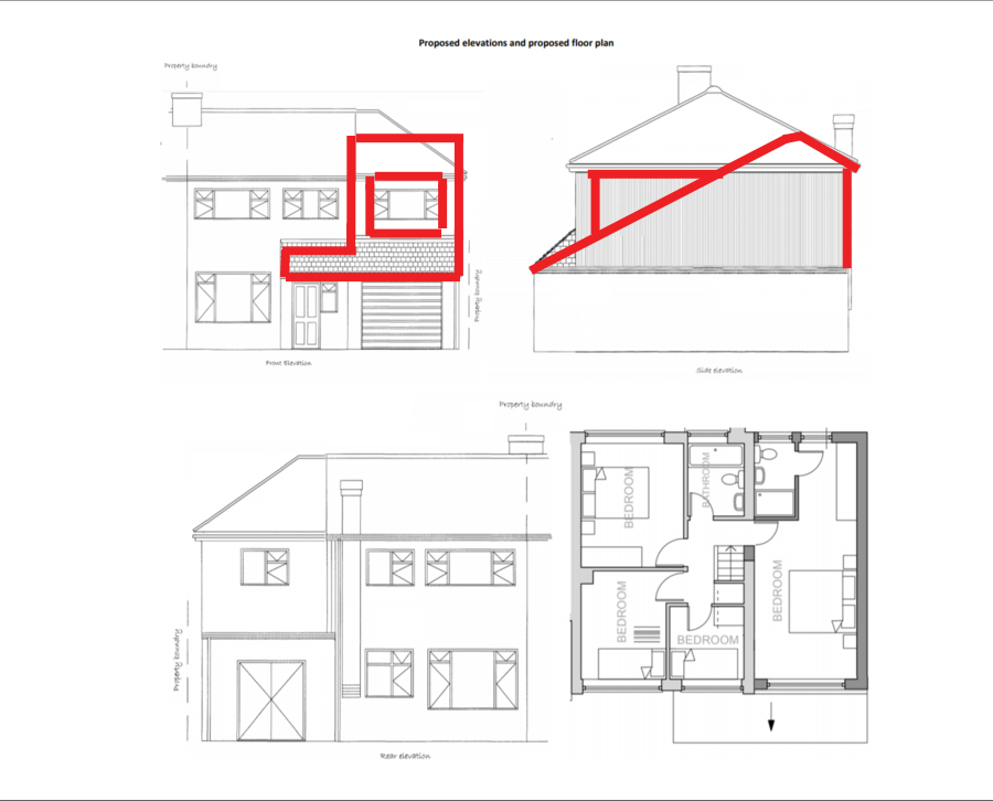

WTF? Do you design for Hobbits?
The eaves of the extension should start at the height of the front canopy roof (ie just below bedroom window cill level), and could be in line with the front house elevation (ie no set back)
