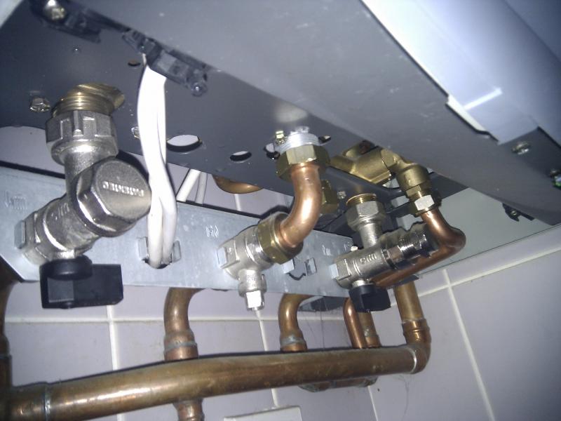

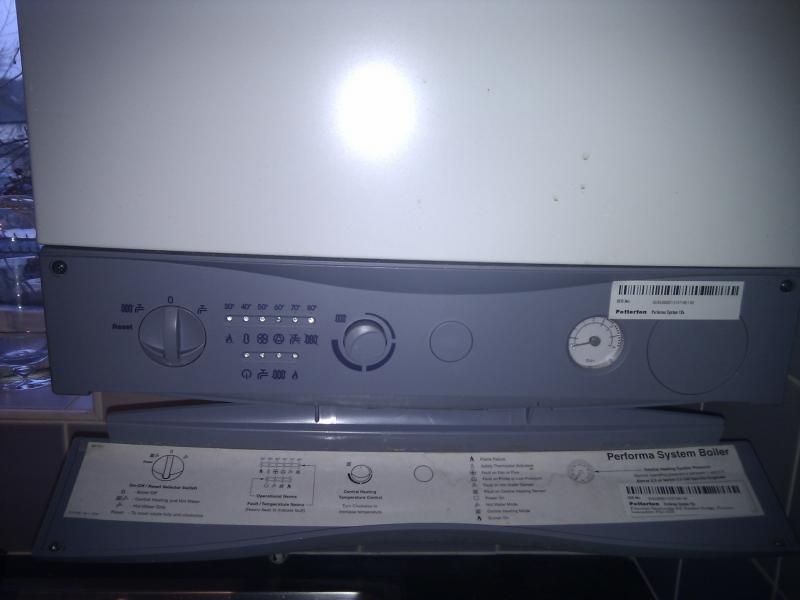

We have the Potterton Performa 18e boiler which is in the kitchen. Over the past week it has been making a loud moaning noise and there is now no hot water and the radiators are only mildly warm.
I noticed when i opened the front fascia that the pressure gauge reads zero. After reading around on this forum i thought it might need re-pressurising with a filler loop. There was no filler loop on the boiler so i purchased one.
I thought this would need attaching between the two outer pipes beneath the boiler (see pic). However, when i turned the two black taps to the off position (see pic) and undid the cap on the left hand pipe, water started pouring out and did not stop.

Very confusing mentioning the small tank in the loft, suggesting an open vented system. Those boilers are for sealed systems only.
Look for a fill loop (poss in the airing cupboard) and refill the system. Turn those valves back on again and tighten those nuts. View media item 35799

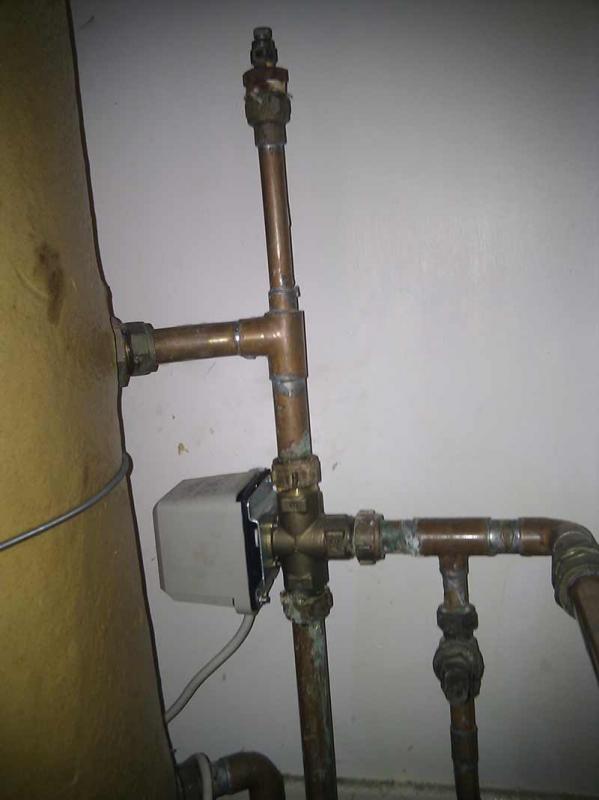

Thanks for the reply Pete. I looked in the airing cupboard but could not see a filler loop. I only saw what was in the pic below.
It is possible that your boiler is fitted to a vented system, although it should definately not be. Have a good look around for the fill loop, it may be hidden in a cupboard near the boiler, maybe.

but is it connected to the system pipework. If the answer is yes, then I'm afraid it's wrong. As I said before, these boilers are for sealed systems only, and you need to get someone in.
