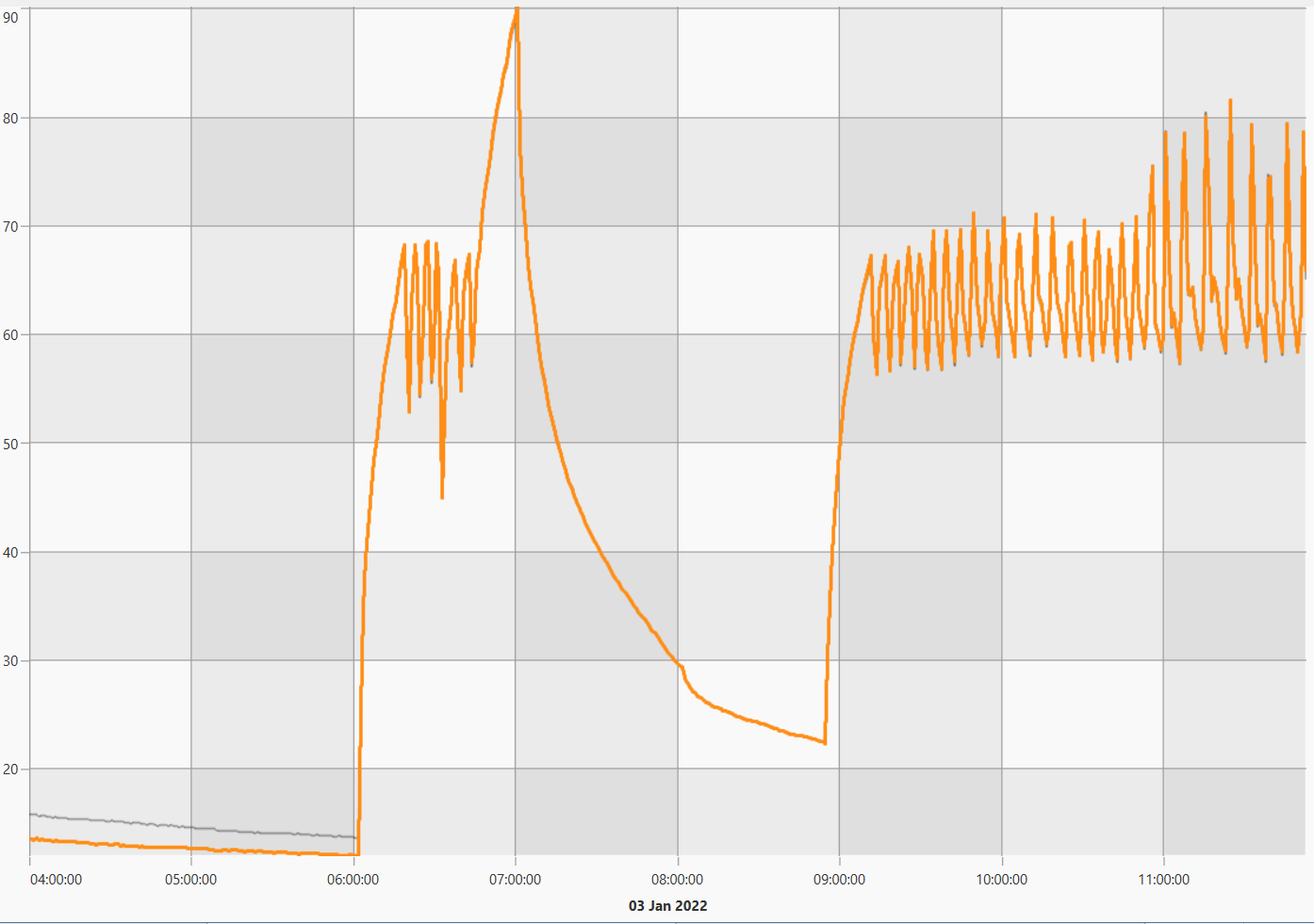

Hope someone can shed some light on this...
Potterton 100e - motorised valves to hot water tank and to heating.
Over-temperature cutout trips about the same time every few days, more often if I turn the temperature on the boiler up (set about 3 now).
This has been bugging me for a while so I have temperature loggers in various places on the pipes - thermocouples on: flow; after valve to heating; after valve to tank
Heating is programmed to come on followed by the water 30 minutes later.
I can see the flow temperature cycling up and down every ~5 minutes, when the hot water program starts the boiler cycles twice then on the third time it doesn't turn off, just keeps getting hotter until it trips out with the flow temp around 92C.
After I reset the boiler it will work fine for a days or so, then do the same thing again.
It seems clear from the temperature readings that both heating and water valves are open, the issue seems related to the boiler control but seems a very specific circumstance.
Controller seems the obvious choice but possibly a sticking "gas valve"? Or the boiler temperature sensor sticking?
