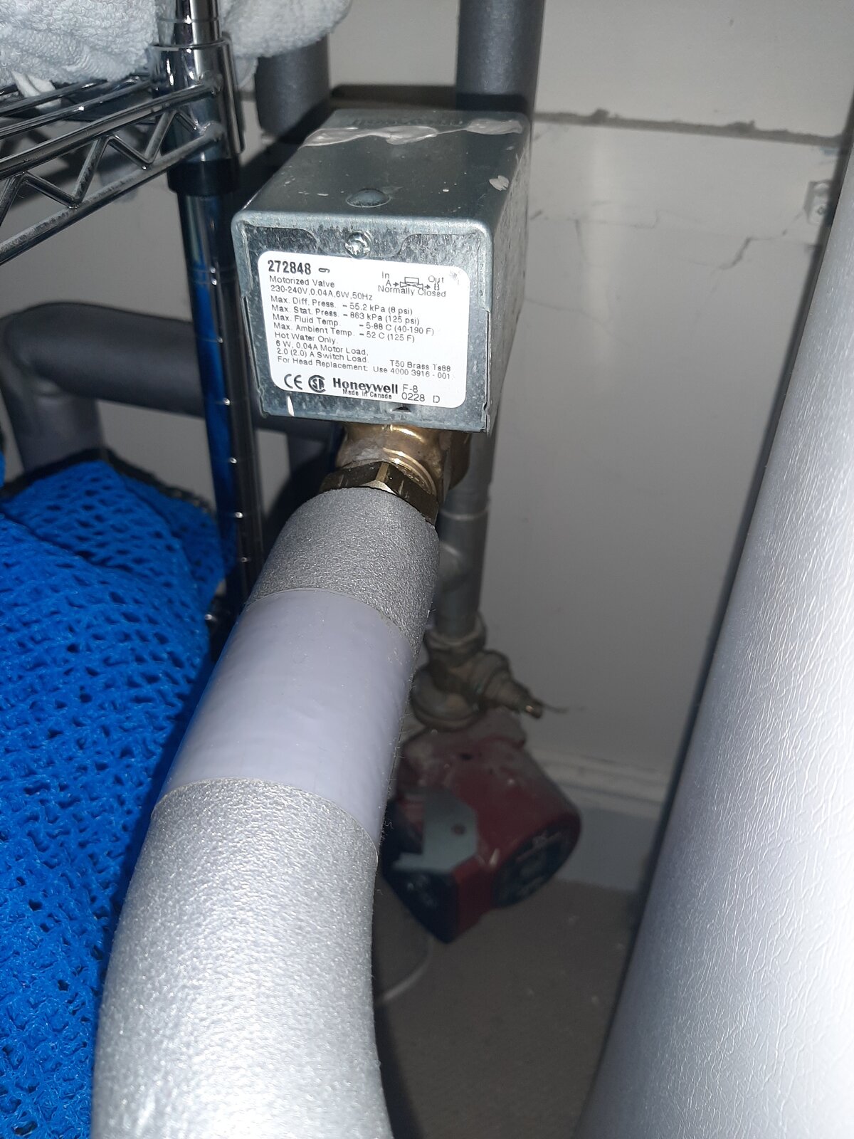

Attached is a picture of the motorised valve, pump and large cylinder to the right.

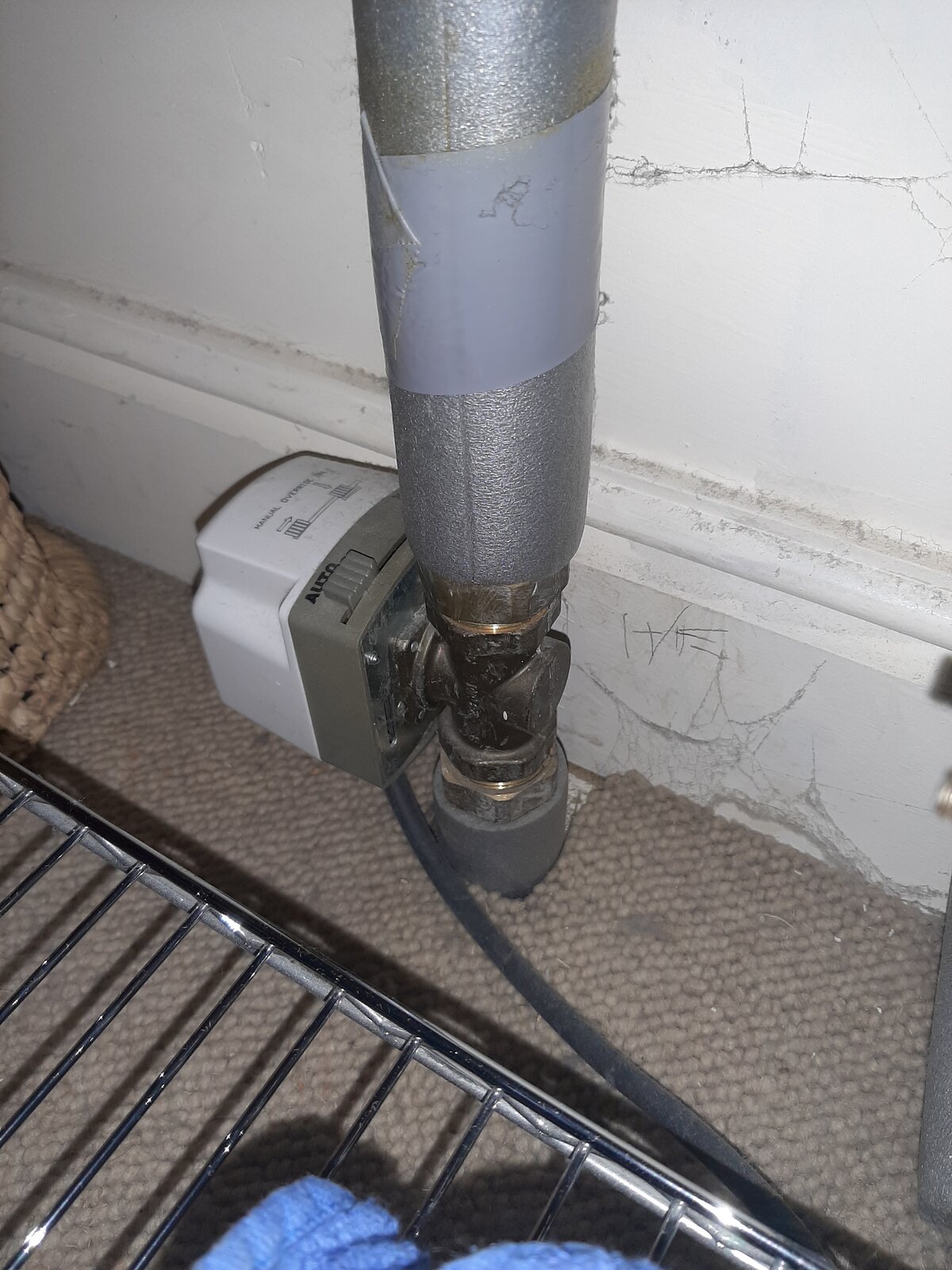

That's the only valve I can find, although I would be interested to know what the attached image is showing linked to the pump. It's been hidden from my view for 13 years!

Thats the other valve, so your system is designed for independent supply of heating and hot water.
Now to determine the fault with the Honeywell valve- this needs a multimeter.
First thing to determine is if any power is getting to the valve motor. The black flex from the Honeywell valve should go to a junction box or wiring centre fairly near it (the flex is only 500mm or so long). With hot water demand active (programmer calling for hot water, cylinder cold) there should be 240 volts across the brown and blue wires. Orange and grey should each be at 240v relative to neutral.
WARNING Testing live electrical circuits is dangerous. If you're not confident and competent using a multimeter and working with 240 volts then either get someone in or swap the valve motor, microswitch etc (you'd do that dead & its the most likely fail). Second most likely is the programmer, third most likely is the cylinder stat.
