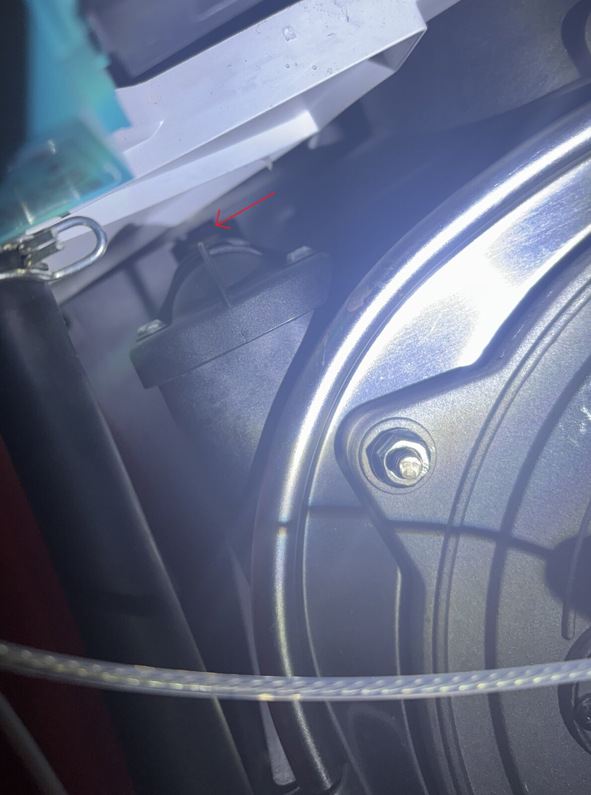

My Potterton Promax 28 HE Plus boiler started leaking and pressure dropping recently. I stupidly did an online repair with a certain well known company (BG), engineer came out and noticed water pooling on the metal shelf that sits the exapnsion vessel and a big metal thing with black gaskets he said the hose was split he replaced this and went away. The boiler was still leaking. 2nd engineer came out said I suspect your expansion vessel is burst, he replaced this as the EV was full of water, but could not see a leak, boiler was still leaking. 3rd engineer came out "oh the new hose that was fitted was fitted the wrong way"!!!!, boiler was still leaking, 4th engineer came out oh I dont see a leak, your pressure is not dropping so I would not worry about a leak!!!, i said but its a sealed system. Boiler was still leaking and pressure started dipping again.
I turned off the boiler and electric cooker switch next to it and opened the front cover, all I did was have a look nothing more, water was pooling at the top shelf where the expansion vessel sits and noticed water leaking from the top black gasket with a metal clip (see images), water appears to be coming out the little space that the metal clip inserts into. I left the boiler switched off and drained it down. thankfully have an electric shower and use the kettle for hot water for dishes.. I dont understand how a BG engineer never noticed this, but I noticed it within 10 seconds of looking around it.
If this an expensive job to get replaced/repaired, the boiler is 10 years old. When the boiler was running the radiators would produce amazing heat and the hot water is excellent.

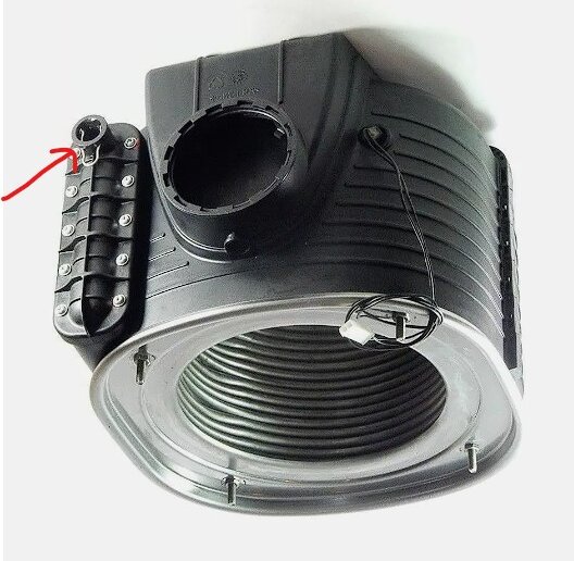

It looks like the main heat exchanger (not usually cheap to replace). Perhaps contact Baxi (they own Potterton) for a fixed price repair?
