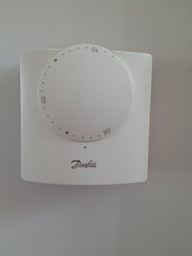

your heating thermostat and timer controls, are any of them wireless? picture of them if possible?
Hi thank you just done that and boiler fired up quickly and now reheating the storage but central heating still won't kick in

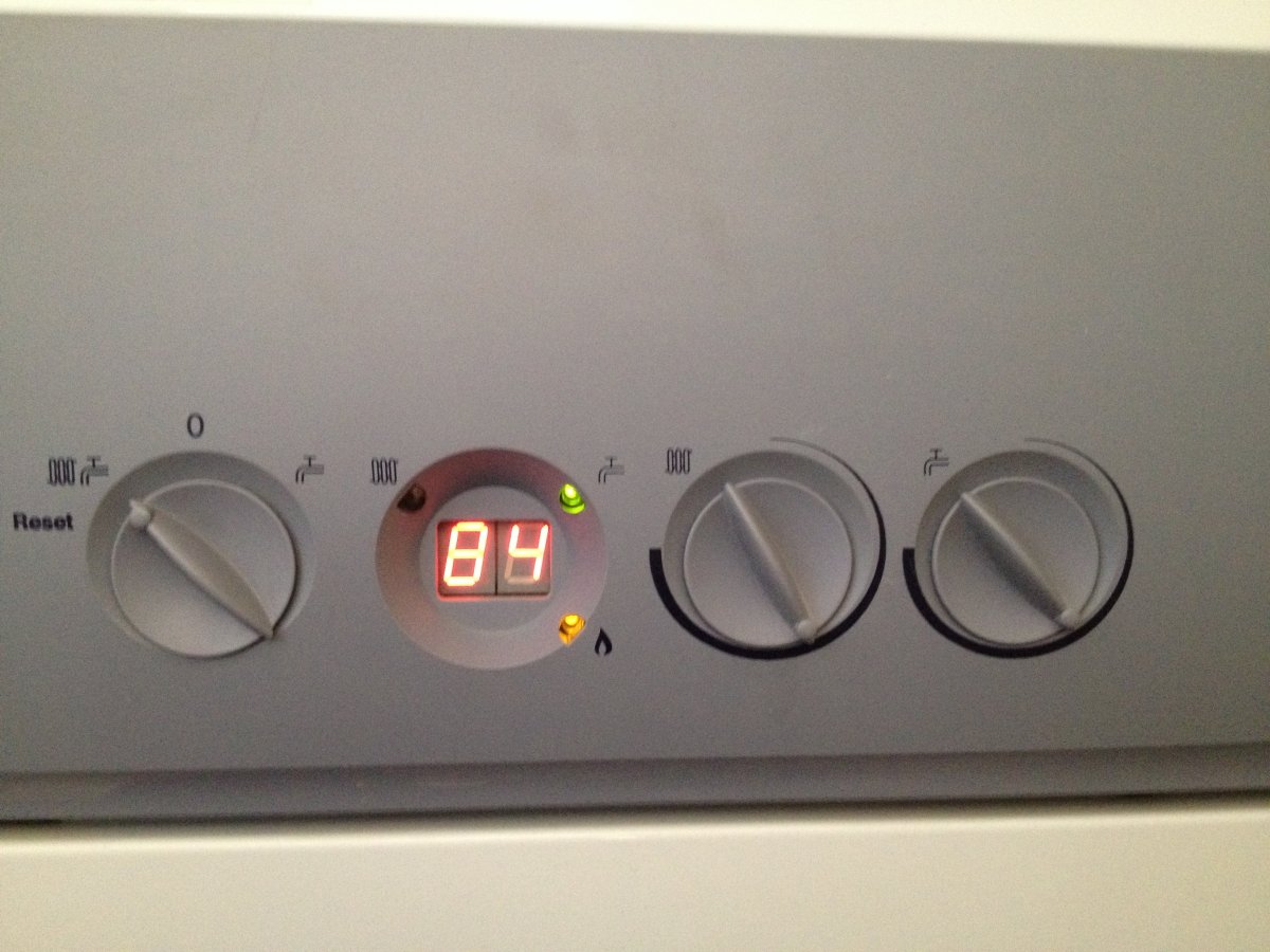

Photos of thermostats, and boiler controls ( first time we've seen the pilot light lit for 48 hours)

The picture you have of the front of the boiler with the "pilot" light and the tap light on, when you have the heating set on and thermostat up, is the radiator light lighting up?
Hi sorry for late reply , no the radiator light is not lighting up and once the water 'store' had heated up everything went off again
Hard to say but sounds like possibly a wiring fault with the controls.
The moment you turn heating on the radiator light should come on, from there if there is a fault then the boiler would cause problems but the fact the rad light is not comming on is an indicator that it is not getting a signal to swtich on.
What you do now depends on how comfortable you are doing electrical work and if you have a multi meter to do checks, if not you'll need to get a heating eng out to look at it.
One last thing. Turn the hot water off at the clock and see if the heating comes on - doubt it will but worth a shot
Turned out to be a faulty thermostat, replaced today £125 lighter, thank you for all your help
