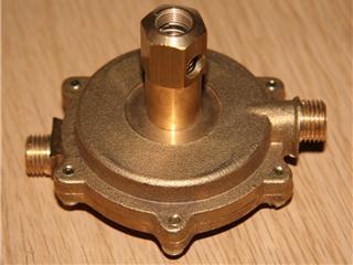

Potterton advised me that the replacement part is a 10/18676. One was found and ordered from Price Right Heating. This has been delivered and it looks like:

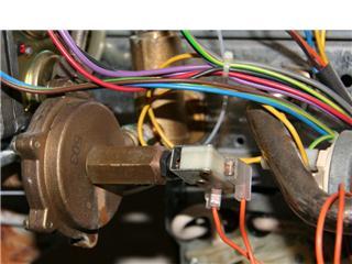

Unfortunately this differs from the in-situ flow switch:
They are both the same size and shape however the existing one has inlet/outlet connections at 1 o'clock and 3 o'clock and the new one has them at 3 o'clock and 9 o'clock.
I called Price Right and they weren't much help, initially suggesting that as they'd sent the part I asked for, I must have got the part number wrong and that I check it. I did that and the part number is correct. As they are unable to assist further I was going to return it to them and try somewhere else, however before I do that I wondered if the orientation of the connections to the flow switch can be changed by removing the six screws that hold it together and rotating half of it to meet the correct alignment and then replacing the screws.
