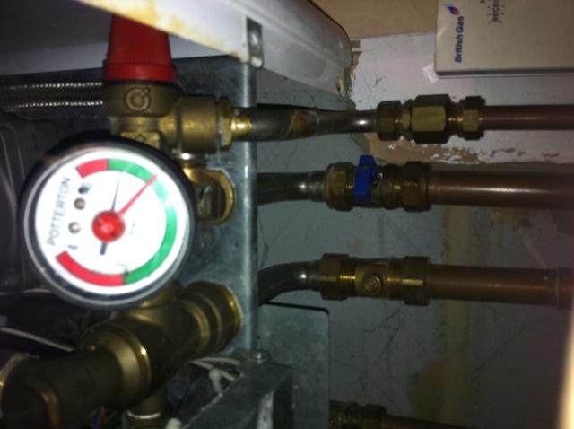

My PUMA 80E combi seems to be losing pressure (about 1 bar per 24hr). I have had a good look around boiler no obvious leaks but it needs topping up from the filling loop once a day to mantain the pressure. Any ideas what might be causing this?
All I can see might be a problem is the isolating valve on the filling loop under boiler, where the thumb valve attaches there is a slight and I mean very slight drip of water when the thumb valve is turned, I am going to replace this valve at weekend but would this be the cause of such dramatic pressure lose?
Could be the PRV which is leaking or the pressure vessel knackered which is causing the PRV to release water.
You will have a copper pipe on the outside wall, take a look and see if it losing any water.
