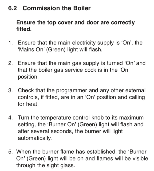

Potterton Suprima 60 HE Right side Led flashing green on startup but not igniting.
Any ideas?
Have cover but just interested.
Just the one light flashing? Any other lights on/flashing?
  • Thanks
Reactions: WSB
Just the one on the right hand side flashing.
Seems to be working OK now though.
Wondered whether or always does this and just haven't noticed
That’s normal operation

Great stuff, thanks
The reason for initial concern was because it sounded like it was trying to fire up
