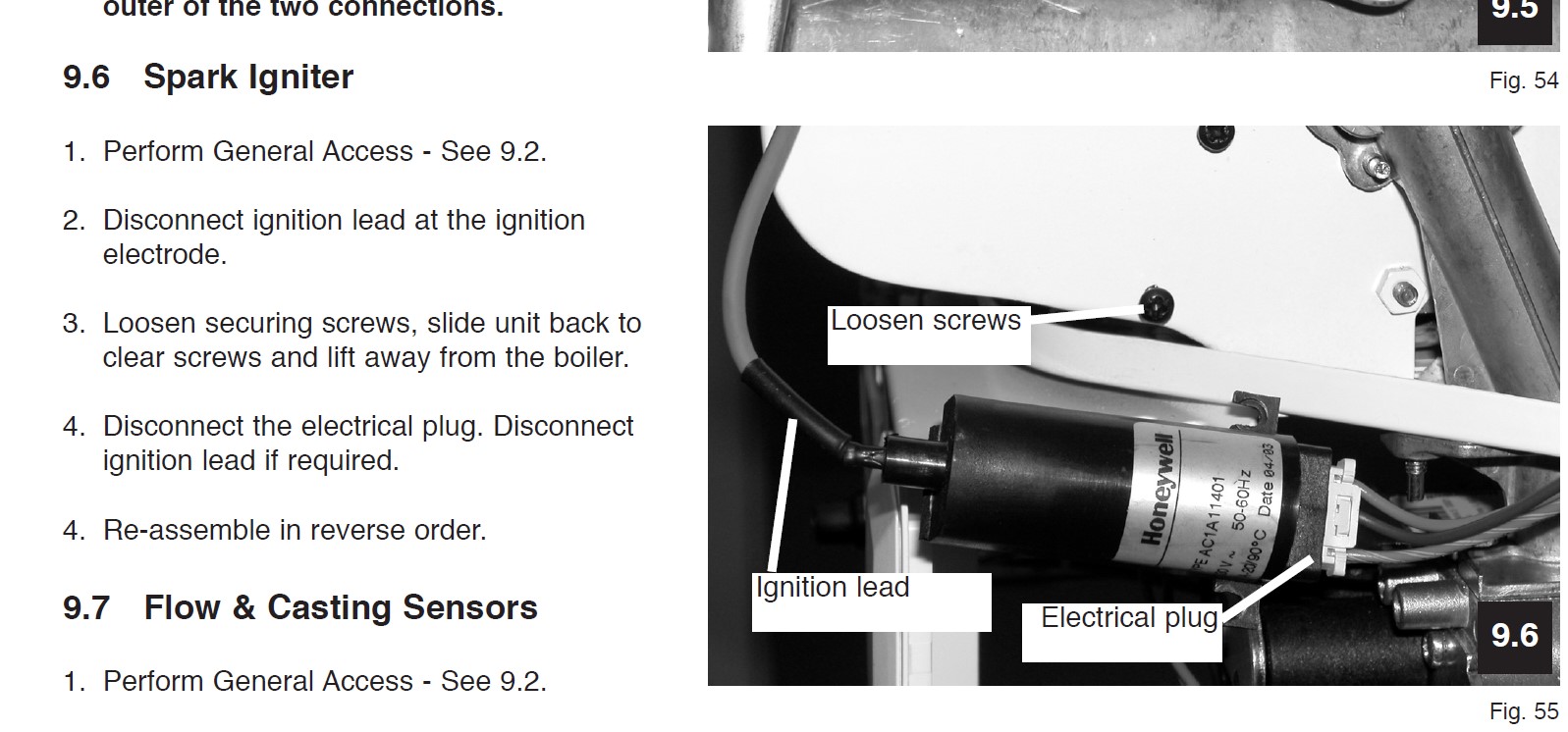

Hi - I have a Potterton 50 HE - Its been in since 2005 so i cannot complain in regards to reliability - although its starting to intermittently lock out - generally it was coming on in the morning with no issues, and only locking out in the afternoon when it came on....once locked out i would reset and it would fire second attemp every time.......although today it never fired in the morning.....reset and it fired. The fault light is indicating ignition error....any ideas? im thinking of replacing the spark ignitor and or the spark lead.....do you think it could be the PCB as well? any help would be appreciated - thanks
