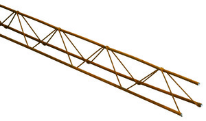

What makes you suggest that there is a ring beam around the top of the wall, which I suspect it is (rather than a lintel)
If it's present it's possible that it is made up of what is known as "PARPAING DE CHAÎNAGE" blocks.
Here's a picture and the name is a link to these blocks used in Europe.
They are laid as blocks normally and reinforcement, "CHAÎNAGE TRIANGULAIRE" as shown, is laid in and concrete poured in situ.
I haven't seen them in UK.

Interesting comment, Franck, about which way up the steel goes, I mean.
Doesn't it depend on which direction you expect any forces to be. Whether it's a ring beam around the top, half way up, at the bottom, in a retaining wall, etc? I ask, 'cos I don't know the answer and I'm interested.
