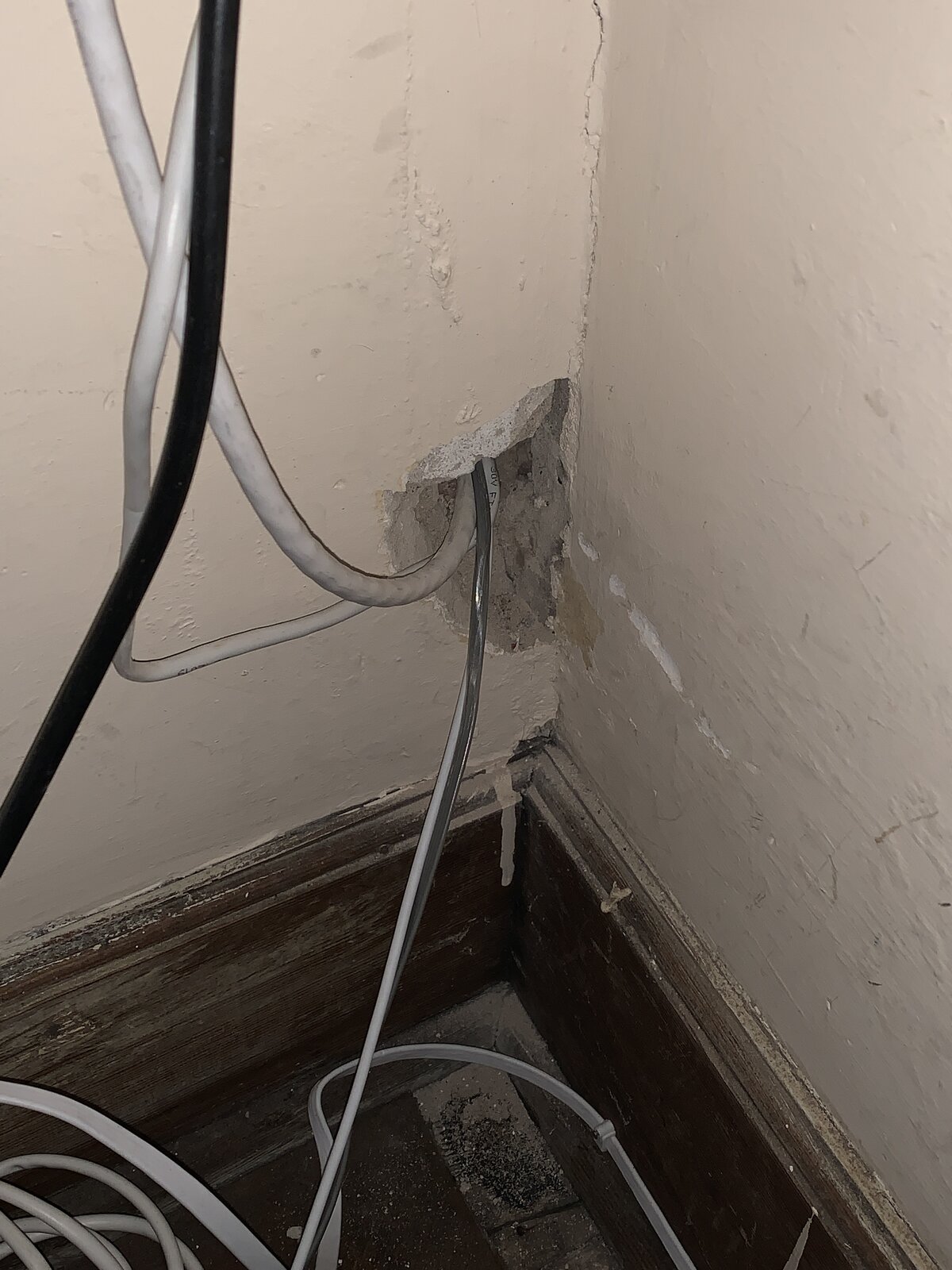

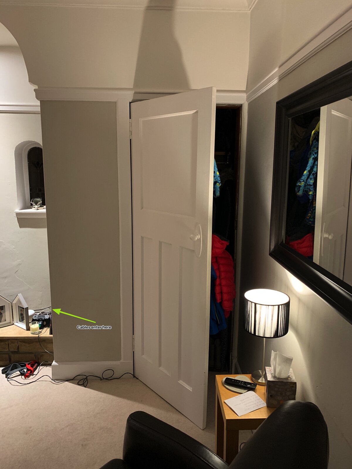

Hello everyone.
I have brick built cupboard in my living room. Within it there is a recess that is shelved and is a convenient home for my home IT - NAS, network switch etc etc.

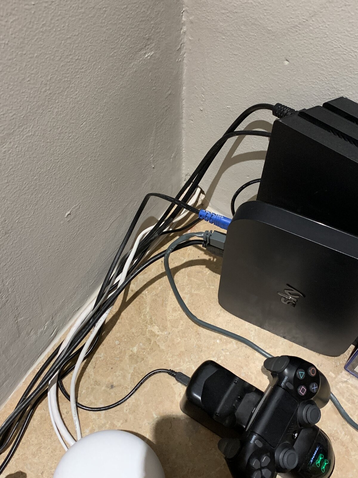

In my living room I have a number of devices... TV, Sky Q Mini, PS4, Google Nest WIFI router etc... some of which needs power / network cables to go through a brick wall.
The previous owner crudely drilled a hole from living room through into cupboard for the passage of cables - best illustrated by the attached pictures.
It is not easy to pass cables through the present hole.
How can I improve upon this for a neater look and easier passage of cables.
Kind regards, Gordon
Drill a bigger hole and fit a sleeve to make it tidy
I squared off the hole with Makita multi-tool and then used Starrett hole saw kit to widen hole through wall (from both sides). I have not lined it yet however the cables are passing much easier.
