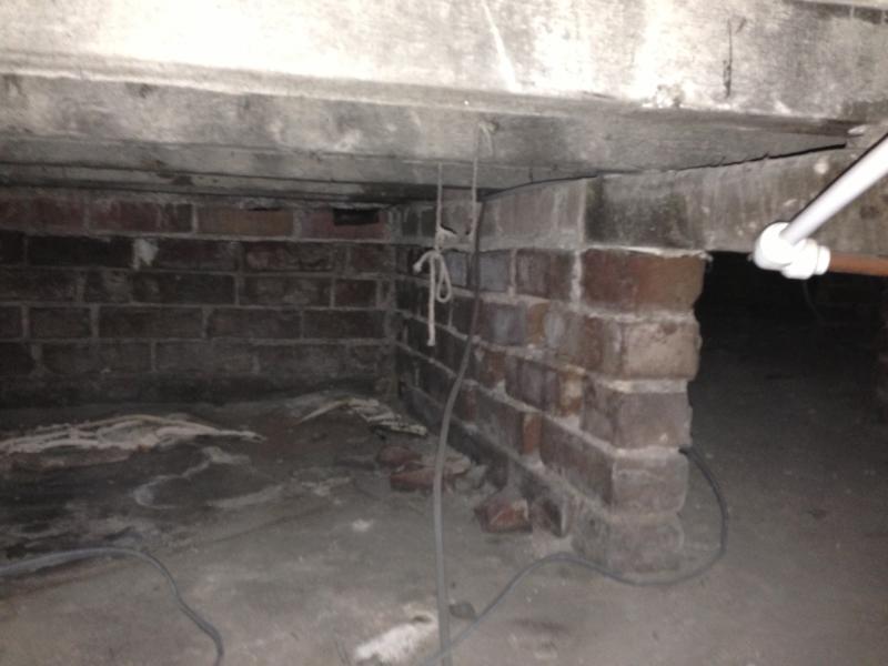

There is a crawl space under the house from which I might be able to run a new power outlet although this is my least preferred option due to spiders and the high probability that I wont locate the correct part of the wall to drill.

Going under the floor does sound the way forward. Not sure why you're concerned about drilling in the wrong place. Typically you would drill from the room downwards into the floor void - having checked there's no pipes or cables in the way.
Typically you would use 2.5 mm2 twin and earth cable - but you need to correctly decide where you are going to get the supply from.

At the moment there is an oak floor laid which runs under the skirting, I don't particularly want to move any of this. My idea is to find out where the wall lies in the crawl space and drill abeam it, then knock through some plaster and pull the cable up. Does this sound reasonable?

Yes, but make sure you are in the right place, you don't want a hole through your nice oak floor!
With a long enough drill bit you can start drilling through the plaster above the skirting, and drill right down behind the skirting, through the floor, through the beam (or wall) below the floor, and come out into the void eventually.
Might need a couple of bits - wood and masonry, depending on what you hit at various stages.

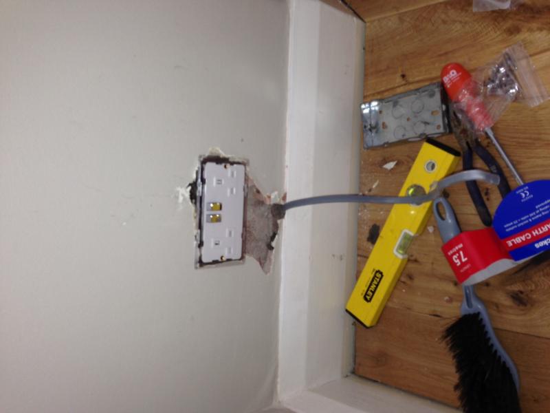

Thanks Owain, did exactly that. Luckily my SDS drill broke through just at its limit. I've chiseled out the new socket and run the cable back to the consumer unit (which is where the entrance to the crawlspace is)
- crawling through is not nice at 6"2 and 210lbs.
I've got my plasterer coming to do the fireplace in a couple of weeks so I'll make sure he does the socket as well.

Thanks for all the info guys. I ended up extending the current ring main and incorporating the new socket instead of bringing it off a spur. I felt this was neater and safer
I had to use a junction box to extend a section of the ring which wasn't ideal but I used a 30amp one and made sure it was all secured properly to a joist.
Power went back on and all is good
