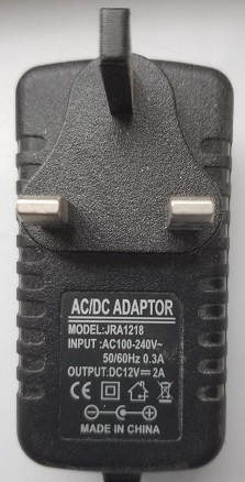

I've bought a 12v security camera and it comes with a plug in power supply.
I could just plug it in to a socket but that would mean a rather ugly looking set up with the wire running from a socket under the carpet and floorboards, or possibly through a hole in a bedroom wall.

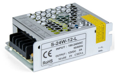

I'd rather wire it in under the floorboards, here's what I'm thinking.
Run a cable to a fused spur which then feeds a 12v transformer which will sit under the floorboards.
Then feed the output from the transformer through the wall.
So, am I breaking any rules by doing this?
Is there a better way?
I'd be glad to hear any advice.

Here's the adaptor it came with.
And here's what I'm thinking of.
I guess the real question is, can I install this under the floorboards?
Or is there a better way?
Installing anything under the floor is a poor choice as at some point it will need to be repaired / replaced.
That style of power supply is intended for use within equipment and must be installed inside a suitable enclosure. It cannot be used as supplied.
That’s a power supply, not a transformer. If you put it under the floorboards it will need to remain accessible. Will it be?
The supply terminals will need to be shrouded, how will you do that?
It will still need a fused mains supply. If you are having to lift the floorboards, you may as well just plug the original power supply into a socket and buy a long extension lead to connect to the camera.

So, is there a style of power supply that would be suitable for under floorboards?

Incidentally I believe the power supply supplied does not conform to the regs as the pins are too close to the edge, or put it another way it is not wide enough. That leads us to a false CE mark, and thoughts as to how safe the rest of the kit is.

I wouldn't be putting either of those items below my floorboards. When the magic smoke escapes you want to be able to see it happening before a fire starts.
