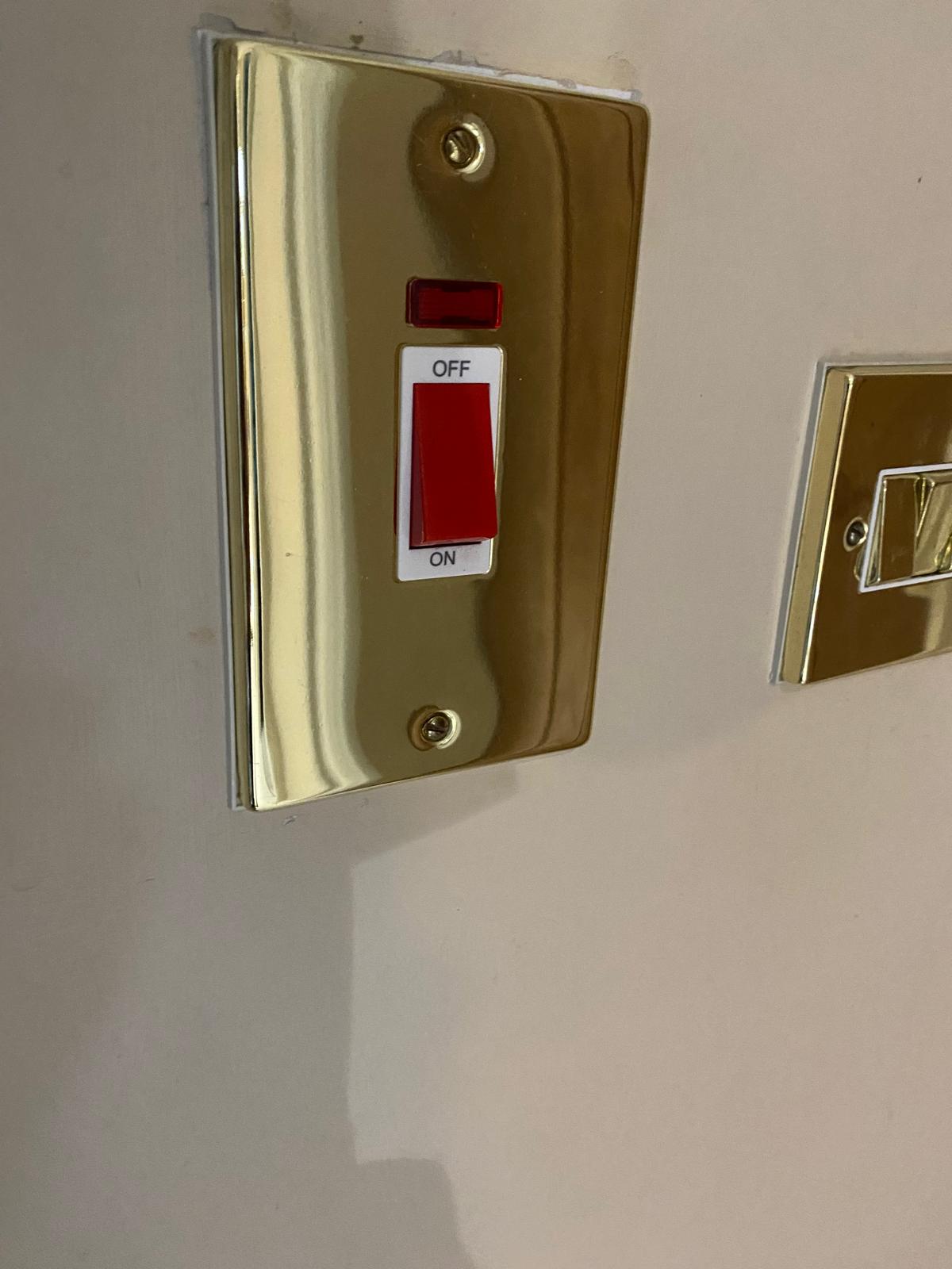

Hello our electric shower is not working for the second time I've changed this switch twice now and there is a strange smell coming from it what is the issue. Its a pain not having the second shower not working.
My x-ray vision isn’t working today. Need to see the connections to the back of the switch.
PS turn the power off before you remove the switch plate.
As above , the wiresmay be loose and arcing over time. If so, you need to trim the wires back (hopefully there will be enough slack to do so.
