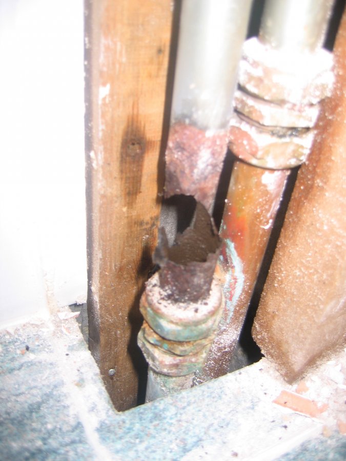

So powerflush sounds like a good idea, however I'm worried about causing leaks in the existing pipework.. When we replaced the kitchen we found a leaking compression joint that corroded the pipe, the pipe looked galvanised, and this runs behind walls up to the water tank so worried if there is more corrosion there will be a pinhole or perhaps more serious leak.. it's all hidden.

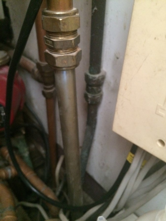

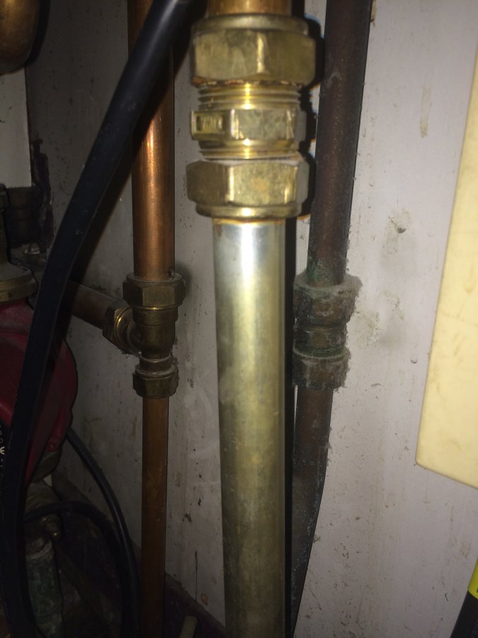

Im a little bit concerned about the pipe that you found leaking, you say it was galvanised this is doubtfull, if you can have a look at this pipe and feel all round it and see if you can feel a seam on the pipe, there is a chance that your system has some truewell pipe on it and if it does you wont be able to use chemicals or a power flush, truewell pipe was used when there was a shortage of Copper but its horrible stuff and if you do have it you will have to replace it

Yes please do, lots on here very experienced with truewell, not the end of the world if it turns out to be that but will need replacing dont try and flush it if it is that
OK so here's the pic of the pipe that was replaced, down in the kitchen in 2010 (IMG_0045.jpg)
And the existing in the airing cupboard: IMG_1908 and IMG_1909.

Damn. :(. Thanks for the heads up, at least I know what we are up against.

The plan is to replace that piping before the flush, the system needs flushing as far as I can tell.
Unless there are other ways to address?
You will have to replace all the truewell before you can flush anything or you will end up with lots of bits like that
