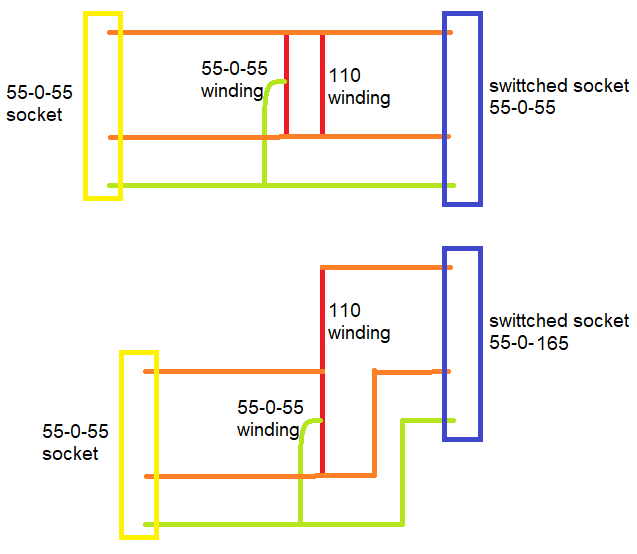

I've worked on a kawasaki that did cause problems as it had a 110 socket permanently connected as 55-0-55 but the other socket was switchable 110/220V by parallelling the 2nd 110 winding (so 2 110 windings and 2 sockets all in parallel) or series the windings for 55-0-165.
