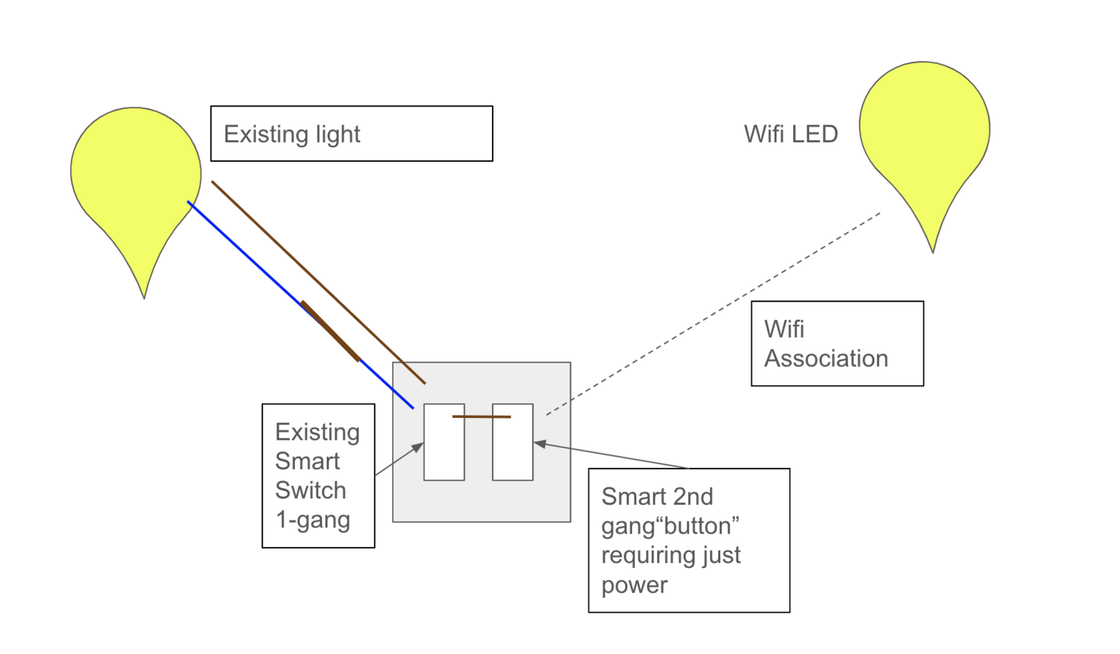

Hi!

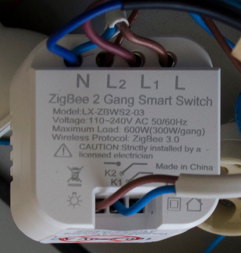

The store I am buying my smart switches from claims that I can do a false 2nd gang switch by without needing extra wiring to a light, but just tapping into power from the existing light switch. I was wondering if anyone knew how I would go about wiring this.
I have made a diagram to explain what I am trying to do.
Before you ask, yes, it seems overkill for some shelf LED's when I can just stick a battery-powered smart button on the wall, but I am also trying to achieve two-way stair lighting using smart multi-switch association, which would otherwise be IMPOSSIBLE to wire.

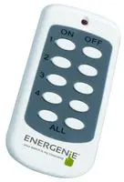

My old smart switches (Energenie) passed current through the bulb when off, just a small amount, to power the switch, and they need a load of at least 5 watt. My new smart switches (TP-Link) have a battery in them, and can switch any load even if not 230 volt. The old ones did have an option of a second switch hard wired, the new ones no hard wired option. Both could use remote unit to switch them.

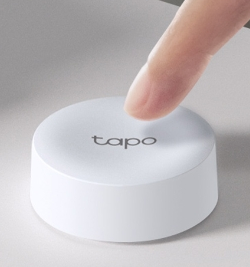

One can get buttons 1703676702812.png Remote control.jpgwifi linked to switches, or relays, but you need power to the lamp. I use a relay DSC_6061r.jpg for my landing light, because the location of the switches is not really where I want them. It is also hard wired with a extra low voltage system. but to be frank hardly ever use the manual switches. I use voice commands with google Nest Mini's.

Hi Mottie,
so for shelf, closet and stair tread mini LED's, they are just connected to mains via a smart plug. I can switch them off via alexa, but my wife insists on a physical button. I was thinking of just adding an extra batt-powered button on the wall, but if I am buying/replacing all the switches to smart switches, then if it has the option to have the 'button' within the switch, i.e. a second gang that is permanently powered on, and acts as a wifi-switch as opposed to a wired switch, then might as well and would look neater.
For the actual stair lights (downlights), I have one upstairs that is two-way, i.e. can be switched on/off both from the downstairs and upstairs switch, but I also have a downstairs light that is only switched on from the downstairs switch. If I can change the upstairs switch to 2-gang and use as a smart 2-gang, that would be awesome.

Hi Eric,
thanks for the info! that was useful!
so basically, I can switch my lights on/off via alexa, but my wife insists on a physical button for guests etc.
I explained a bit about what I am after to Mottie's post above, but essentially, I want to permanently power the second gang of a light iwtch, so that it acts as a wifi switch.
So for example, at the stairs, my downstairs light is only 1-way wired, i.e. only can be switched on/off from the downstairs switch. I want to replace my upstairs switch to a two-gang, and have the second gang permenantly wired on, and act only via wifi switch.
