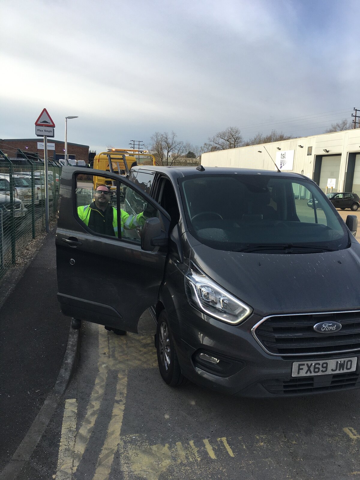

Hi Andy , unfortunately i do have the same problem! I bought the van 2 weeks ago with 8200 miles! Now i have 8600 and it’s been in and out of Ford dealer!Aparentley they found water in one of the ECU units ! ‍♂️
Mine got picked up today! Give them a last chance to get it fixed! Apparently there is a common fault! Good luck with your new one!
