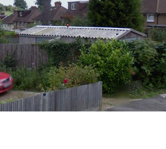

My dad has a pre-fab garage which he purchased in 1997 and was erected by the supplier.
The roof has started to crack and is leaking. It has a slight pitch and is corrugated sheet material, grey in colour. Because of the date, we believe that it wouldn't be asbestos (but unsure what it is), but an acquaintance of his who works in asbestos removal has said that it could be.
1) How likely is it to be asbestos? I think the acquaintance could be fishing for work!?
2) What is it likely to be (if it doesn't contain asbestos?) Can these be replaced DIY and if so, where would we get them from?
3) How would we go about disposing of the damaged sheets? How do we prove to them that it is asbestos free - I suspect grey corrugated sheets would set alarm bells ringing at a household refuse site!

Was it a new purchase or second hand? Did he get a special deal on it?
1997 is relatively 'new' for a roof such as this, it shouldn't really be cracking yet unless the sheets aren't properly supported at the required intervals, or kids have been playing on the roof or some other weight stored up there.
Be sure the leaks aren't condensation, if not then you can paint over the cracks with a roofing repair mastic to get another few years of use out of it.
No real way to know without getting it tested, but you can diy dispose of. contact your council environmental dept for advice here.

It was brand new- chosen from the catalogue if I remember rightly.
Dad reckons there is a chunk missing- as if a football has hit it, but I do know he has stuff stored along the metal "rafters" on the inside, which I suppose could be putting extra weight around where the bolts attach it.
If it's limited physical damage, might be worth following the precautions listed in the link, and replacing the affected sheets.
See what your council say, ours will collect a certain amount of unbroken poly wrapped asbestos for free, usually limited to a few sheets otherwise you'll have to pay a fee.

Unlikely to be asbestos, but if your concerned get it tested. My garage was late 80's did have asbestos roof and i paid a lot for it to be removed professionally along with other Asbestos in the house i was buying but i felt it's worth it for the piece of mind.
I used to wooden battons bolted or tied to the metal frame and used onduline to replace the roof for a very nice looking new roof, all diy cost £120 for onduline and fixings.

History:- In 1976 I built a Compton garage completely, roof never leaked until I moved 3 years later. In 1982 I bought a SECONDHAND Compton garage, built it my self, roof was OK until I moved in 2012 (30 years!).
For cracks I would just patch them with "Flashbanding", after masking the area and using their correct primer. If there is a bit broken/missing, I would get some thin ali sheet, hand bend it to the correct contour and fix it in place by using the Flashbanding overlapping all the edges by at least 3". You should be able to do all the work on a Saturday morning and it should not cost more then £50.
