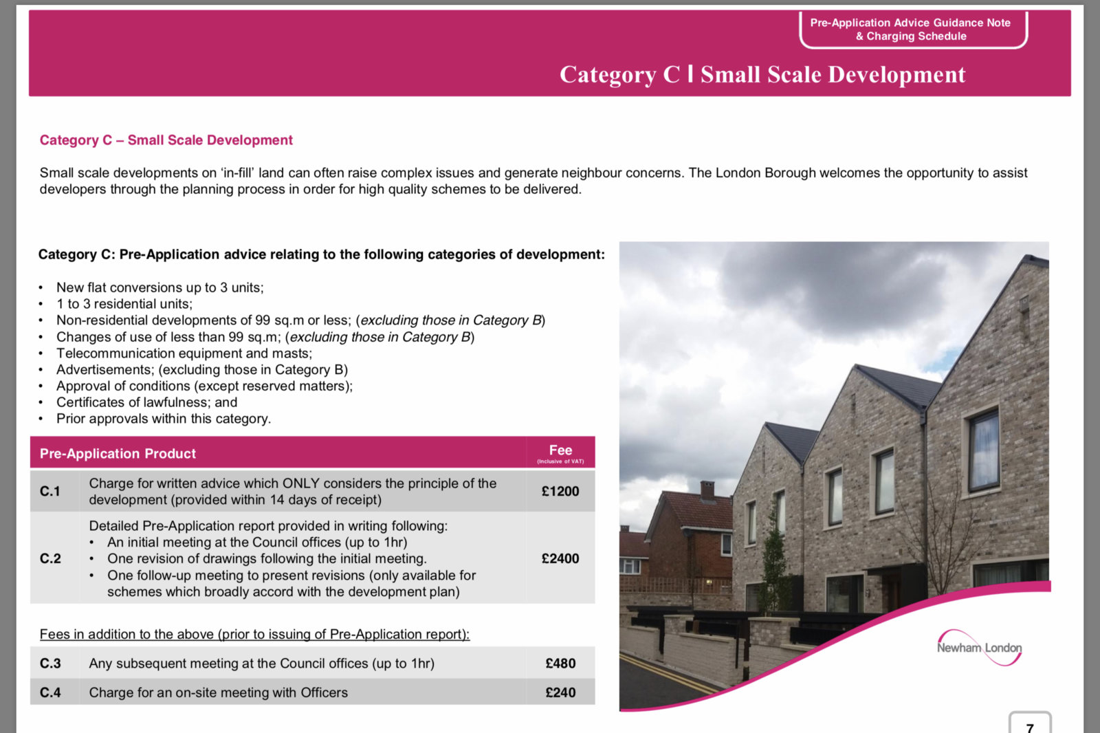

I would like to understand what the council mean with regards to pre-planning application, some of the things I understand, the others I am unsure about. Will someone please be kind enough to expand/explain. the proposal is to build a detached 4 bed house on a plot of land which is part of a side garden of an existing dwelling. At this stage, I do not require full planning, just a pre-planning advice.
An example of what the council require in terms of a picture or a reference would be greatly appreciated.
  • a description of the proposed development and schedule of proposed uses ( I understand this)
  • a site location plan (scale 1:1250) ( This can be purchased from land registry right ?)
  • photographs and sketch drawings showing the site, buildings and trees as existing, together with the schedule of uses (Can someone please explain)
  • outline of the proposal (on plans scale 1:200) (Can someone please explain)
  • sketch drawings showing height / scale of development (Can someone please explain)

The outline plan, is that almost the same as a roof plan ?
Height/Scale of the development, is that like a front elevation showing the height up to the soffit board and also the topmost section of the hip roof ?
Yes "outline plan" is like a map view where you have rectangles for the houses, and boundary lines, significant trees, roads, paths etc. The idea is that the planners want to see your proposal in context of the site and surroundings.
Likewise for height and scale - the elevation views in context of the site and surroundings, including whether the site is level or sloping. The planners want to see your proposal compare the the neighbouring buildings or land.
Bare in mind that the planers only comment on whatever info you provide. If the info is wrong, or incomplete, then you get a wrong incomplete opinion, and that could significantly affect the viability of the proposal. That's why you need to know what info to provide, and equally what info may be best not to provide, the policies the planners will asses it by, and how to present it.

Block plan / site plan.
Basically the Authority is going to want to know as much as possible about what you are proposing. Where, What, how high, how many beds, parking, garden etc. Without some of the information they may not be able to give advice in regards to the suitability of the scheme (effect on privacy, street scene, outlook, sunlight etc)

In my opinion with the amount of information they require nowadays for pre planning advice you are half way to submitting a planning application !
If you go onto the council website they will have all planning applications on-line. Download a few completed and approved ones and you will see what they look like. With a bit of searching you might even find one pretty similar, especially if your house is a standard style.

This is what they want in Newham. Nothings free there nowdays. Cheaper to just have plans drawn up and submitted, which is what I did.
Pre-app advice is useful where you have a couple of different options about how you might develop and extend a property. It's counter-productive when you don't. Under those circumstances, it's often cheaper (though not necessarily quicker) to just go through the planning application process two or three times.
