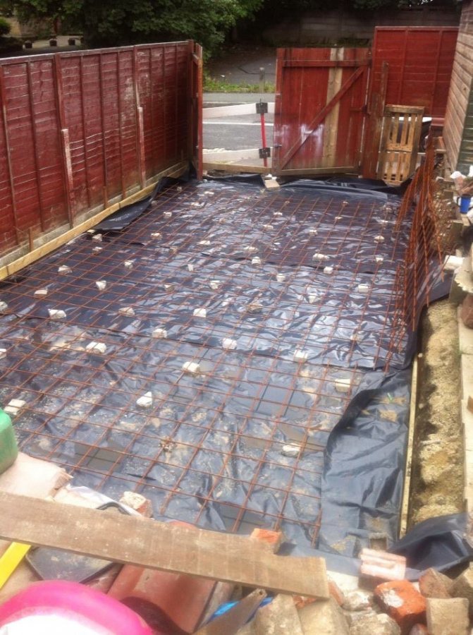

I have to demolish an old precast garage to allow for an extension. After giving thought to a few options I decided to go with a PvC shed. The shed requires 100mm thick concrete slab around 3000mm x 3000mm at the base.
Quotes received for preparing site and purring mixed concrete for this work ranged in the area of £700~900...o_O
I worth if worth considering a precast slab or something alternative for the base and whether it would save costs or have the opposite effect?

Make a frame from 4x1, pour the concrete, run a 4mtr length of wood along the top of the frame to level and its job done.
Stick some mesh in it if you like but I wouldn't bother.
R896neo is right about the ready mix, it would be quicker and cleaner and might even be cheaper than doing it yourself if you had to hire a mixer.
See the frame on this one?:
Ready mix is about £100/m3 depending on locality...........so for £100 (0.9m3) it just isn't worth messing around with a mixer, cement, aggregate, mess, hard work etc.... Some firms also offer chopped fibre addition to the mix, so may not require the steel mesh.
