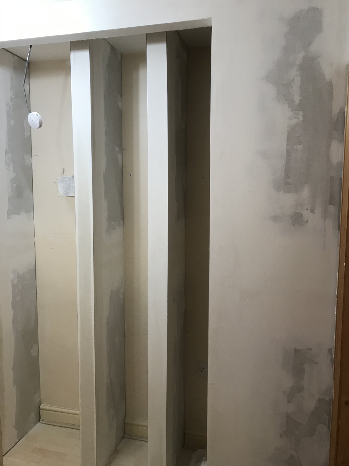

When applying paper tape to butt joints of plasterboard, do I need to prefill the joints or can I fill and tape as a single step?
Thanks in advance
Not done drywalling but artex which I imagine would be the same, spread filler along the joint to fill joint then roll out the tape bedding in with spatula as you go

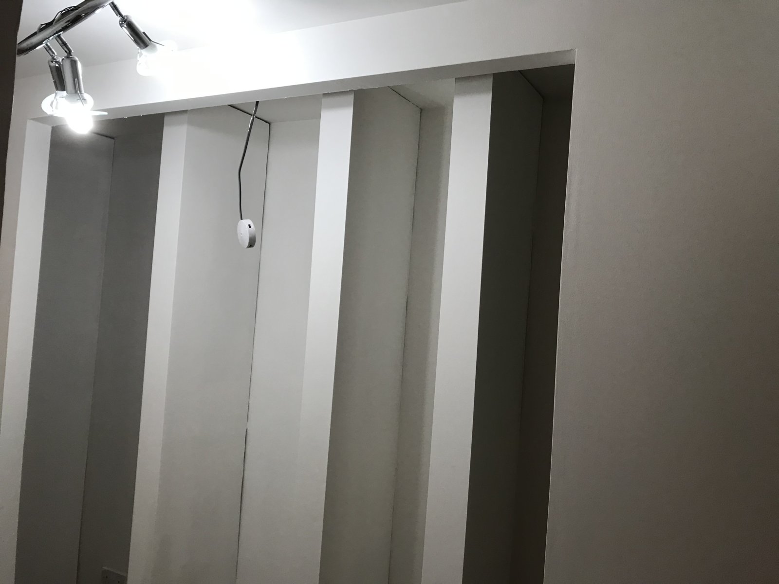

UPDATE: This approach worked for me. Here are some pics from my recent DIY project. Thanks for your help.
