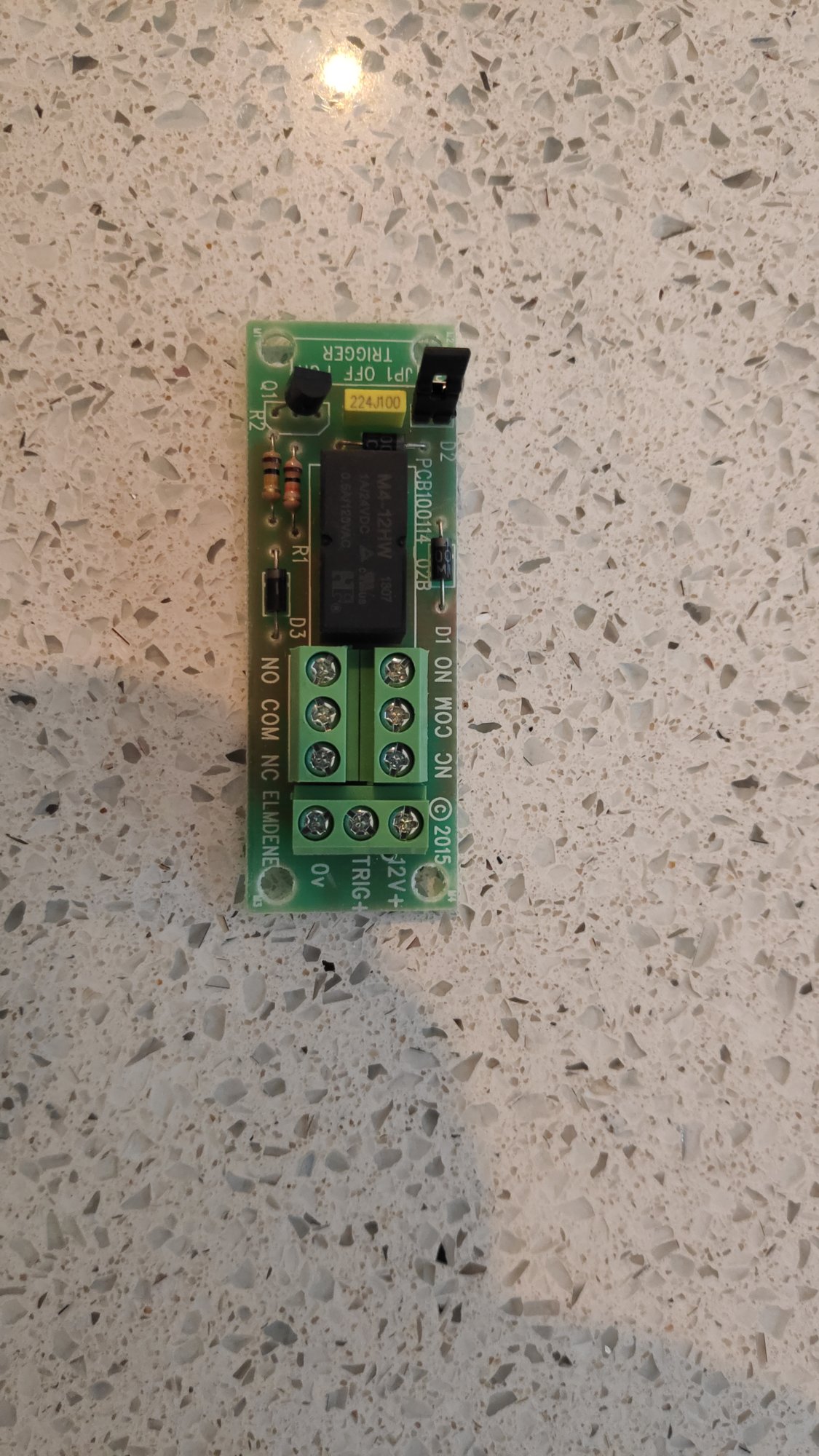

would this relay be compatible?
https://www.ebay.co.uk/itm/NEW-Elmd...518216?hash=item2ce7dc0948:g:AkEAAOSwhX5b2DZJ

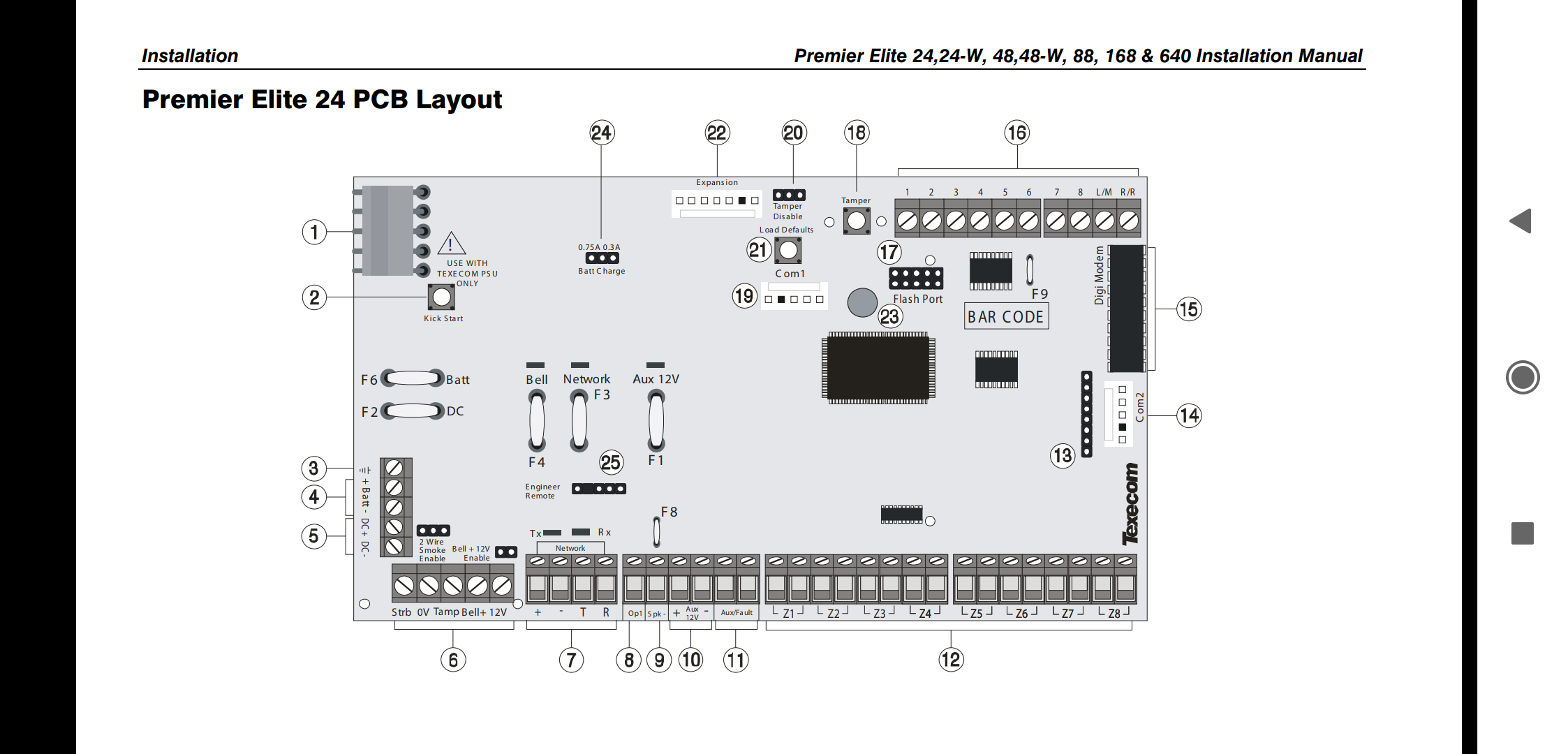

if so how is it wired in? obviously 12v/0v i'm happy with, and it must be connected to the garage door connections and a programmable output on the alarm board.
but how exactly? or can anyone provide a picture please?
i take it its wired normally open to the garage door connections so when the relay energises it makes the connection and opens the door? if that is the case where does the programmable input wire into?

power from panel and an output wired to relay trigger programmed as PC control 1
you will need to make sure your smartkey is programmed on the panel to use this feature.
No idea on the garage door connections without knowing what connections its got available.
I would expect you to wire the common and the normally open or normally closed to the garage door to trigger it/

Right I have the relay and am happy with all the wiring etc.
Using wintex I've set Panel Output 1 to Pc Control 1. Is that it or do I need to have a certain attribute checked?

Wire 12v/0v panel (10 on pcb diagram) to 12v/0v on relay pcb.
Wire output 1 500mA panel (8 on pcb diagram) to trigger on relay pcb.
Then wire from NO & COM to relevant garage door connections.

I've set output 1 on the panel to Pc Control 1 in wintex, to achieve the above do I need to set a certain attribute as well?
Many thanks for the help really appreciate it:)
I presume that the garage door controller just needs a momentary pulse to open the door? If so, assign the Pulse 1 attribute to your output and then change the Pulse 1 timer to about 5 seconds. That way, if the button is pressed, the output will switch for 5 seconds and automatically reset awaiting the next trigger.

the relay above works a treat, in the end i couldn't get output 1 working so switched to the digicom output 1, set that to PC Control 1 with the pulse attribute selected as advised, adjusted the pulse timing to 1 sec and tested it all via wintex where it all works as it should.
