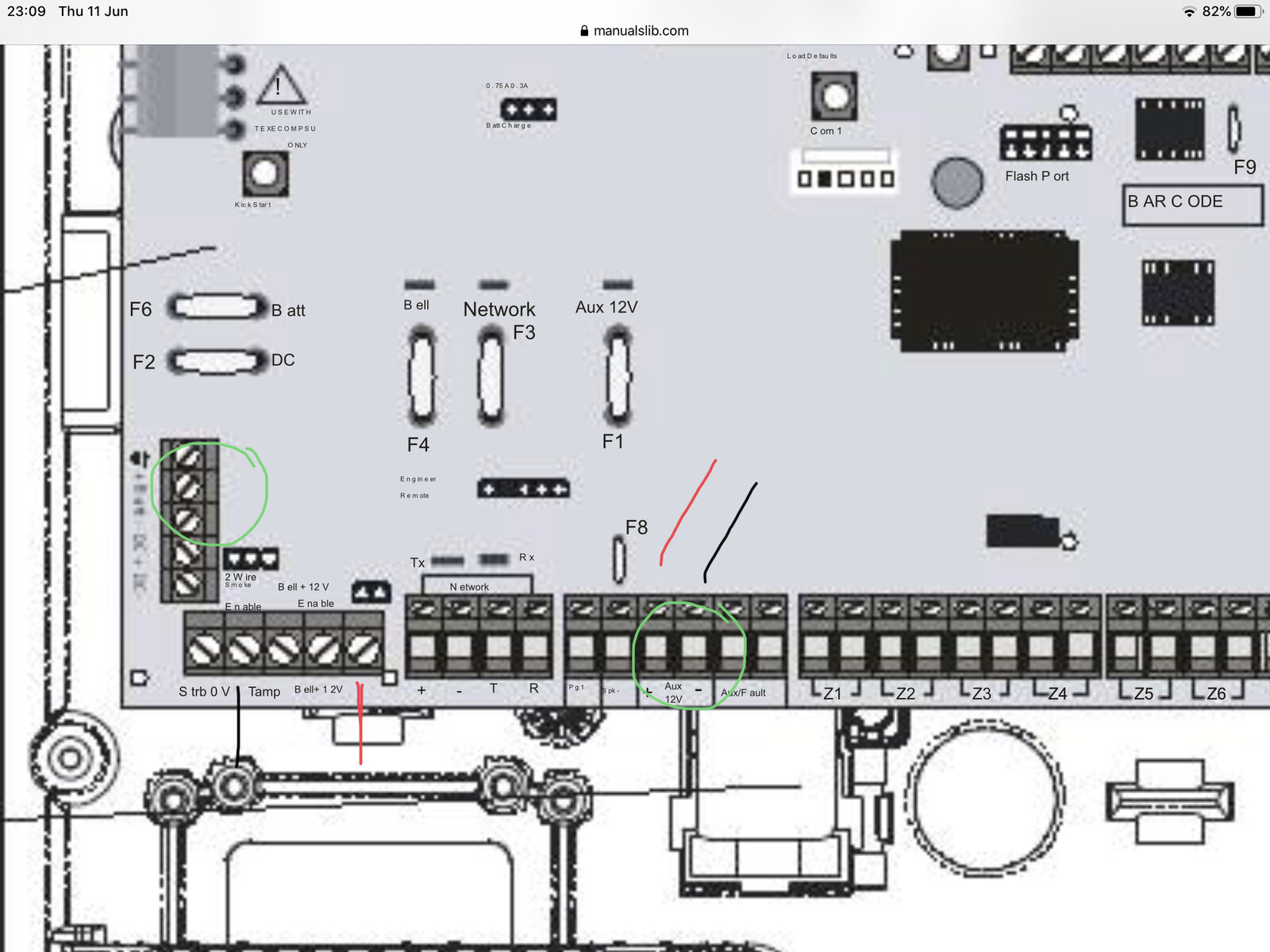

Hi Guys
Fitted 1/2 a dozen alarms over the years, maintance technician by trade so know the basics.
Had this panel installed about 6 months and today had a Mains off, PS Failure, Power O/P fault. Power is still applied to PSU and panel. Molex measures around 20v when checked across the red terminal and other three once disconnected
So my question is, is this voltage ok when not under load? Is the fault likely to be the board or the PSU.
Wintex does not show over voltage or a PSU battery fault or a PSU mains fault.
Battery is powering system at 12.5 v and shows System Current at between 0 and 0.4A
Firmware is 5.01.03
Any help or advice much appreciated.

Doesn’t read correct to me ...if that psu was inputting 18-20v I would probably be seeing that at the battery leads , aux volts and bell supply , nominal 13.80v ish , and you should be getting around that at the battery disconnected !

Forget the blue and yellow wires from the psu ....they are probably signal wire from the psu for mains fail ect .... with the meter set on dc put your leads on each of the following ...
Battery leads ( battery disconnected )
Aux supply
Bell supply
All should give a reading of around 13.8 dc
All finally battery terminals ( disconnected from the panel )

Tested as you asked, battery disconnected all read 0.5v.
Battery is a solid 12.5v
Many thanks
That doesn’t sound good ! Or correct as the bell would be ringing if 0.5v at the bell supply ? I take it has a hardwired bell ?
