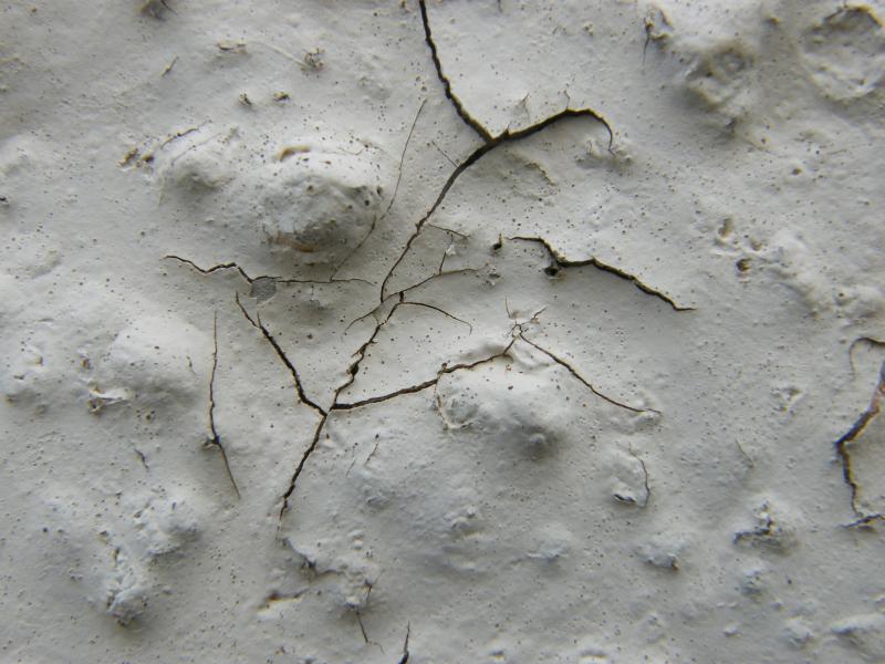

Some of the paint started out looking like this:
with cracking over large areas.

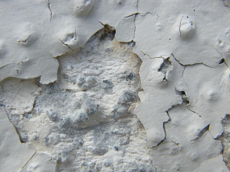

After power washing, I get this

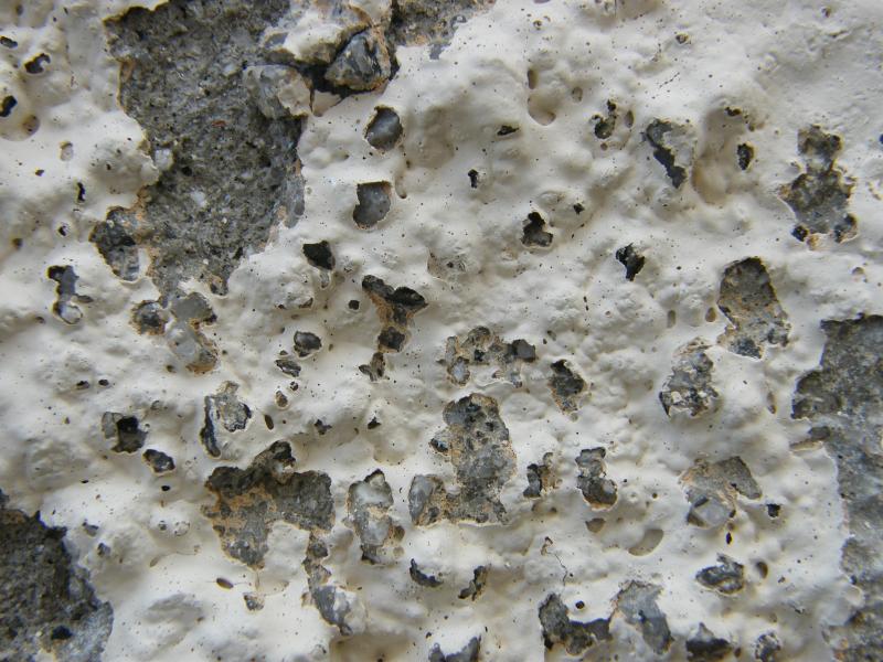

or this
I am concerned that having got some of the paint off - which inevitably leaves flaky edges - I will have to carry on and get ALL of it off. This will take me days and enough water to end a drought in a small African nation!
How thorough do I need to be? Will stabiliser hold together the bigger remains? Or does it all have to go?
