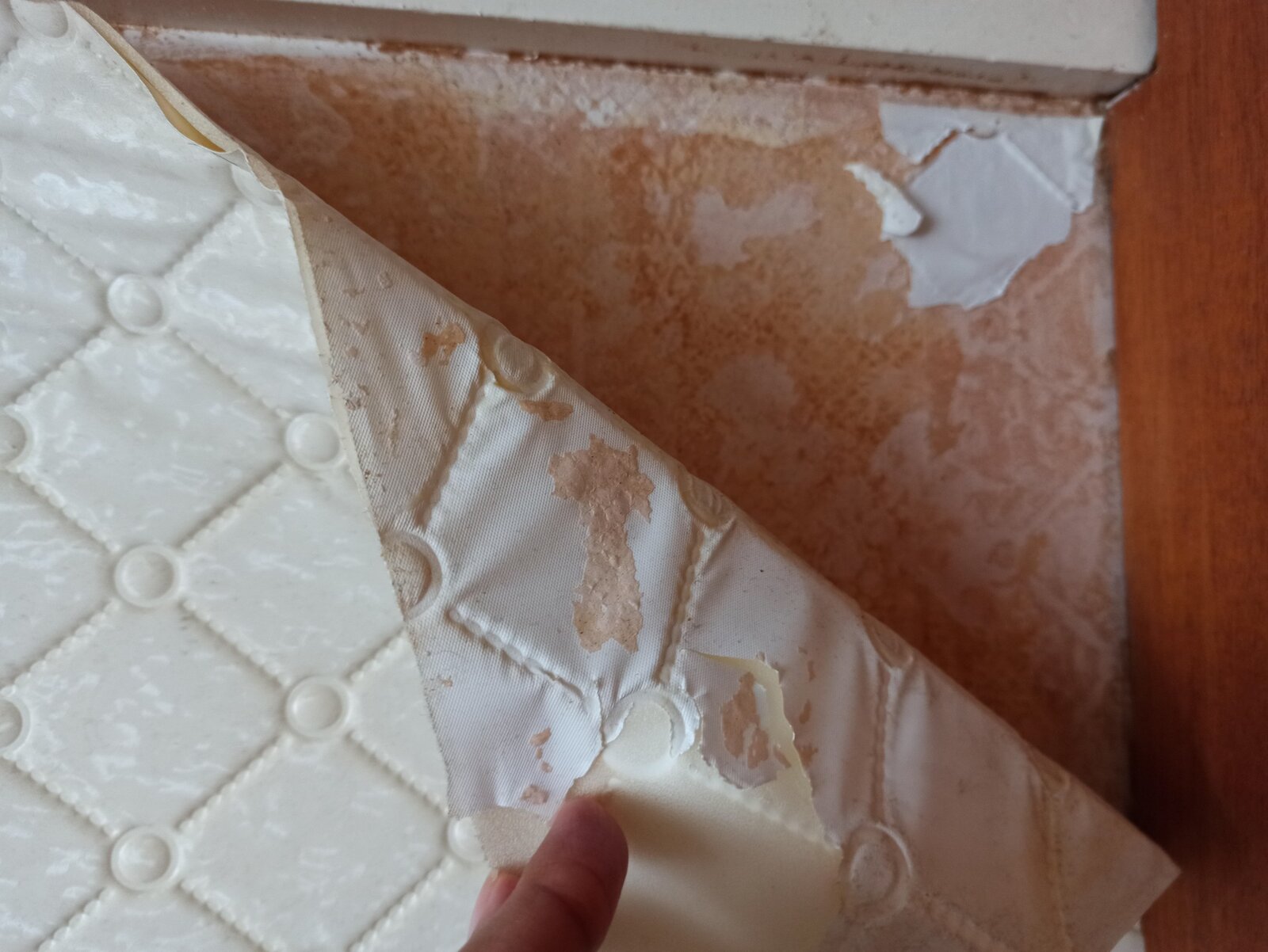

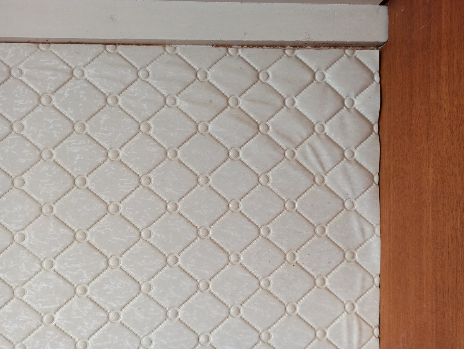

I need to remove a 70's plastic covering and prepare the wall for painting. Thanks in advance.
Sand, fill, sand, fill, sand, Zinsser Guardz, emulsion, fill and sand as needed, emulsion.
