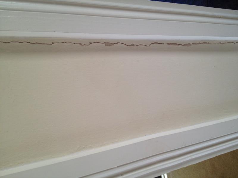

I am planning this weekend to paint my living room and would like some advice/steps needed please to ensure that the finish is of a high quality
When preparing the walls what steps should I take before I start painting?

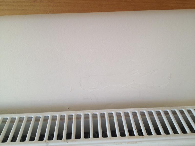

And looking at the two images below, is it best to sand this down (if so what grade paper) and also in the 2nd pic how could I fill in the blemishes in the current wall to get a smooth finish
For the crack, which looks like it is a door frame, I would scrape that area gently with a small scraper to remove anything which is loose.
It doesn't look to deep so you should be able to get away with decorators caulk to fill the join between the frame and the wall.
I would rub down the area above the radiator for a key and face fill then smooth off. Then I would wash down all walls with sugar soap ready to paint.

Get yourself some red devil filler or a toupret lightweight, fill the blemishes with this , you may be better using this filler on the crack, you can apply it with your finger. Spot prime filler with watered down emulsion (about 30%).
No need to sugar soap walls unless they are noticeably dirty, rubbing down will remove any surface dirt. I use 180 or 240 silicone carbide (usually labelled up as between coats paper).
Don't forget to rake out the crack.
thanks
For the peeling / cracked paint by the door frames I have used a stanley knife to remove the loose flaky paint and plaster and have used decorators caulking around the frame
Is this ok?
With the blemishes above the radiator - should I sand it down first, or just fill in with filler and then sand down for a smooth finish?
Finally I have some more cracks in the plaster, when you mention rake out do you mean using a screwdriver and working it down the crack to make it bigger so there is enough for the filler to hold on to, otherwise the crack will re-appear?
Just to simplify things
1. Scrap away any loose paint
2. Open up any cracks with as you say a screwdriver or knife ( I uses the point of a scraper) whatever you find easiest.
3. Fill and sand
4. Water down some Matt emulsion to paint over the filler
5. Paint
As for woodwork i prefer to sand before any painting is done, just so the dusty work and prep is done.
Thanks what's the best approach and tools to use to scrape away loose paint such as around door frames , bottom of skirtings etc
Thanks so just use a tool like you mentioned and then use decorators caulking around the frames , skirting frames etc
Why does the caulking / filler need to be painted with watered down emulsion first ? Coup I just paint over it with normal paint
In some cases the paint can peel off the filler, watered down emulsion will seal it first, like you would with new plaster.
