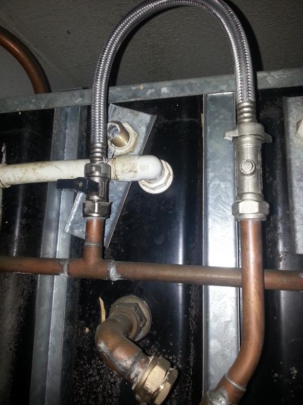

My Grans called me over as her boiler was not working. It looks like an issue with the pressure.
The red reset light is flashing and the display is reading 0.5 bar.
The picture shows the pipework for the boiler. I have opened up both the black valves by 90 degrees, first the one on the left then the right, but even after 5 mins the display reading has not changed from 0.5. Have I gone wrong somewhere? Any help most appreciated. Thanks

I think it would be OK at 0.5 Bar. Also I do not think you have a fill pipe installed between the 2 black taps that you turned.
The filling loop (braided hose) isn't connected. It should be somewhere nearby and should be fitted once the brass caps are removed - the bits sticking outwards on your photo.

As its a system boiler by the looks of it. due to the lack of cold feed and hot supply. then even bridging the pipes with the caps off are going to do nothing regards filling the boiler, as your just bridging flow and return. they're just drain points you need to find were the cold supply is near and find a braided filling hose. try underneath the boiler in a kitchen cupboard or above the boiler etc. an no it wont be ok at 0.5 bar, as theses have a water pressure sensor hence your problem.
Find this 2 floors up from the boiler near the water tank. Is that what I'm looking for?
would certainly say yes. but what a stupid place to put it. guess theres no guage nearby to check how much to top up ? otherwise youll be running up and down like an idiot. open up the black lever to top up.
No gauge near it so was up and down at least half a dozen time. Got it done eventually and the boiler has fired up. Thank you all for your help.
