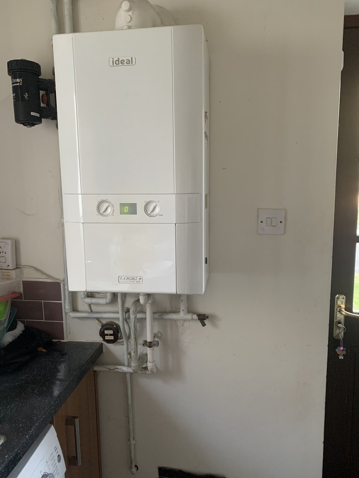

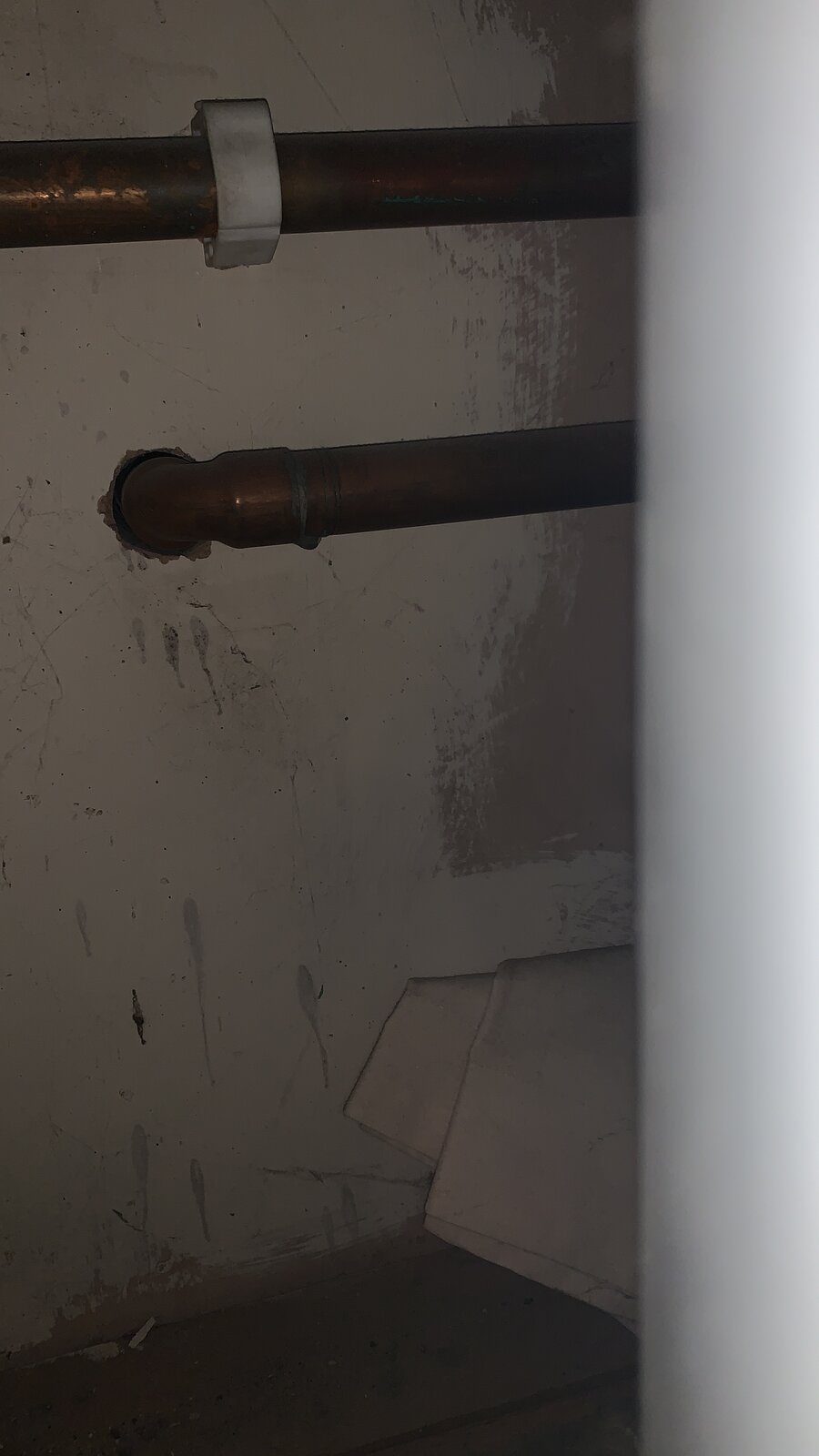

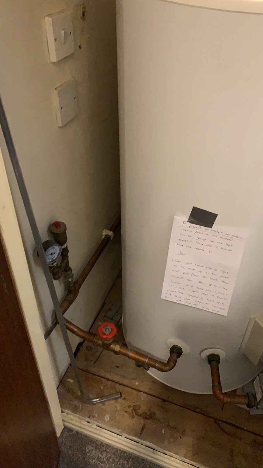

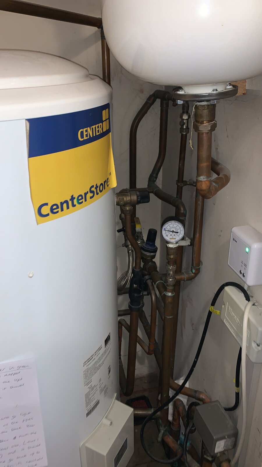

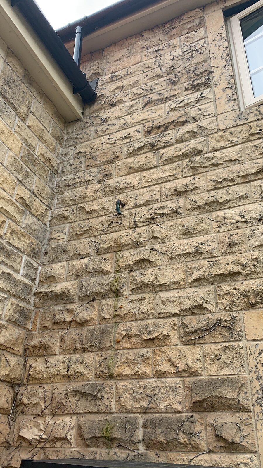

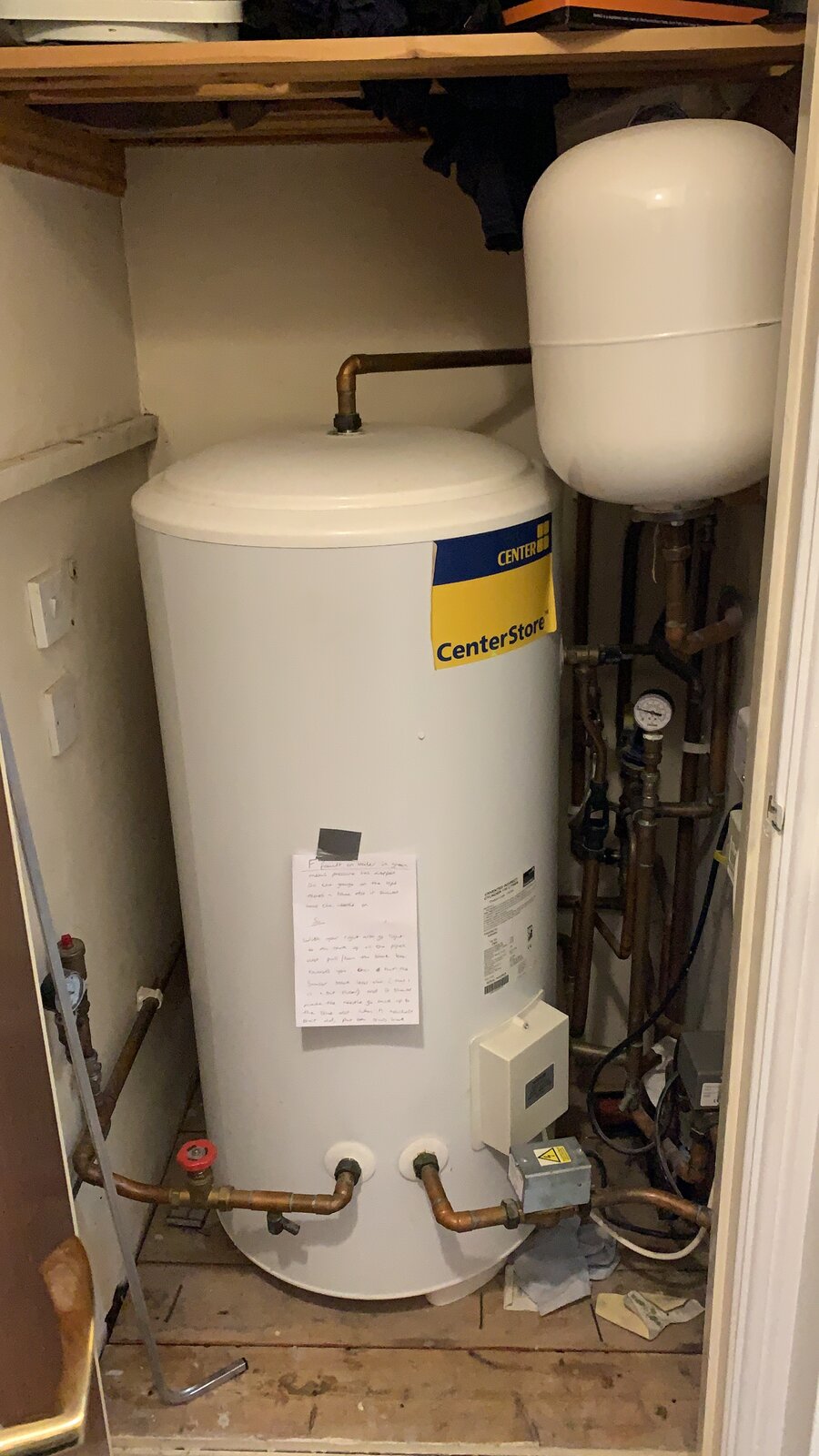

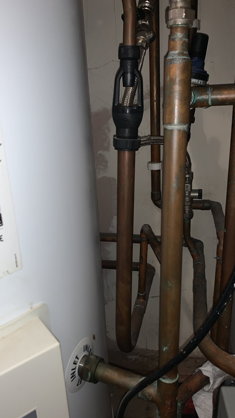

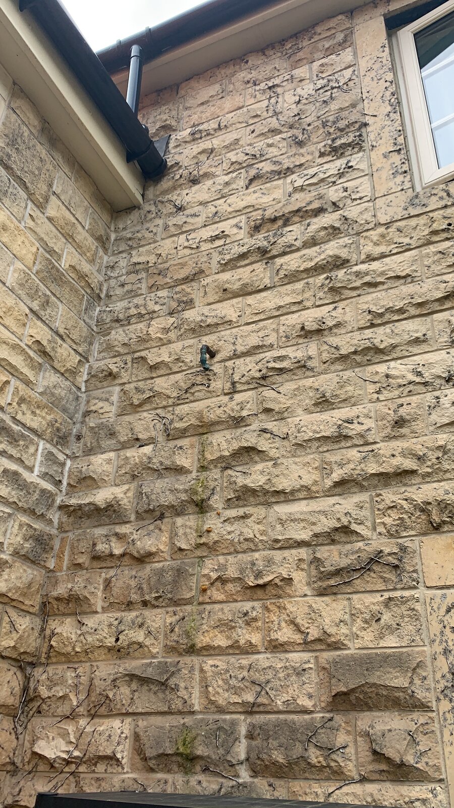

hi thanks for the replies, hopefully the pictures help... it is the last picture that the pipe to the outside behind the tank absolutely pees out when boiler is on. i have noted that expasion pressure vessel and heat exchanger test may be things to try before searching any more for leaks.
i cannot see a red safety vessel anywhere unfortunately. there is nothing in the loft or downstairs. cheers for the description, yes im not too familiair with the exact purpsoe of each part. i looked on gas safe register for unvented ticket engineers and cant find any!

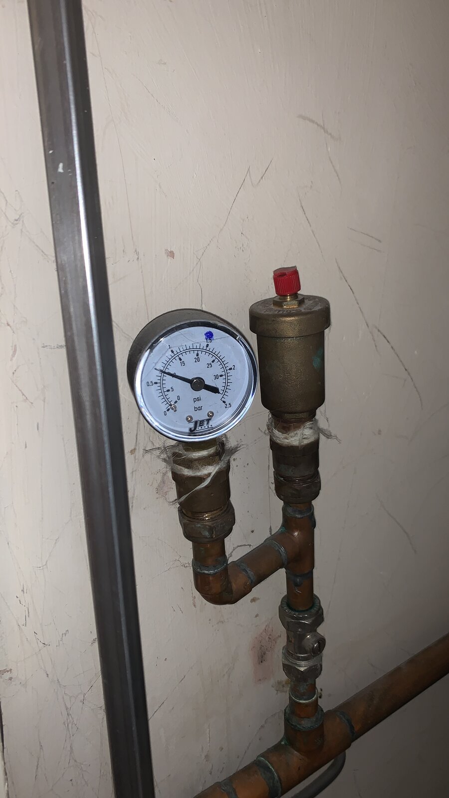

ps, it is the gauge in the bottom left corner of the cupboard that loses pressure, the one near to the tundish is stable.

1. Judging by your photographs, the boiler is in a ground floor kitchen and the unvented hot water cylinder in an upstairs airing cupboard.
2. If this is the case, then:
2a. The pressure relief pipework from the boiler should terminate outside at a lower level than the boiler. Assuming you have a reasonably level plot, this would put it about 1 to 1.5 metres up from ground level more or less behind the boiler. It should terminate by pointing towards the wall.
2b. The pressure and temperature & pressure relief pipe from the unvented cylinder is likely to be the high level one in your final photograph. This appears to have been weeping at some stage. The unvented cylinder will have two devices which require pressure relief. The temperature and pressure relief valve (TPRV), which is the valve with the black plastic knob just above the black plastic tun dish in your photographs is one, the other is a pressure relief valve built into the combination valve which feeds the cylinder with cold water. The combination valve is the valve with the black plastic "top hat" behind the pressure gauge in your photographs. The pressure relief valve is normally attached to the pipework before the tun dish for the TPRV, so that any escape of water from the combination valve is visible at the tun dish. Yours appears (and I cannot be certain) to have been connected to the relief pipework after the tun dish. This would account for the escape of water with a dry tun dish.
3. Nothing to do with your hot water cylinder can affect the pressure in your boiler, except a leaking primary coil in the cylinder with the boiler pressure higher than that of the cylinder. Highly unlikely, so whoever has told you that "that pipe has no effect on pressure" is correct.
4. I suspect you have two faults:
4a. The combination valve for the hot water cylinder is is passing water to the relief pipework. I would advise getting the cylinder and all its components / ancillaries checked by someone with a G3 qualification. I would get the combination valve's pressure relief outlet re-routed via the tun dish at the same time.
4b. A fault with the boiler and / or central heating / hot water primary circuit.
