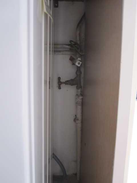

Following on from my challenge with my shower at
//www.diynot.com/forums/plumbing/mira-sport-90-kkw-eletric-shower.290618/#2116000
Perhaps I should fit a pressure reducer ?
I see I can get one quite cheap from
http://www.plumbworld.co.uk/safeguard-pressure-reducing-343-21866
...but I would like suggestions as to where to put it [Now, now - none of THAT here, please !]
The supply pipe (rising main) is an old galvanized steel pipe coming up through the concrete floor, right in the corner of the two brick walls.

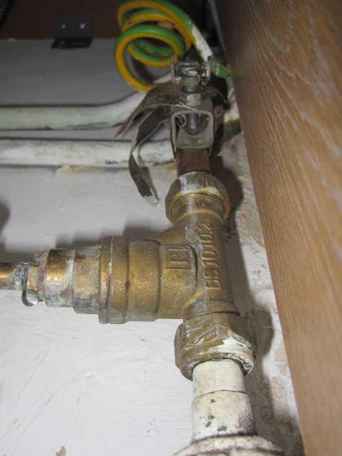

Here's a pic of the incoming supply and the stop-cock, behind the dishwasher.
The "thing" above the stopcock is simply an Earth bond clipped onto the vertical 15mm copper pipe.
I guess an elbow before the stopcock to bring the pipe forward horizontally, with the stopcock relocated horizontally with the handle downwards, then a short vertical pipe, then another horizontal run back into the corner, with the PRV on this run.
Or maybe have the PRV on the vertical leg, rotated so that I can see the guage ? I don't know if it would fit - it would certainly restrict moving the dishwasher in & out... AND would require another down leg to fit back onto the existing pipe...
What would you do ? [moving house is not an option]
