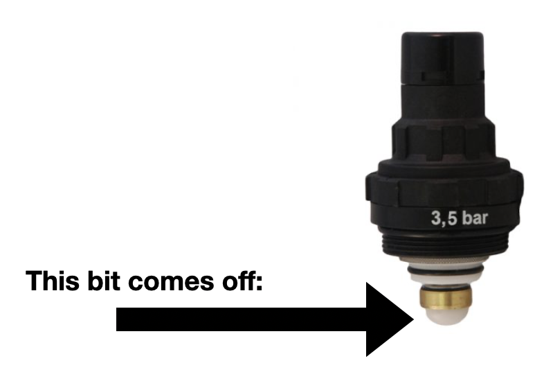

I have a Centrestore unvented cylinder. Every now and again, the water pressure and flow rate at the taps drops right off.
I read the trouble shooting in the user manual and followed instructions to clean the filter in the pressure reducing valve. Each time I remove pressure reducing valve cartridge, the filter appears clear, but the small plastic half-sphere on the end of the cartridge is not attached to the cartridge.
Reseating the half-sphere and refitting the cartridge solves the problem and pressure is back to normal.
I'm assuming the issue is this half-sphere detaching itself from the cartridge and blocking the outlet pipe of the valve body. Is this correct? Am I right to believe that the half-sphere should be attached to the cartridge at all times.
Could I glue it in place to stop it from coming off again?

You shouldn't be working on this at all - it's a controlled service and only suitably qualified people with the relevant G3 qualification are permitted to work on unvented cylinders

The risk is that the cartridge could be damaged and not function correctly. A professional would have the necessary pressure testing equipment to ensure that it was still functioning after the service. As yours appears to be broken, it would be a good idea to have it replaced
Need to be careful when it comes to unvented HW. There is really only one area of an unvented system that a user can safely perform and that's usually only if the cylinder has an internal expansion bubble and needs regenerated. Everything else needs specific quals to do.

The Pressure Reducing Valve is part of the combination valve which is part of one of the key safety features of the system.
The strainer section, on the same page (Pg 13) is part of the maintenance section and it states on the previous page that the maintenance (strainer cleaning, safety valve checks, Expansion vessel checking) must be performed by a competent person. Competent in this case means qualified I'm afraid.
