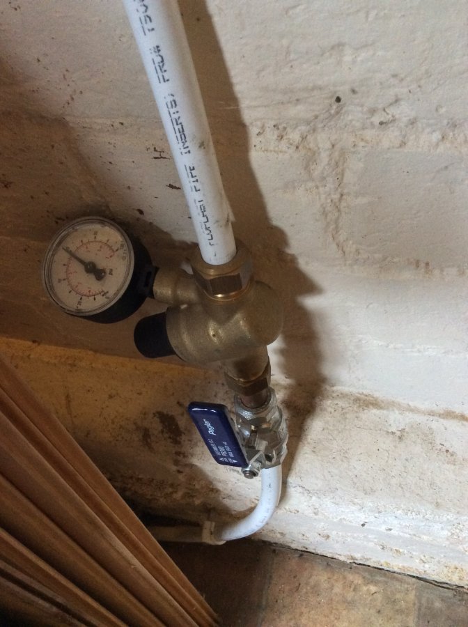

Do You have any idea if that PRV could be faced downwards? I was thinking to add few compression elbows and fit it horizontal but a bit worried about to many turns will make to much noise in pipes? I'm DIY user and don't much experience . Are these PRV loud in operation? The pipes seen on photo are in my Living room.
If you put the olives in the connections and hand tighten the nuts just to hold them Screwfix will be none the wiser. I have no idea why it should be installed as the instructions say,
This is ours, our pressure is 9 bar, keep blowing water softners.
This a new main I run because the stop cock is now under the bath.
I have no idea either why they are asking you to fit any particular way up.
Nor do I remember ever reading that instruction on any that I have bought!
Tony

Its always good practise to install the valve the correct way. Horizontal or vertical.
Modify the pipe work and keep the valve.
I'd fit it horizontal if space permits.
I think i will do like that. Thank You for all help.
