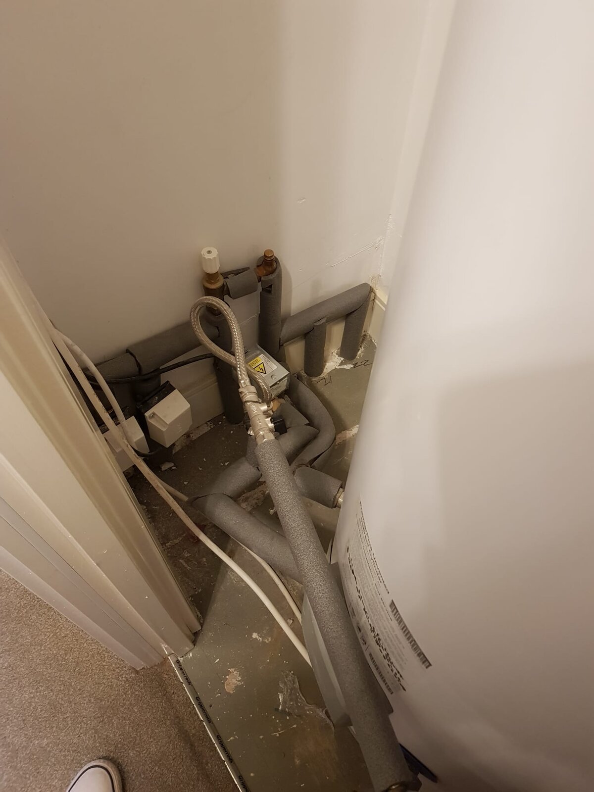

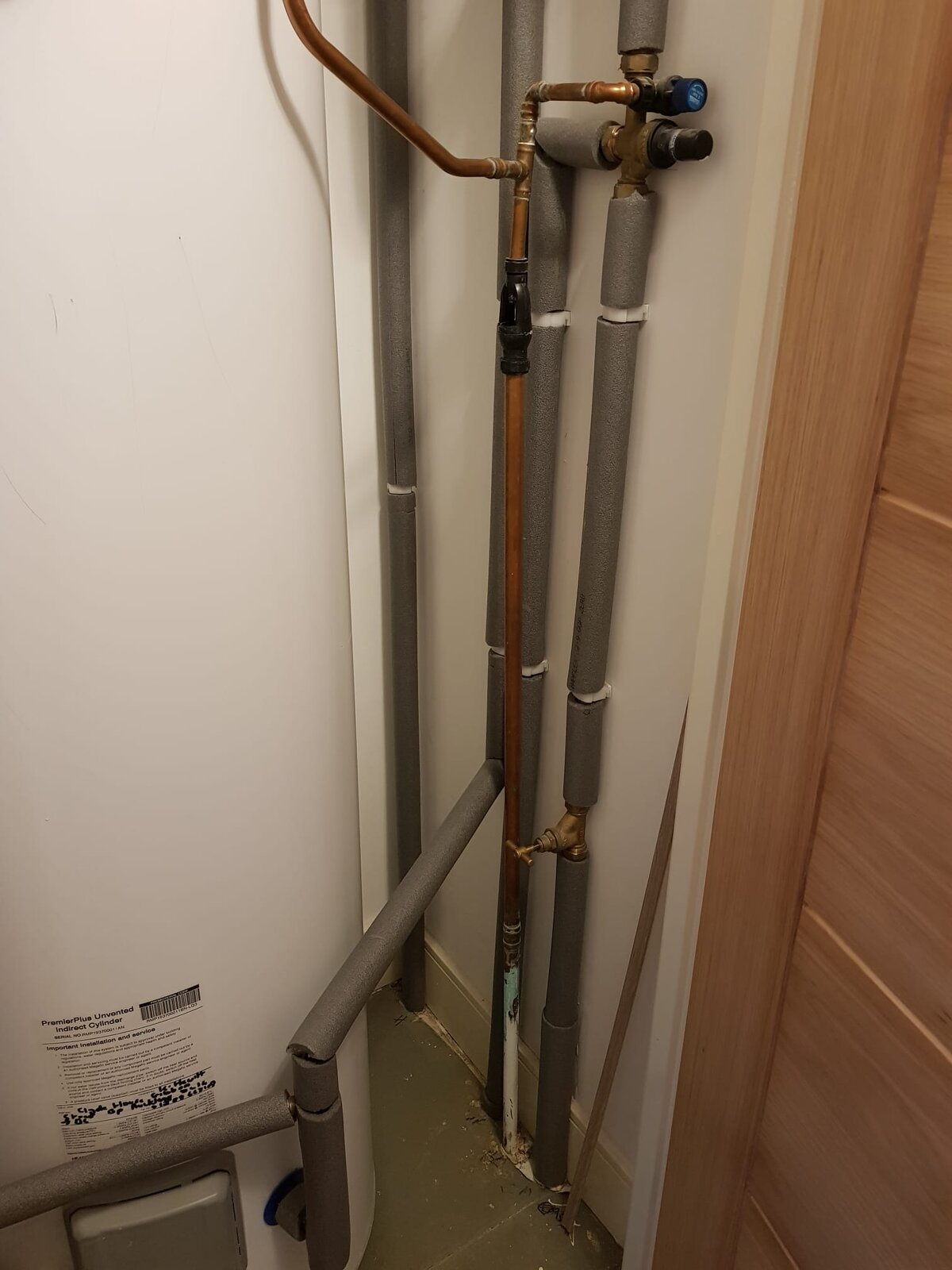

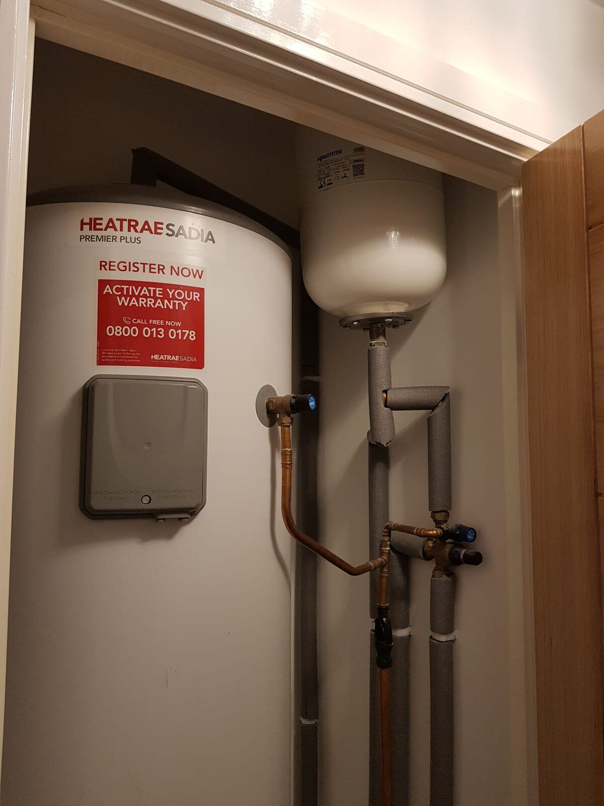

Ive attached a few pictures showing the water circuit around the tank.

The reason the water is running out of the cup is because the inlet pipework isn't straight, it's putting strain on the top of the tundish and bending it (it's only plastic) so the end of the pipe is pointing outwards, just lazy workmanship, ask them to sort it when they're in.
under normal conditions there should be no water running in the tundish, you have a fault, tell them to get it sorted
