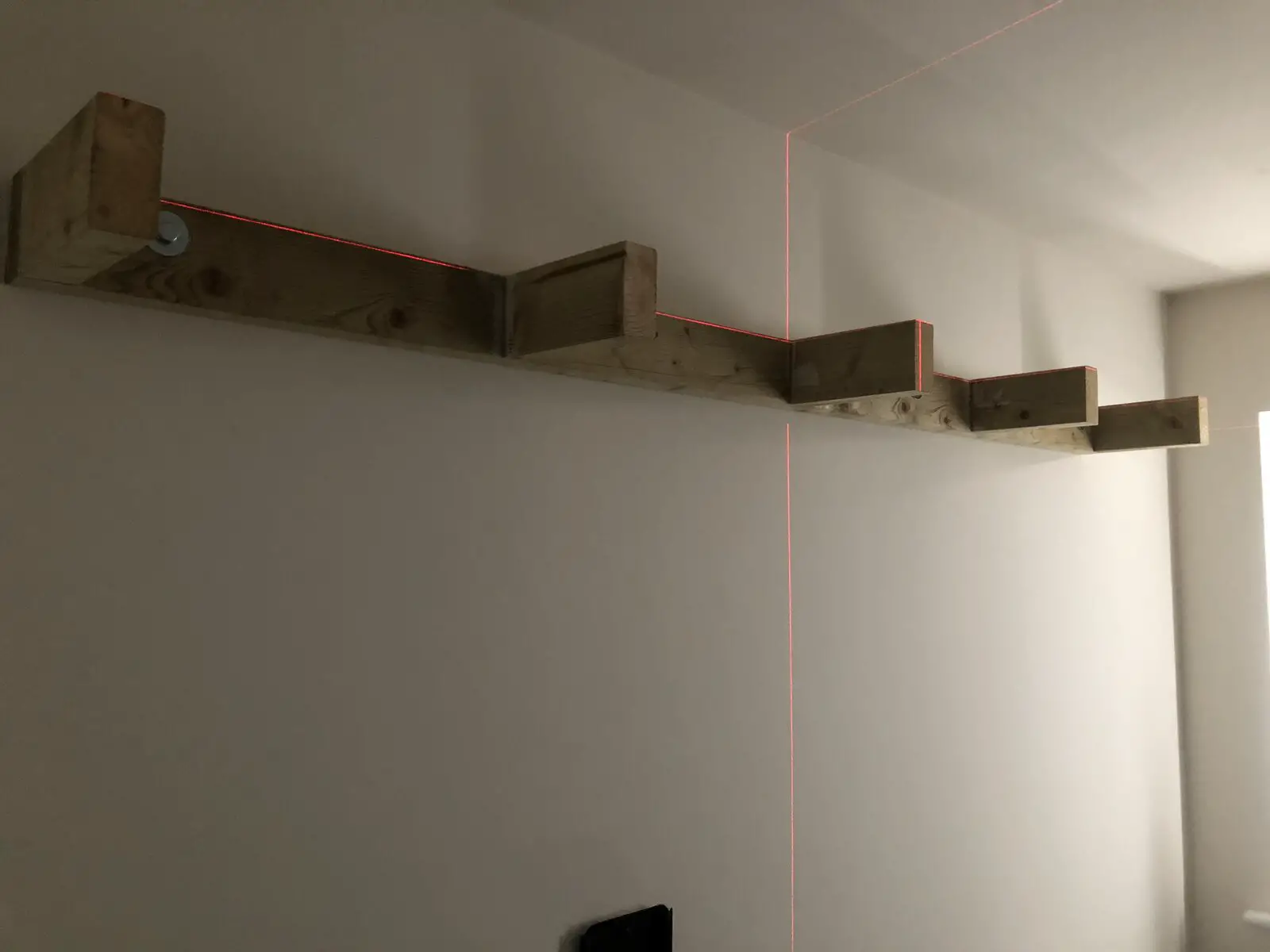

I am wondering if there is any danger to having pressure-treated wood indoors in my home.

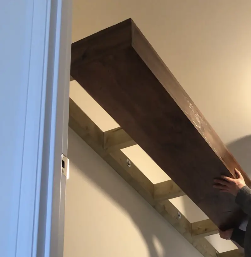

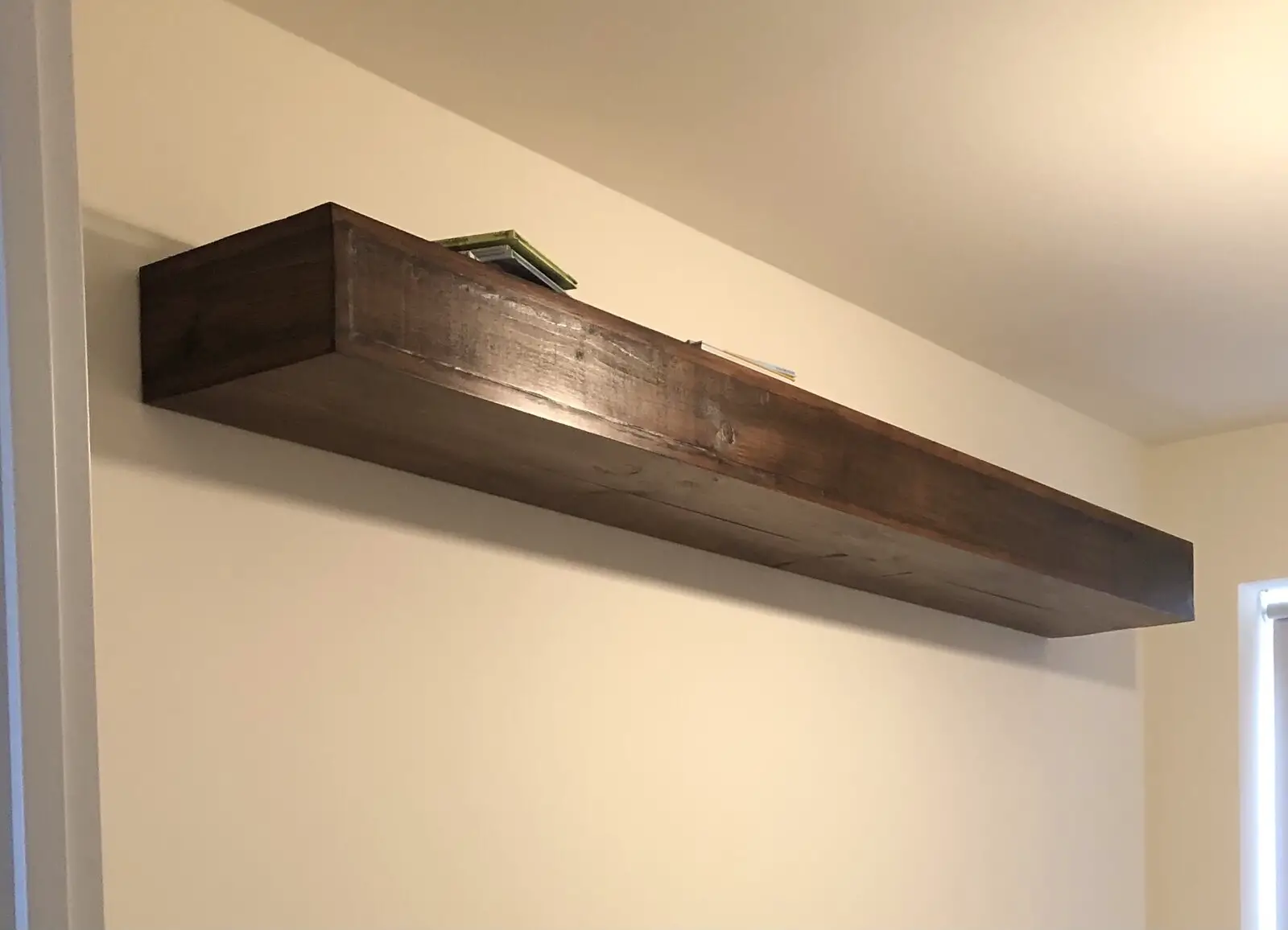

I built a floating shelf with three different types of wood (see pics):
- the skeleton frame to hold the shelf that gets mounted on the wall was from C16/24 pressure-treated 2x4s
- the top and bottom of the box/shelf itself was of regular non-treated wood for indoor use
- the front and sides of the box/shelf was made from a fence board/slat, which I assume is treated
You can see the outer box goes over the inner 2x4 frame and the outerwood was all stained with an indoor-type stain.
I remember reading that pressure-treated wood is not dangerous if you are not using it for cutting boards or food surfaces, but I have also read some conflicting things and am wondering if I need to re-do this shelf in a safer way.
Is there any danger to this in terms of air quality?

Just make sure the timber is completely dry before installing. Minimise all dust from the timber when drilling, cutting and the like. Apply a primer coat all over the timber before finally fixing in place.
If you are using where food is stored then at least 2 coats of top coat (gloss) before using - possibly use a lining paper or oil cloth as well on upper surfaces.
Thanks for your response. I've actually already built this shelf, 2.5 years ago, actually.
I remember checking then and finding the 'cutting boards' and food thing and thinking it was okay, but was just getting worried recently again really wanting to make sure this was okay or if I need to change it out now.
The inner timber has no coat of anything. I just used stain on the outer wood box/shelf.
