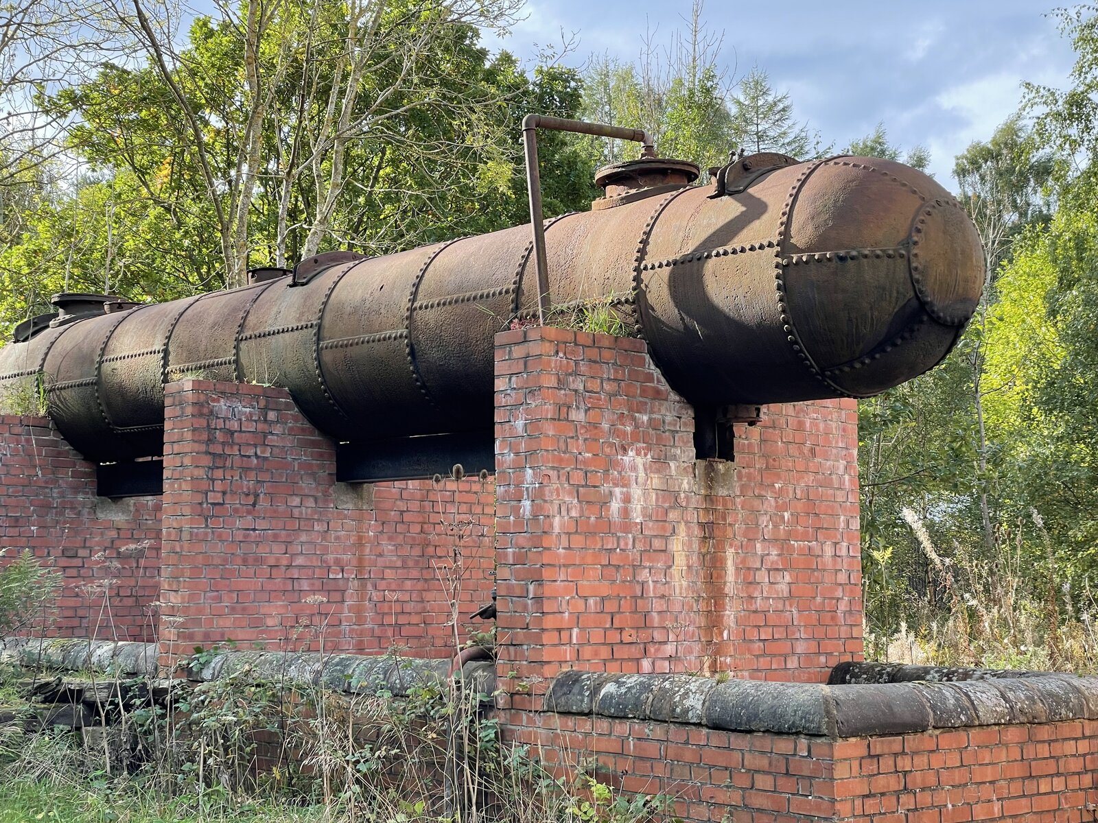

Because heat source (fire) can cause water to boil over, safety precautions need to be in place. Failing to observe these could be hazardous.
With gas or electric, when desired temperature reached, fuel source is disconnected. Not easy for log or coal etc.
This boiler is at Beamish Museum. Basically has fire underneath. Told was not unknown for these to go pop
