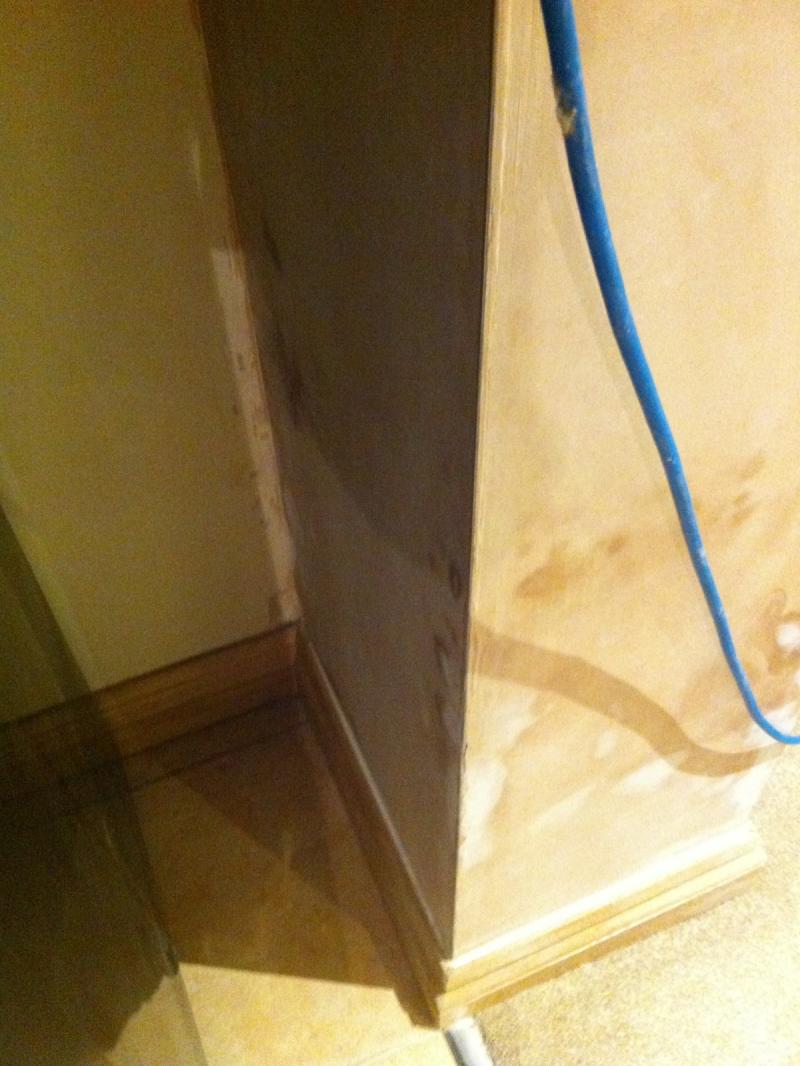

Evening all, first post on here but have admired from afar for a while.
I've just had a small piece of internal wall plastered but now have what I presume is rising damp showing through, salt build up, etc. (Will attempt to upload a photo in due course).
People's thoughts are welcomed on a) diagnosis and b) cure.
The wall is internal, was originally the outside wall I believe, until an extension was put on the end before my time here. House is terraced and behind the wall is next door. Both walls to the sides are fine and don't seem to be showing any signs of damp.
http://image_url/223839/85251_51218911.jpg[/img]
Not sure how to upload pics direct to forum post, but hopefully you can see them in my profile

Evening Burnerman, have tried but failed to upload pic direct to this thread. Are they not showing in the albums on my profile?
The floor on both sides of the wall (will make sense when see the pic) is concrete on top of a plastic dpc.
Alas, pics denied to me!
No matter.....was the concrete laid after the house was built? What I'm getting at, if the dpc on the original (outside) wall was compromised for some reason, and then concrete was laid after that, dampness can still rise through the original wall.
What I have seen done in situations like this, was to remove the skirtings and then drill downwards into the wall, prior to injecting a chemical damp course. I can't see what else is possible, really!

Whaley, picture should now be there (albeit on a sqew!). Thanks for the tips foxhole
Hell, that's nasty!

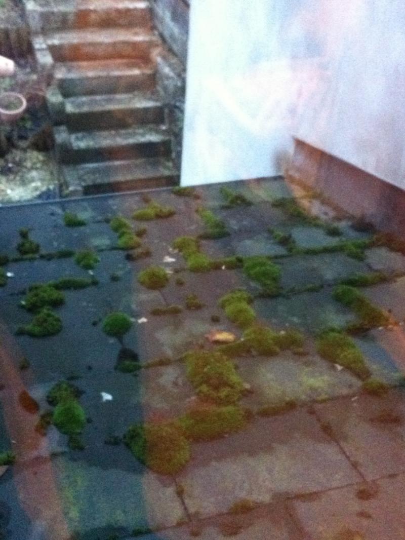

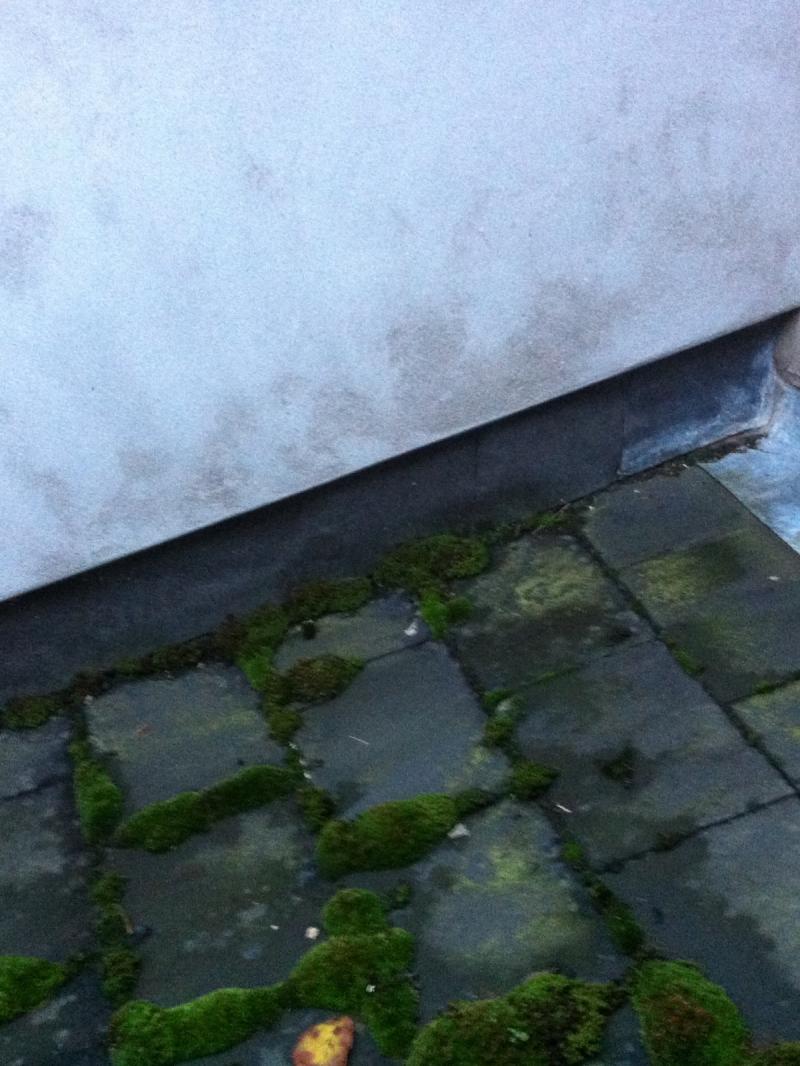

What's the condition of the outside wall, where the extension joins......any gaps, failed pointing and so on?
Is there a pillar opposite with the same issues?
There's no central heating pipe in that vicinity, is there?
John :)
There is no 'outside' as such as is a terraced house, so behind that wall is next door, if that makes sense?! Can't see any gaps anywhere outside, all flashings, slates, gutters etc all look sound. Walls opposite and indeed right next to are fine, also no central heating pipes anywhere near it

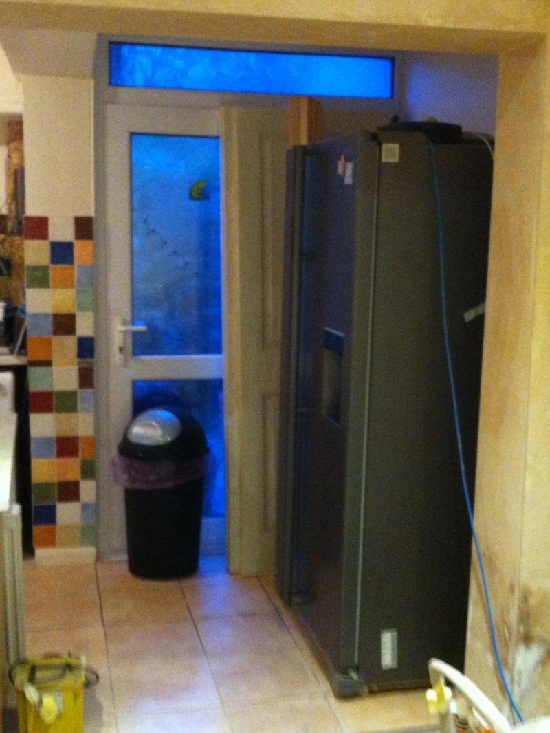

Can't make it out by photos but is thar really a wall or is it a section of boxing in that conceals pipes etc?
If it is something in there might be leaking.
Burnerman - thanks for your thoughts, pretty much same conclusion that I came to.
AlanE - yep is def a brick wall and not stud or boxing. Is a steel tht rests on it where the extension has been installed.
I will try and take some more pics later when get home.
Could do with pics externally where the extension ties into original building at roof level, my guess is no cavity tray was used .
