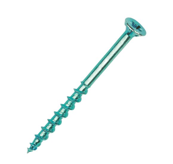

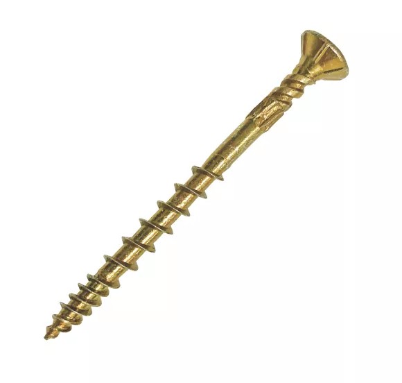

or alternatively a screw with a short section of reverse thread just below the screw head like these Screw-Tite screws:
(Please note - there are other brands available, these are just used for illustration purposes)

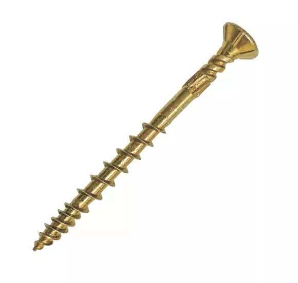

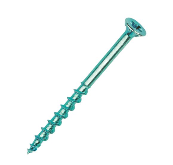

I've seen those kinds of SPAX screws before, would have definitely used them, but 20 quid for a box when I'd use a handful of them is probably stupid. Maybe if I was doing a whole room.
The 'decking screws' I mentioned are basically like the first ones you linked, unthreaded shank at the top, so clamped the wood down good nice and tight. Just hoping the compressibility of chipboard over time doesn't work itself loose from that, if you know what I mean? I saw a few people when looking through threads mention that. I don't know if that's just a theory or if it happens in reality.
£20? Try more like £11 - and that's Toolstation (OK, those are Reisser R2s, but they are a similar quality and price to Spaxes and they are the right size, 4.5 x 50mm). If you want a solution and you can't work with chipboard screws, that's how you do it. Lamming in girt great decking screw or the like makes no difference once you've got the first 20mm or so of thread into the joist. I have come across people selling those screws on a local market at 10p a screw as well (or £10/100 - about twice the price of the boxed screws I buy - Toolfix aren't the cheapest source by any means). Better to learn how to work with cheap screws IMHO
