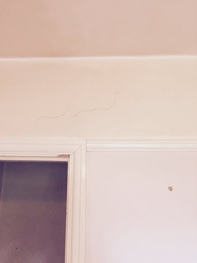

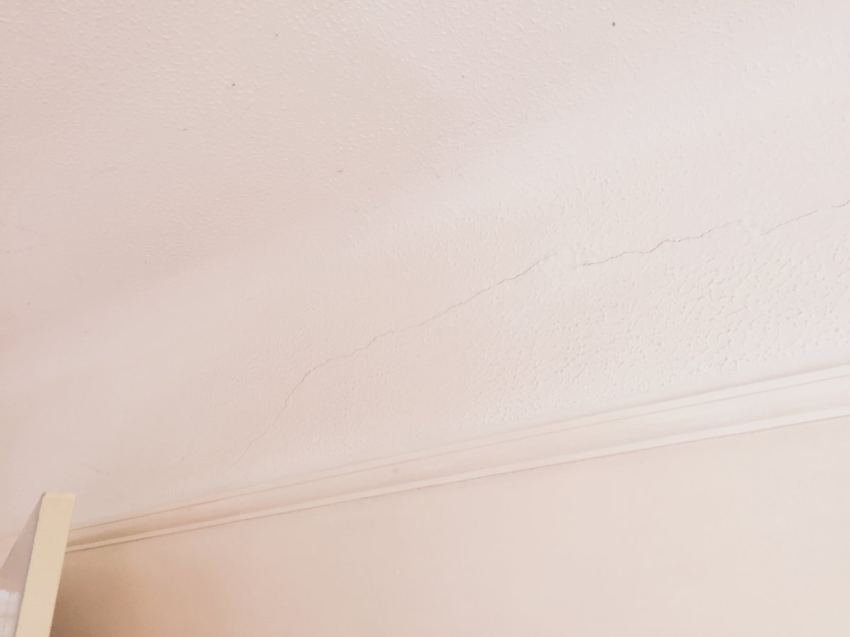

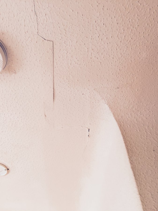

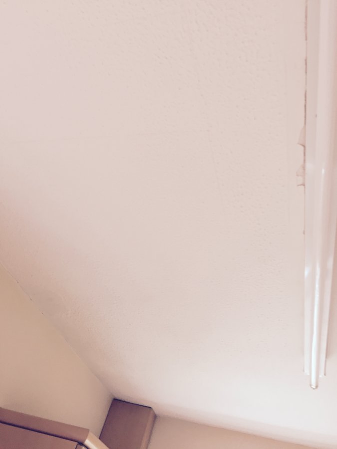

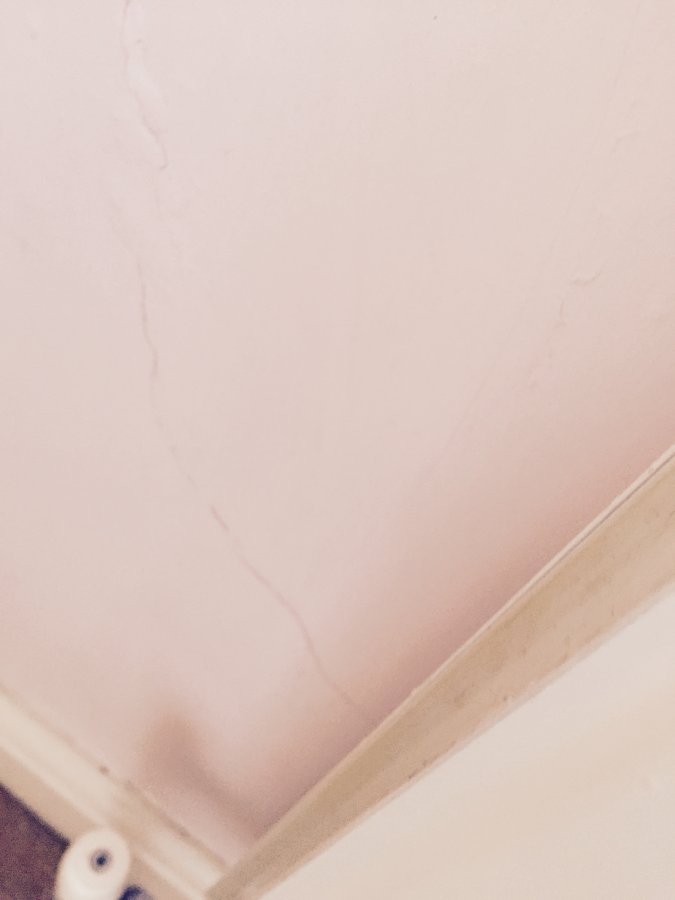

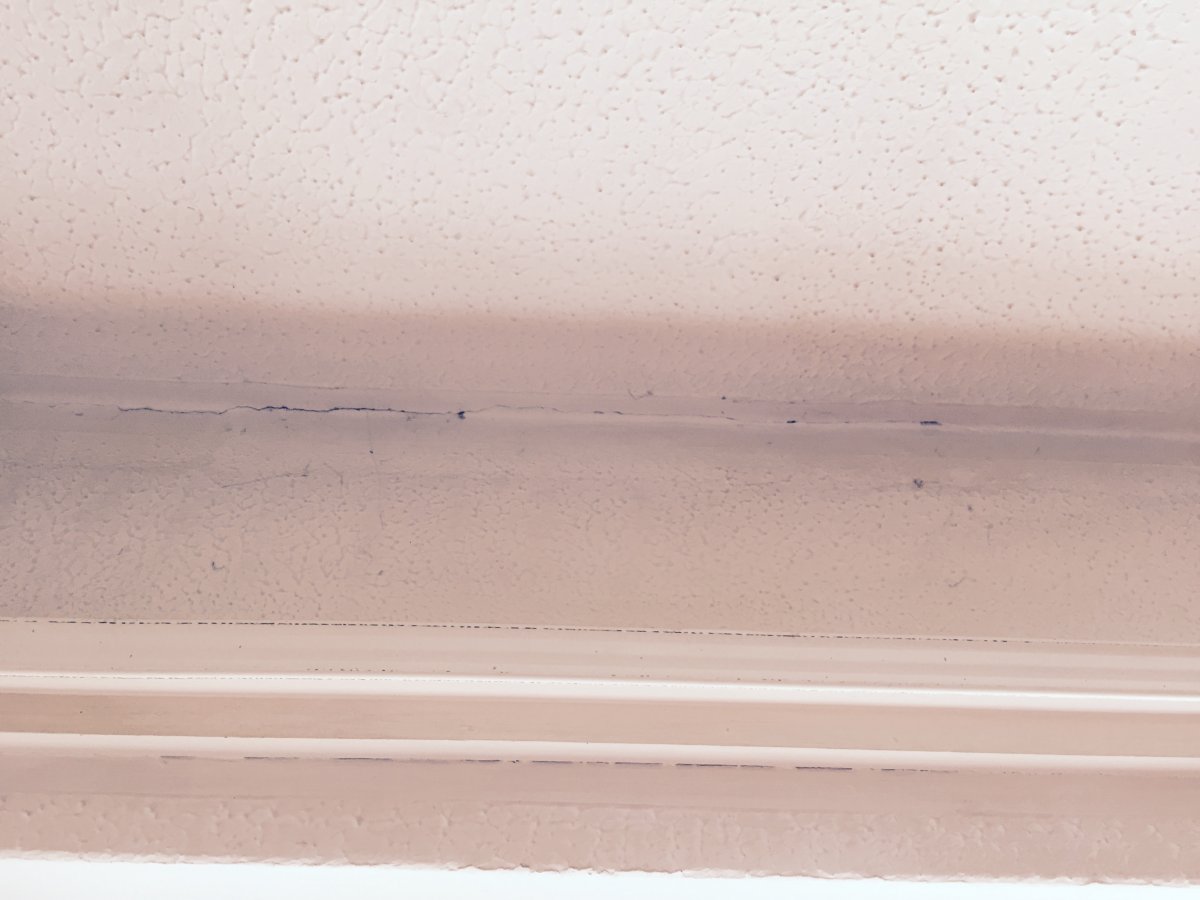

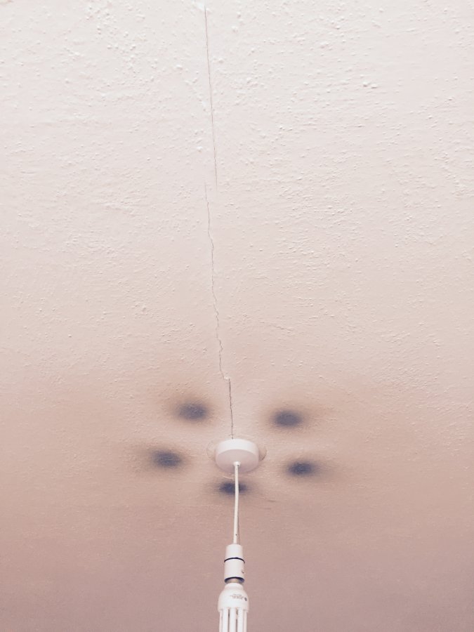

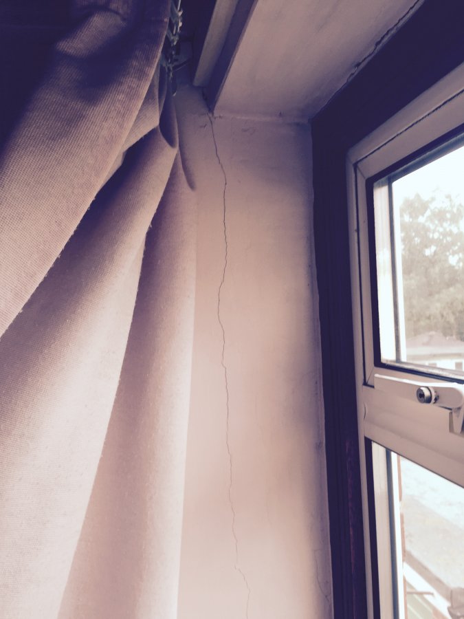

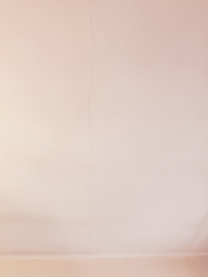

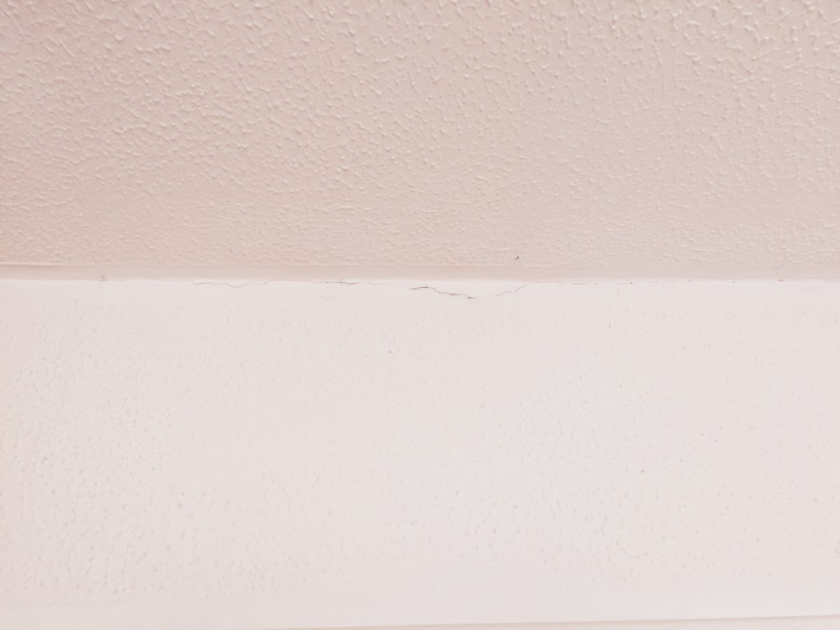

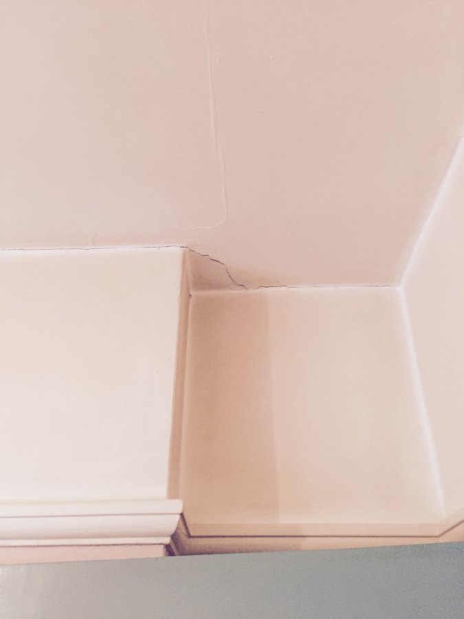

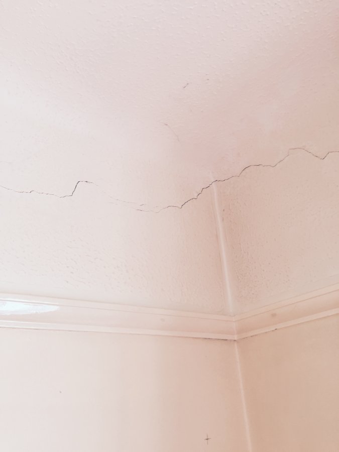

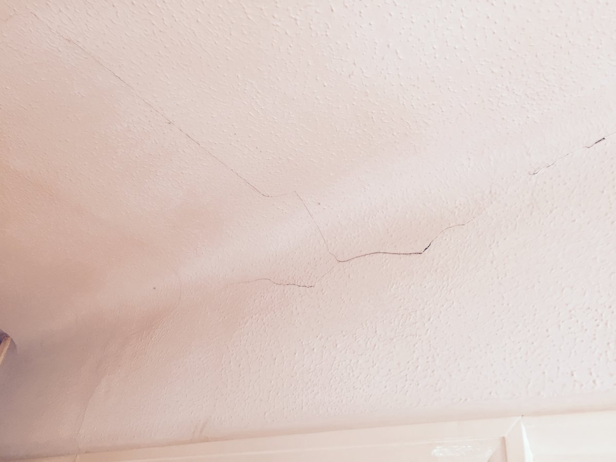

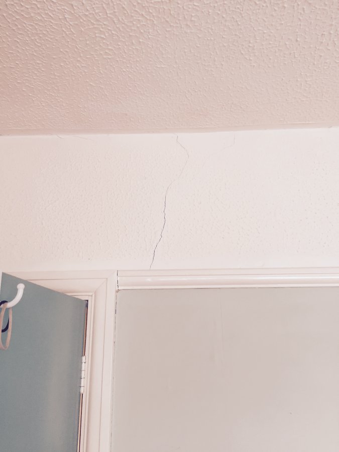

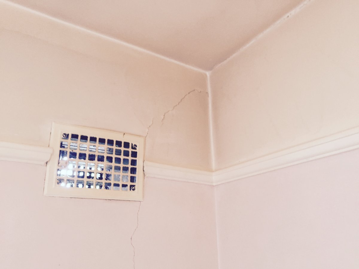

I visited the property and here are few pics of cracks....
Property was empty for 3 to 4 months.

Looking at the decor (painted woodchip paper), .5mm cracks have opened up in 35 years (1980 till now), so in 35 years time they could be 1mm wide. How long do you think you will be living in this house?

You can't assess cracks by looking just at the cracks themselves. You need to know the structural form and materials the house is built from, local ground conditions, external influences, etc, etc. At a guess I'd say those cracks are harmless but to be sure you need a full assessment and report. As above the cost of the report can normally be recovered by negotiating the purchase price against repairs needed but it also gives you insurance if they turn into something nasty later.
They do seem indicative of thermal movement over time ie common and not structural.
