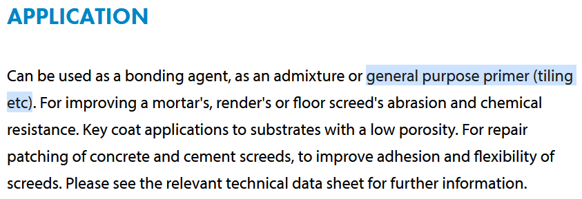

Priming with Bond It SBR
If you use tilers sealer then no question about it.
I think tilers sealer is either SBR or similar family of sealers but using correct one won't cause problems.
I don't think it will cause problems but a unknown and not lab tested.
Small tilers sealer is cheap from DIY so why not buy some
Cheers, no issue spending extra but heard SBR is standard for sealing before tiling, website mentions it here below but was confused about mix ratio with water - bottle says 1:1 for general priming, online sources saying 1:4 for more watery mix to sink into wall. No worries though as just called Bond It and they say 1:3 should be good!
Thought Bond It were known and established?
Acrylic sealer on walls. Sbr on back of porcelain or stone. I also mix my sbr with dry cement
