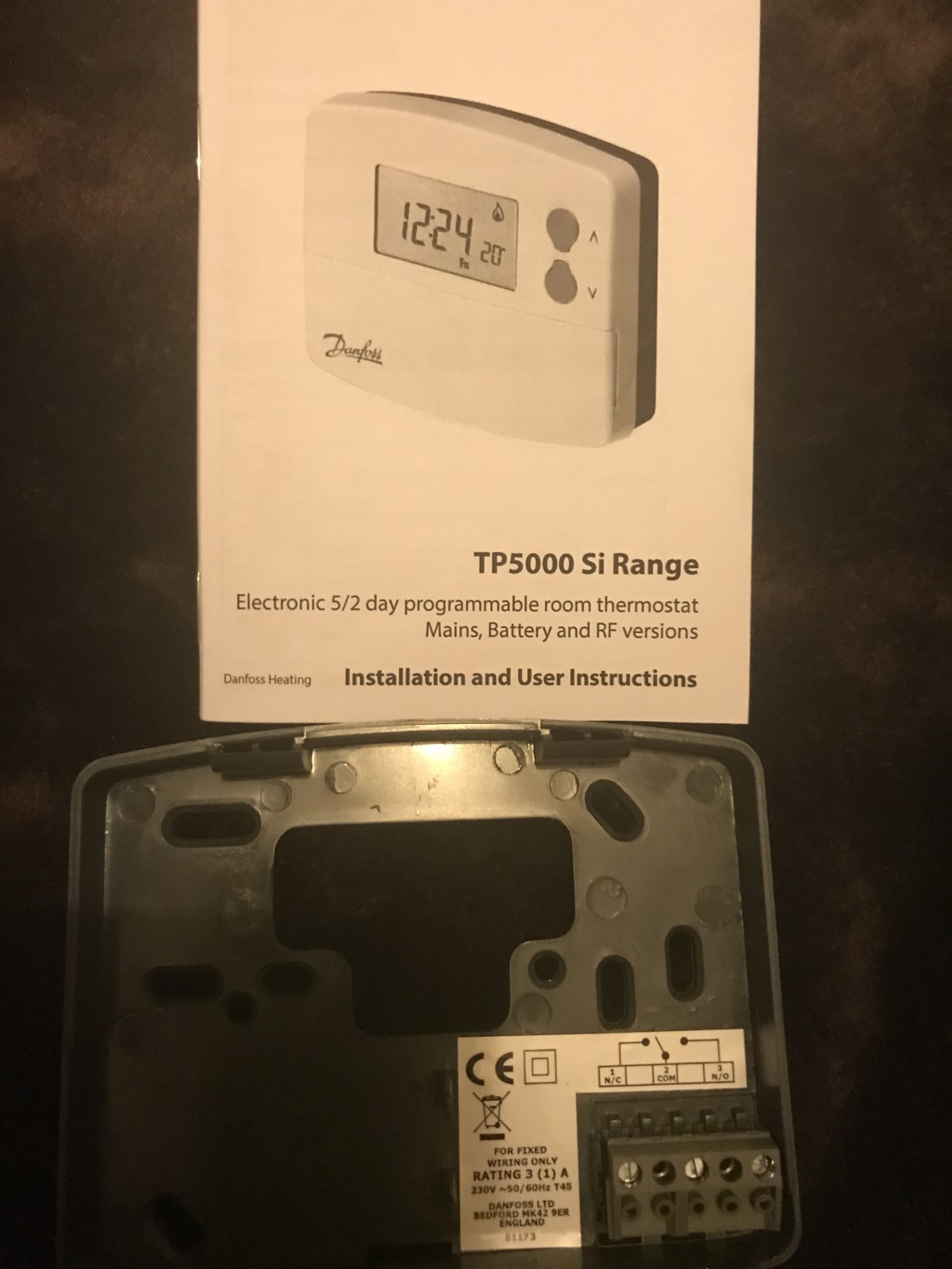

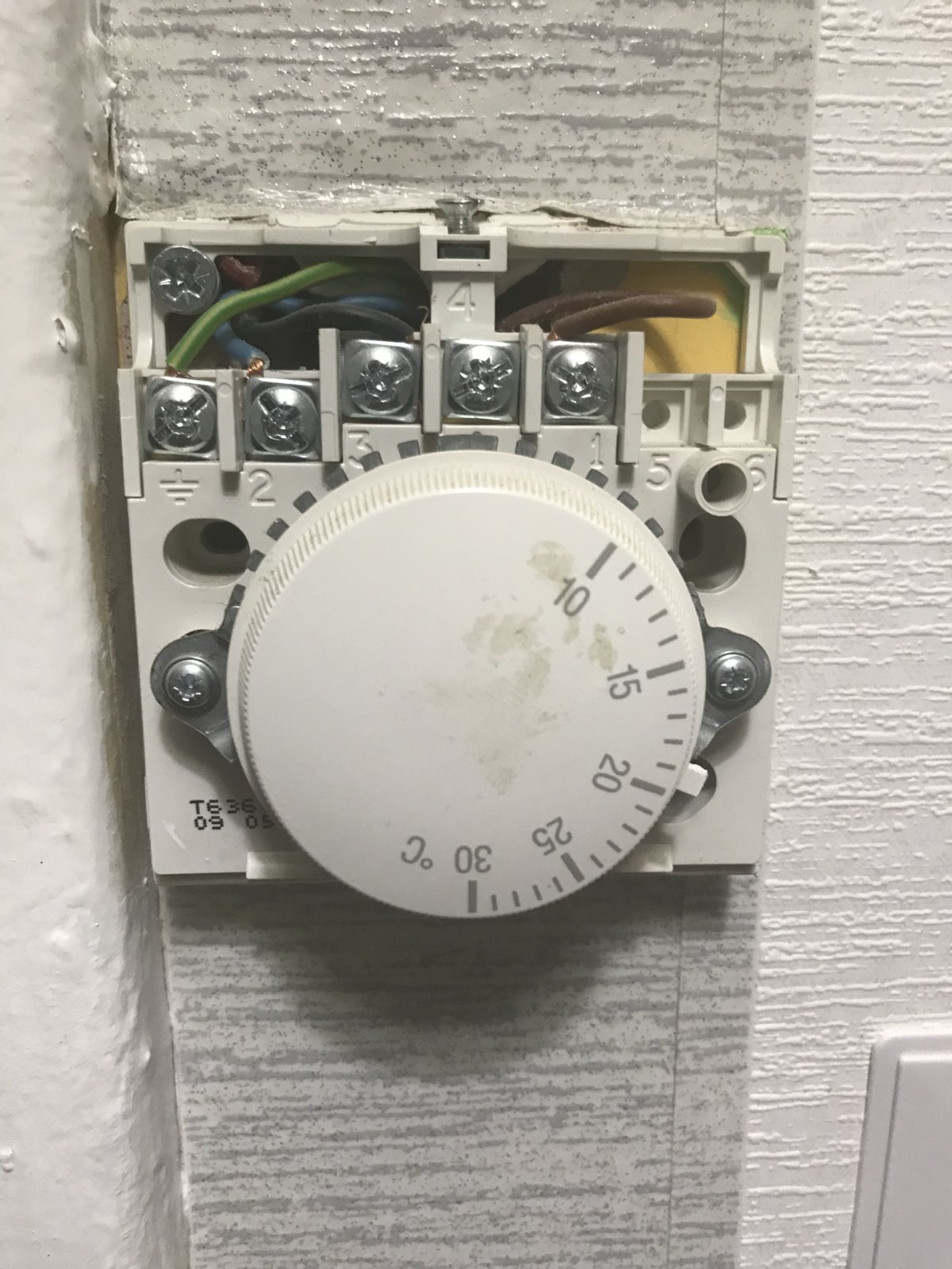

Hello,
Apologies first if this has already been asked but I couldn't find the answer or help I was looking for
my old thermostat has 4 cables, green yellow, blue, black and brown and the new thermostat has 3 inputs, 1 n / c, 2 com, 3 n / o and I do not know how to connect the new thermostat if you can help me please
Old thermostat:
terminal 1 Live (brown)
terminal 2 neutral (blue)
terminal 3 switched live (black)
Earth (green / yellow)
New thermostat:
terminal 2 Live (brown)
terminal 3 switched live marked 'NO' (black)
Do not make any connection to terminal 1
The remaining blue wire is not required and so should be isolated / insulated separately, and tucked safely out of the way
The remaining green / yellow wire is not required and so should be isolated / insulated separately, and tucked safely out of the way
