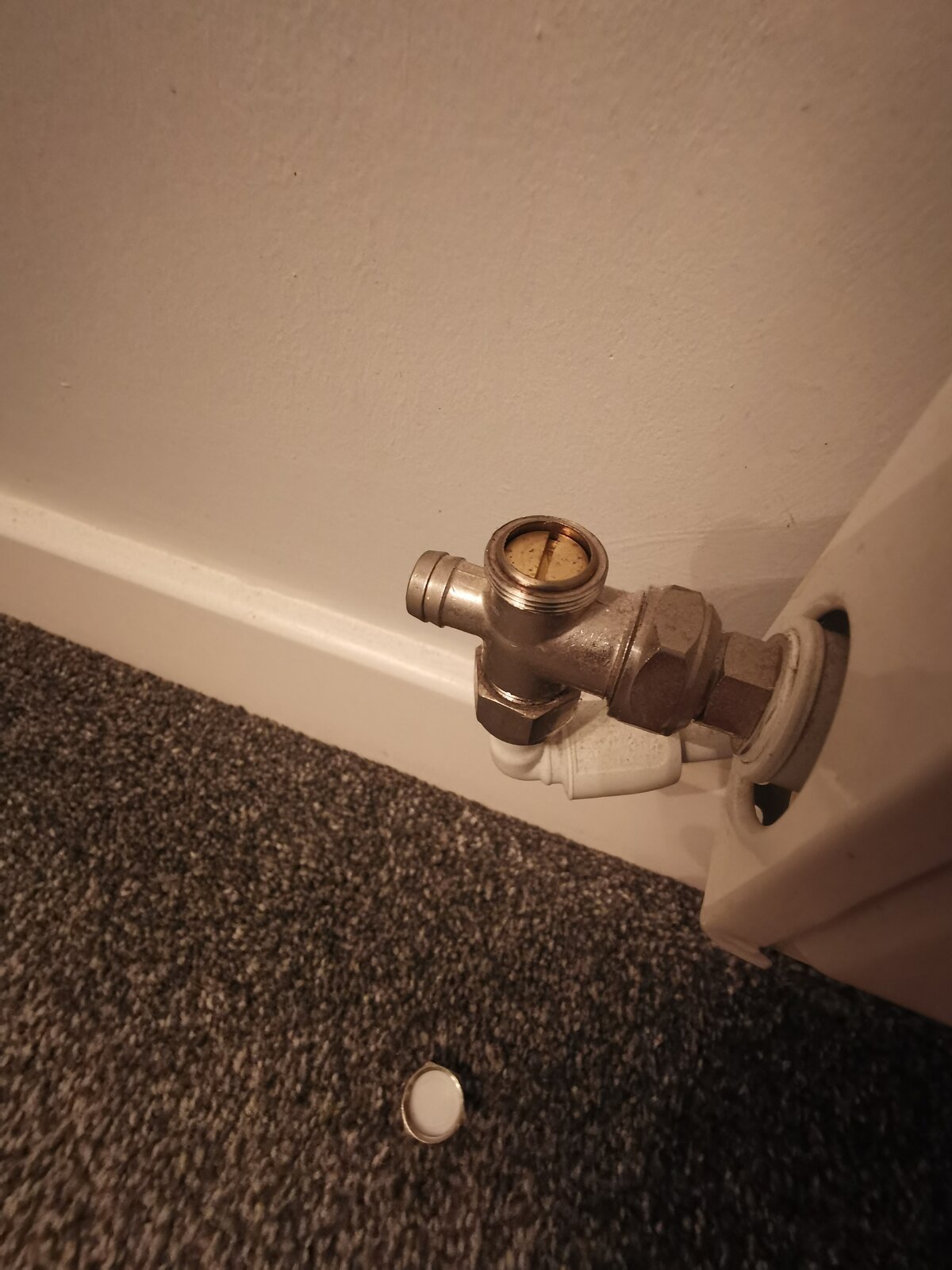

Over the weekend we had a plumber come round and take off the small radiator from our ensuite and fit a towel radiator.
I'm abit unsure as he never put the heating on to test etc so when he went we switched the heating on to make sure all was ok.
We've noticed that the small radiator opposite the cylinder is no longer coming on.
I've gone round and bleed the radiators and water is coming out apart from the new towel radiator which hissed for a few seconds then water.
Any ideas? My friend said the plumber should have drained the system? Or might have caused an airlock?
Any advice please?
Any advice please?

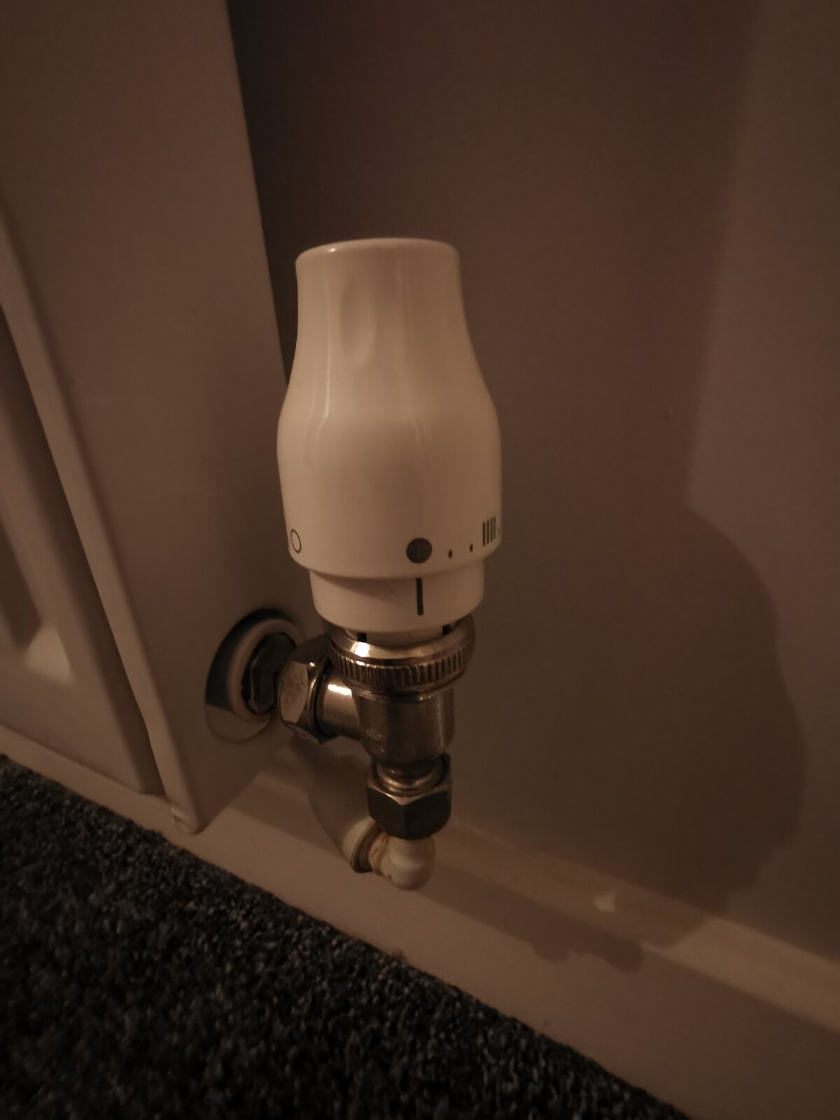

Will try again in morning we did shut all the radiators off but we had the heating on prior for about 15 mins, we left the 1 radiator open but it didn't heat up.
I've tried bleeding it but it's just water that comes out.

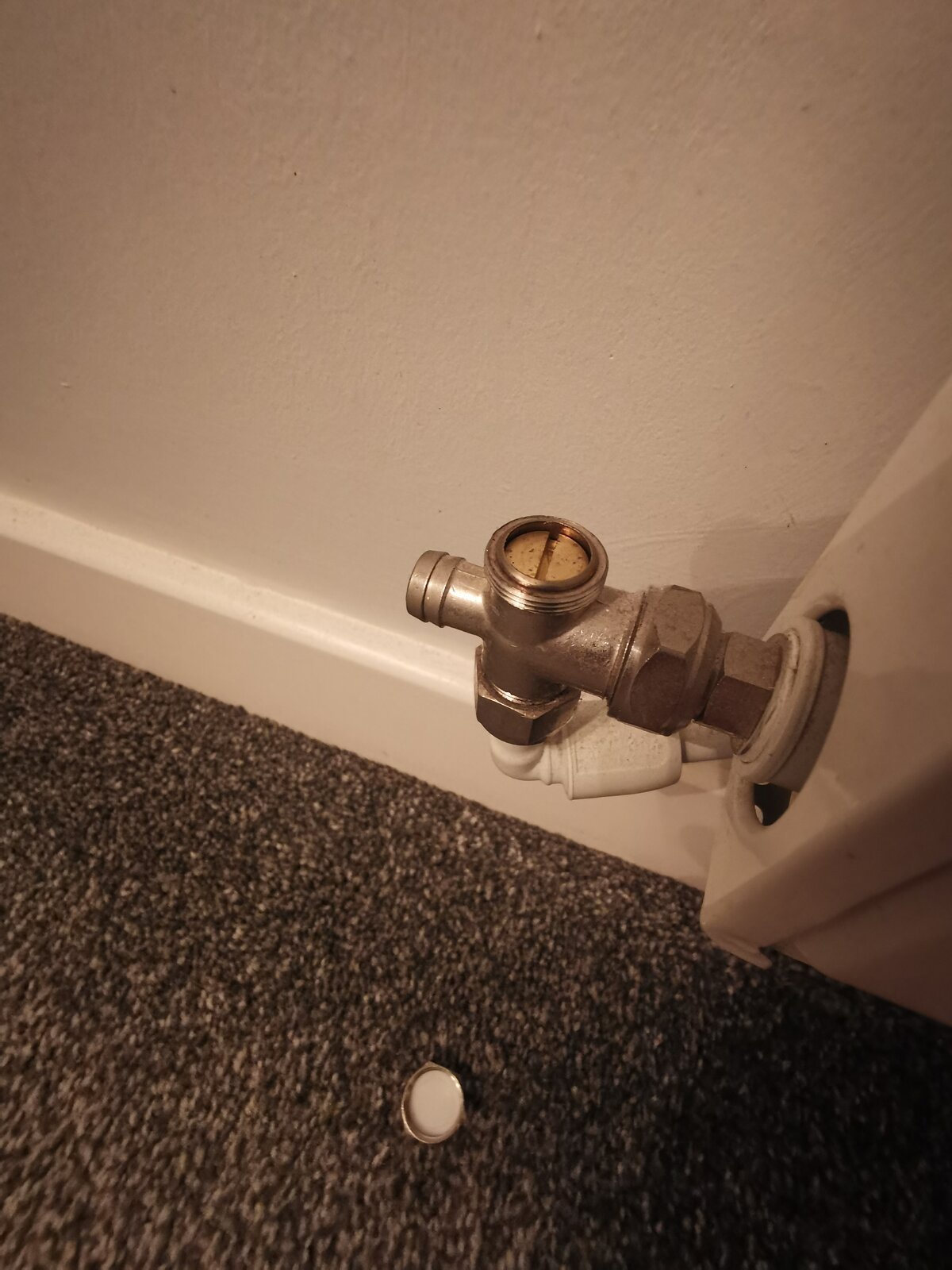

The lockshield valve is probably closed, should be fairly simple to open it up with an adjustable wrench or even the plastic valve cap, provided the valve cap is not spinning freely
Are both valves open?
Andy
On the radiator? The one on the right is open hopefully, not sure what the thing on the left is?
Is this the lockshield valve? Does it get stuck off sometimes?

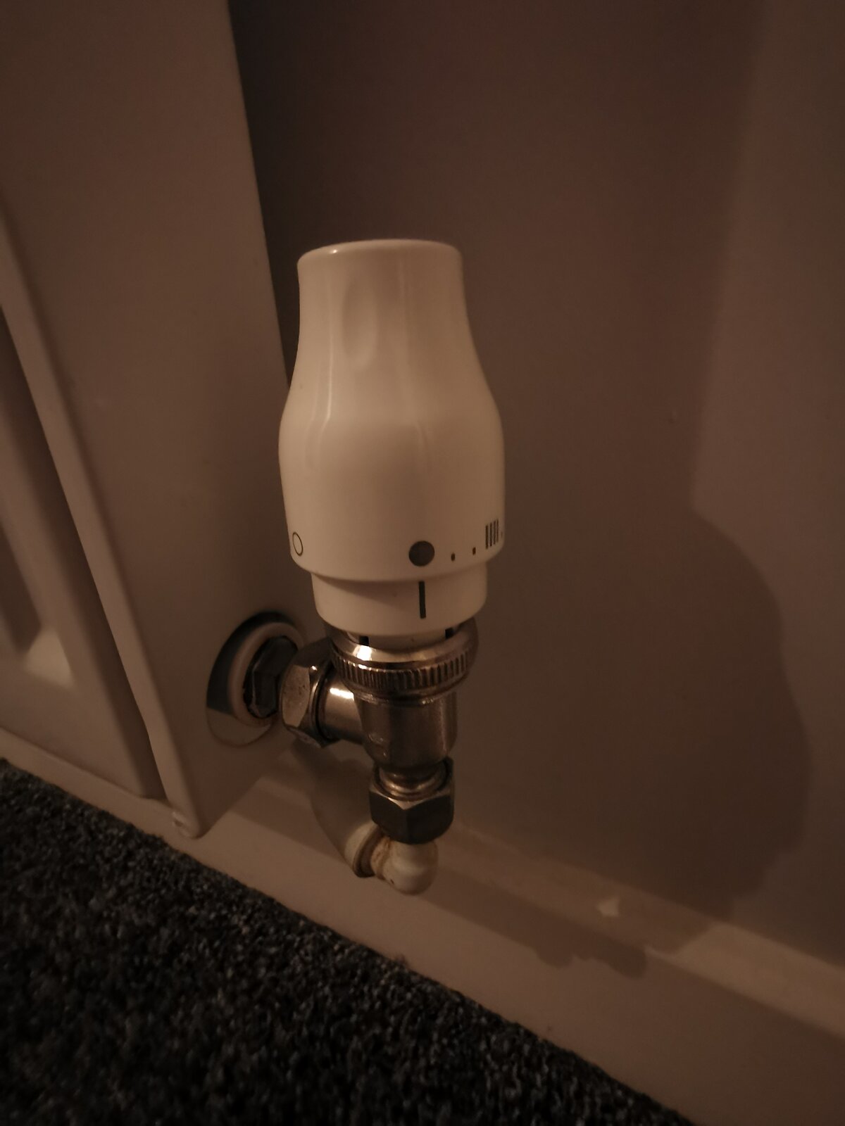

The TRV might be stuck. Could be worthwhile taking off the TRV head and tap the metal valve.
If this radiator has been working previously, then you should not need to adjust the lockshield valve
Thanks will give this ago in the morning. We've got the plumber coming back anyway as the new towel radiator has a slow drip
That was the problem thank you the pin seemed to be stuck down.
