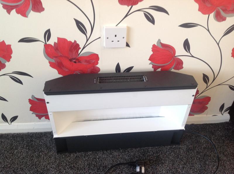

I have bought a Midnight-Black-Glass-Frame-Wall-Hung-Electric-Fire
http://www.diy.com/nav/rooms/fires-...ll-Hung-Electric-Fire-11287507?skuId=11798213
I want to place the fire where the old electric council electric fire was taken away and not replaced so thought I could buy my own and just fit it to the wall.

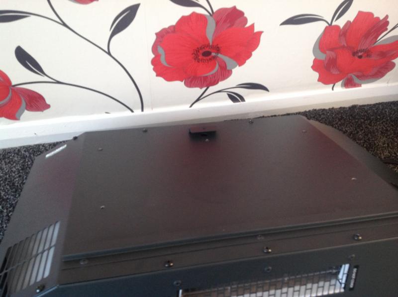

Problem is the plug what I was hoping to use will not fit behind the fire and even worse than that the fire won't even go onto the wall without hitting the plug socket itself!
What can I do? is it possible to take the socket off then cut the plug off the fire splice the wires and then put the fire to the wall or maybe even take the socket off and blank it to just use the plug as intended thats round the corner.
Does the new fire have to go dead centre of the socket in the picture?
I'm guessing it does, hence your post, so it's central of a wall or chimney breast.
If so, can the fire go above the socket, or is that going to be too high?
Is that socket controlled by a switch somewhere nearby?
If so, have a look inside to see which way the cable goes.
If it goes horizontally, you may be able to get the socket behind the recessed part of the fire. EDIT - not much of a recess is there?

More pictures required of exactly what you have.
Yes the fire is too high above the socket and below and is on a breast which is the only place it can go there is a switch round the corner of the breast which is the fire switch.
I have just phoned an electrician out who will come tomorrow to see if there is anything he can do otherwise I guess the fire will have to go back.
Would screwing a couple of spacers to the wall and hanging the fire fromt that look too ugly?
That could be an option to try thanks not sure the girlfriend would approve. Aesthetics is everything. When you walk into the lounge the first thing you see is the side of that fire :(
In that case there should be at least two ways;
1) Disconnect the wiring at the switch that goes to the socket, then change the switch for a socket, and simply plug in the fire. Make sure all unused, disconnected wiring is made safe, and available for future re-use.
2) Try and move the socket just out of the way of the fire. Any damage would hopefully be behind the fire, and you shouldn't have any unsightly cables showing this way.
